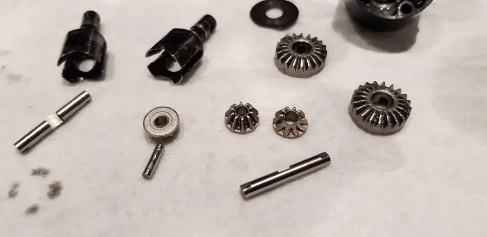

Hi,
is there any trick to prevent rear spider gears from cracking?
My first stock rear diff did break after around 10 packs (gears and casing, propably noticed it to late). I switched to a tekno steel case and complete new internals and after another 10 packs one of the little spider gears broke again in the rear.
I still run the stock stock plastic front case and a m2c aluminium middle case with the frist gear sets from the original kit with no issues so far. Only the rear keeps breaking on me.
Stock f50k/m100k/r100k oil setup.
Could lower oil in the rear help?

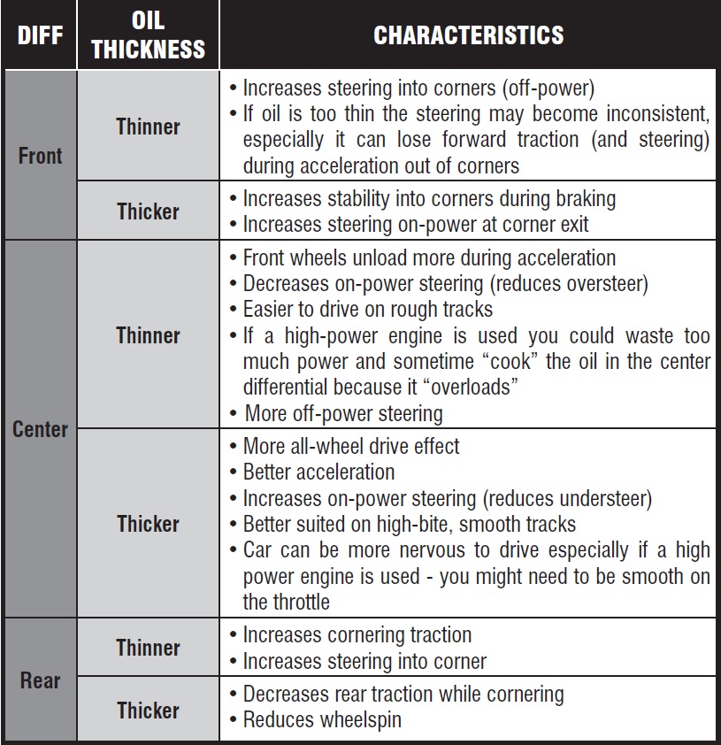

It’s recommended to use thicker fluid with heavier tires or when bashing, correct? Is there a safe max for Tekno on diff fluid for the diffs in general regardless of racing/bashing? Some bashers have diff fluid as high as 500k or even 1-20 million. I’m not sure if their diffs are fundamentally different though.
I can't think of any reason why "bashing" should require thicker fluid, all that will do is take away rear traction and make the car more difficult to drive... as far as stripping planetary gears, I question if you are smashing the throttle all the time, if so then it's just a matter of learning throttle control and softening your acceleration to help prevent stripping gears ;)

It is a wide et.48 chassis with mt410 towers etc.
Max8 Combo 2200kv on 62, 15T pinion. Punch on 3 (5 is max).
The diffs are filled as suggested in manual. Both diffs died on offroad/bashing mainly sand, gras, gravel ground.
Both diffs died while using proline big joe II wheels, i also had some runs with badlands 3.8.
I jump alot 2-3m hight, never trottle on landing, however i am not easy on the gas on acceleration etc.
I will switch to a 1650kv motor and stay on 15/16T pinion. However i guess this will only put more torque on the drive train even if my max speed wil go down.
I wonder why only the rear dies and i have no issues with the center diff running the same oil. Looks like the spider gears cant hold up to heavy wheels.

Last Diff died with Backflip LP 6s wheels, wich are even lighter.
The Diff never leakes, not before nore after breaking.
I did rebuild it now using a fresh set of internals (gears and crosspins) and a never before used Tekno steel case (was my backup if the front plastic would break) - i did always use the same steel case for my last rebuilds. I applied some greese at the gears, filled it with 100k and added some graphite.
If this dies again idk what to do next. This is my 5th rebuild of the rear, i had spiders explode after only one pack run bye now. Tested 100k/50k and 30k oil - didnt notice any diffrence in reliability of the diff.
