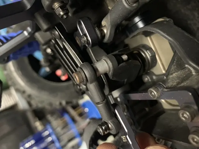

I-have a small problem with my servo to tall.
I have a mt410 and have a savox SW1212SG
It appears to be 6.5 mm to tall can I make the work or do I need to get a new servo

Use a longer bolt and just shim up the linkage you can use whatever works
I have used
-Washers stacked
-A nut
-section of automotive brake line
- Or just anything I can find around the house
