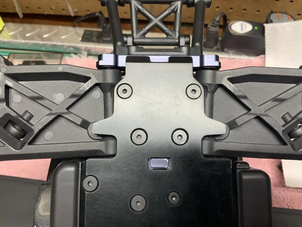

Can someone please measure the total length of the rear “D Block” ?The one that came in my the MT410 kit measure 72mm and I can’t get it to fit the pins because it’s too wide.

That's correct. Get one side on and deflect the arm to get the other side to line up. That's where the rear toe angle comes from.
