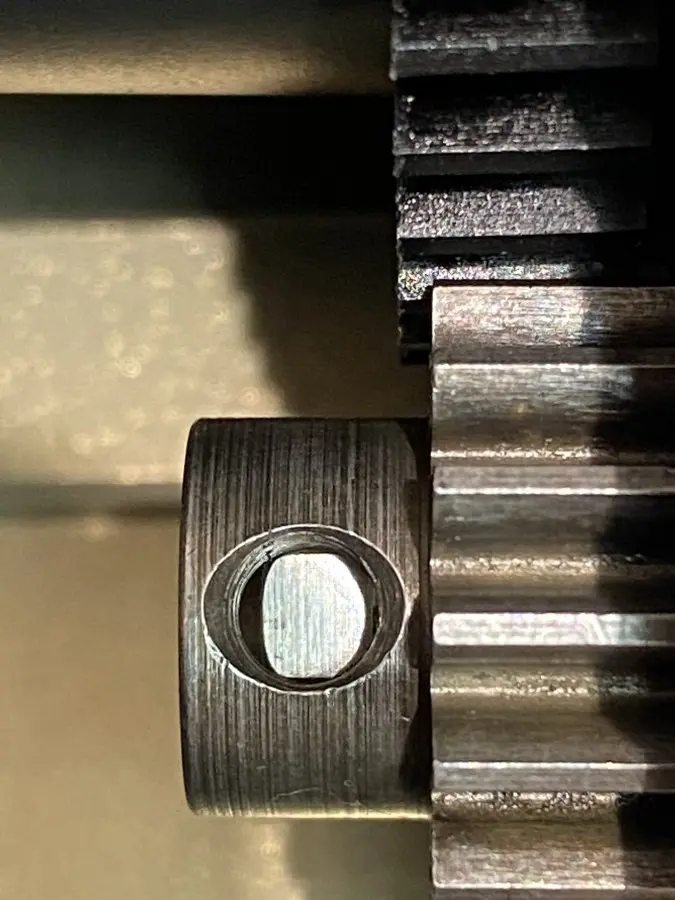

This pinion does not go onto the motor enough for the pinion grub screw to contact the shaft all the way around. Is this normal? Ok?

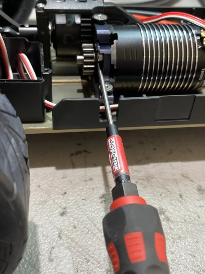

Flip the pinion around so the the grub screw will hit the motor shaft completely.
Thanks. I did not realize the grub screw could be accessed that way. Got it now.
