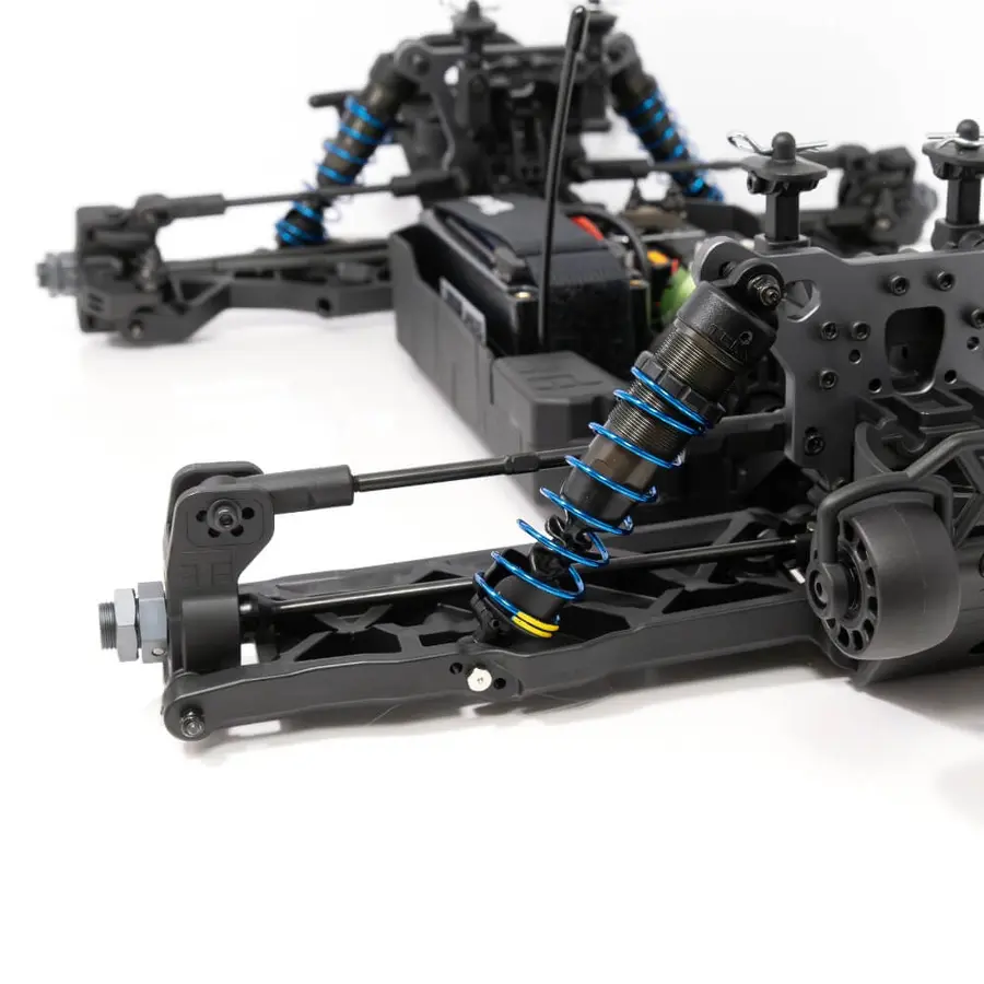

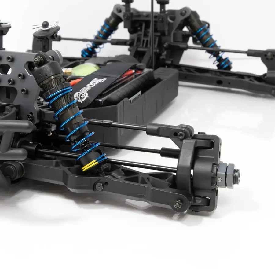

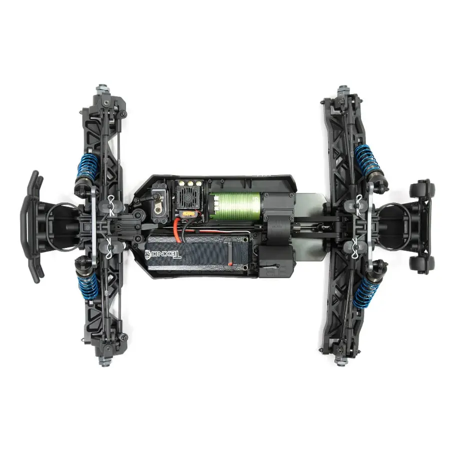

The build has begun on MT #2.
All 3 diff cases are TKR9115C with steel cross pins. I pre-shimmed the front and rear diffs with 8x12x0.2 shims behind the drive side bearings. Drop and go, no fighting with paper thin ring shims.
The shocks have ET48 emulsion caps with M2C pistons. I'm not sure what the dampening difference will be.
The ADU hinge pin retainer won't be here for another week so I'm doing a no stone left unturned assembly job on it.
