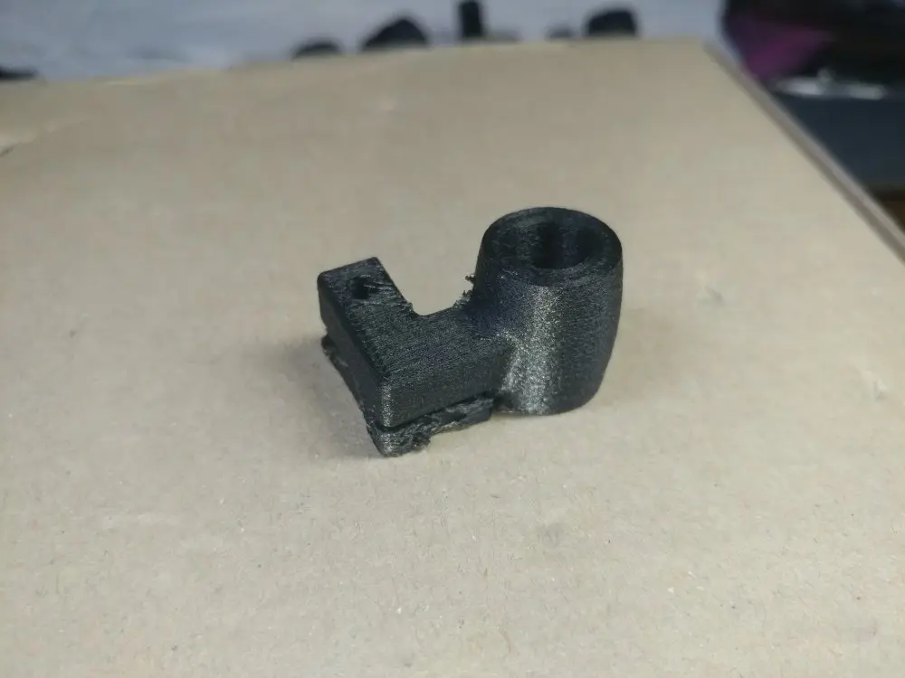

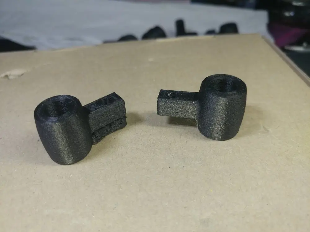

I came up with a design on FreeCAD, and printed them out. Wasn't too challenging as the shapes are fairly basic. I used an ellipsoid mounted, more or less, on a post. I cut the ends off the ellipsoid, and had what I was looking for.
The first examples I printed seemed to be very strong. I'm using Matterhacker NylonX filament, which is nylon infused with carbon fiber. It's what might be called a sticky filament meaning it binds itself together very well. It's not sticky after the print process. That filament required me to increase the bed temperature to 75C and the hotend temperature to 250C. I also bought a new printer nozzle designed for abrasive filament like this.

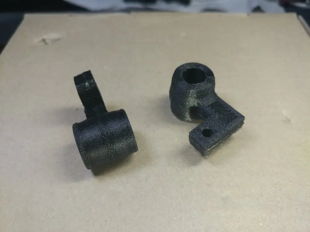

Something I did not like, however, was how there were lines showing up in the part. They seemed to be related to the slicer, but that was just a guess.

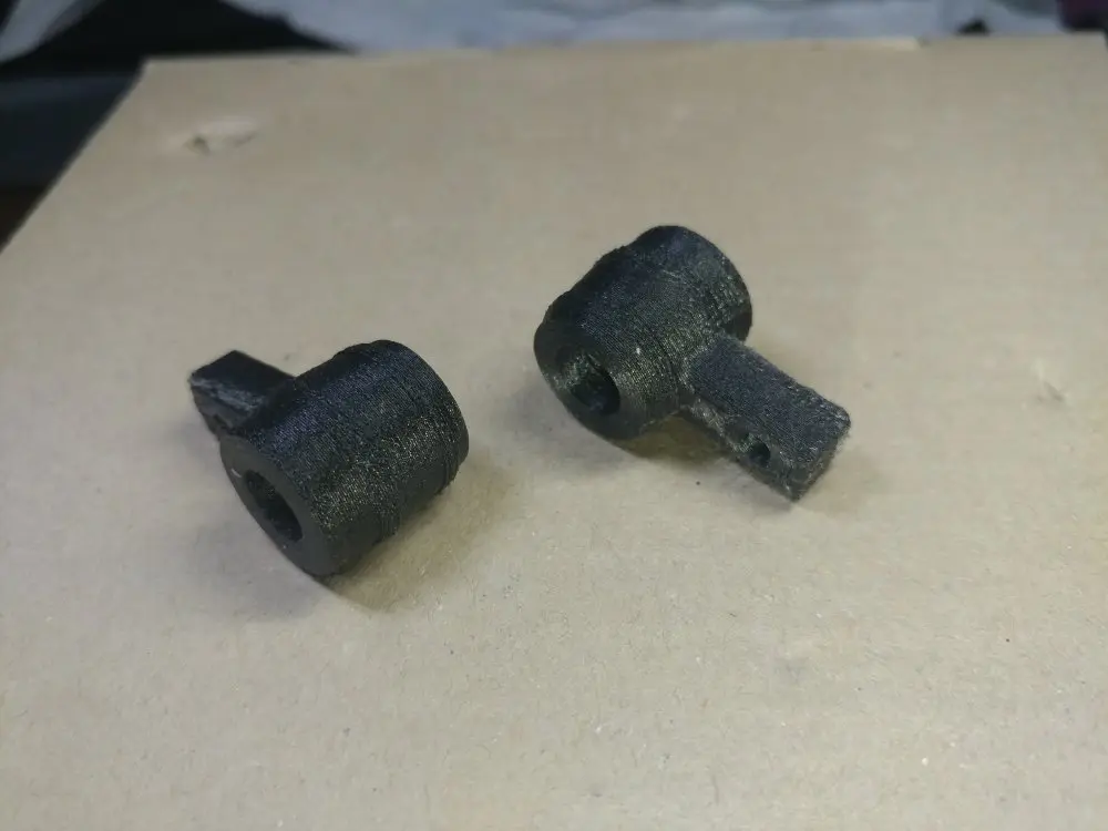

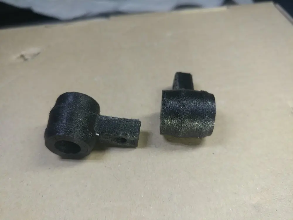

I printed those parts using Slic3r, and appropriately named slicing software that generates the G code for the printer. I then set up Cura for printing nylon, and cranked out some parts with it. They turned out substantially better. No more lines such as what the previous parts had. The part on the left has the support material generated to hold up the post during printing That's removed afterward.
This part came needed a little more cleanup but was fine once that was done. Overall I really like the finish the NylonX provides. The print layers aren't as evident as you'd see on most filaments.

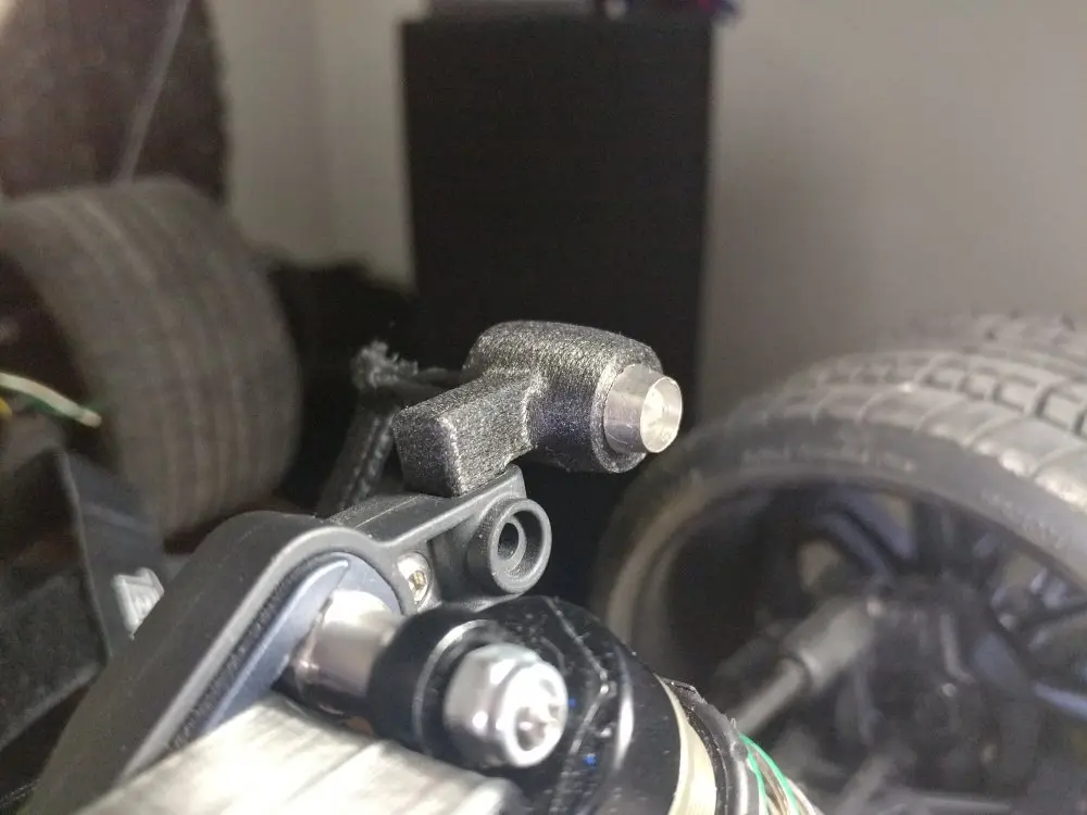

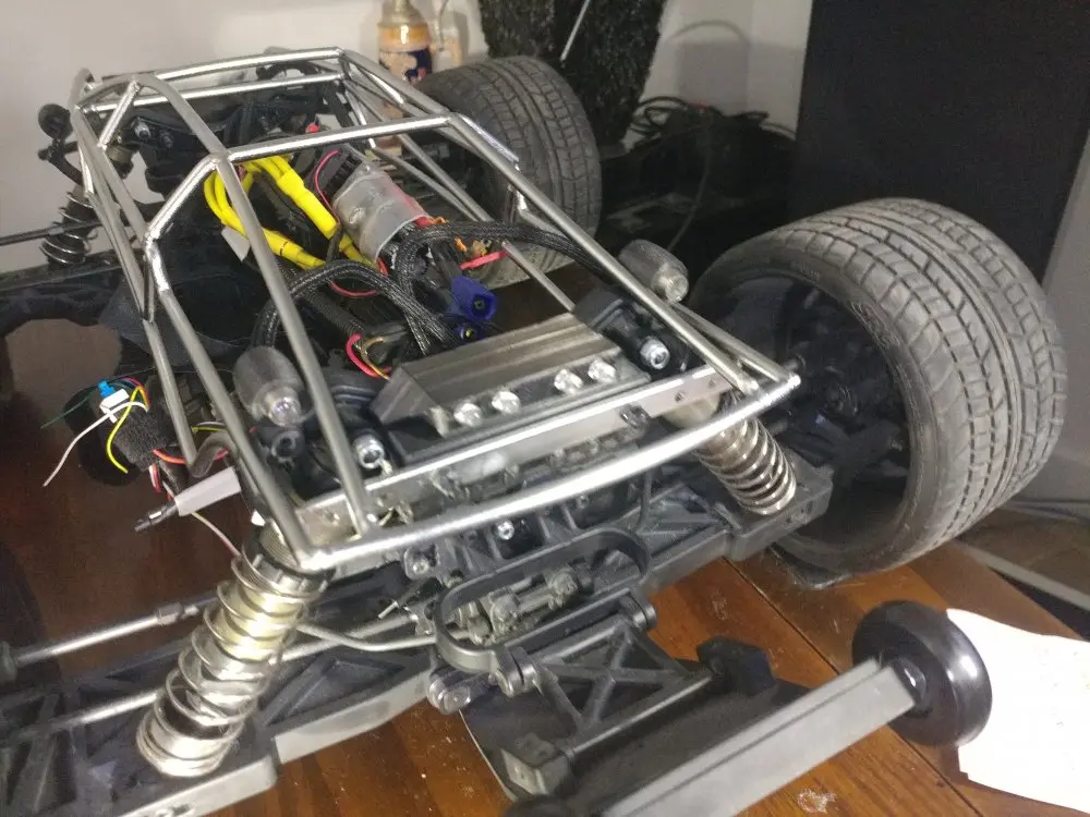

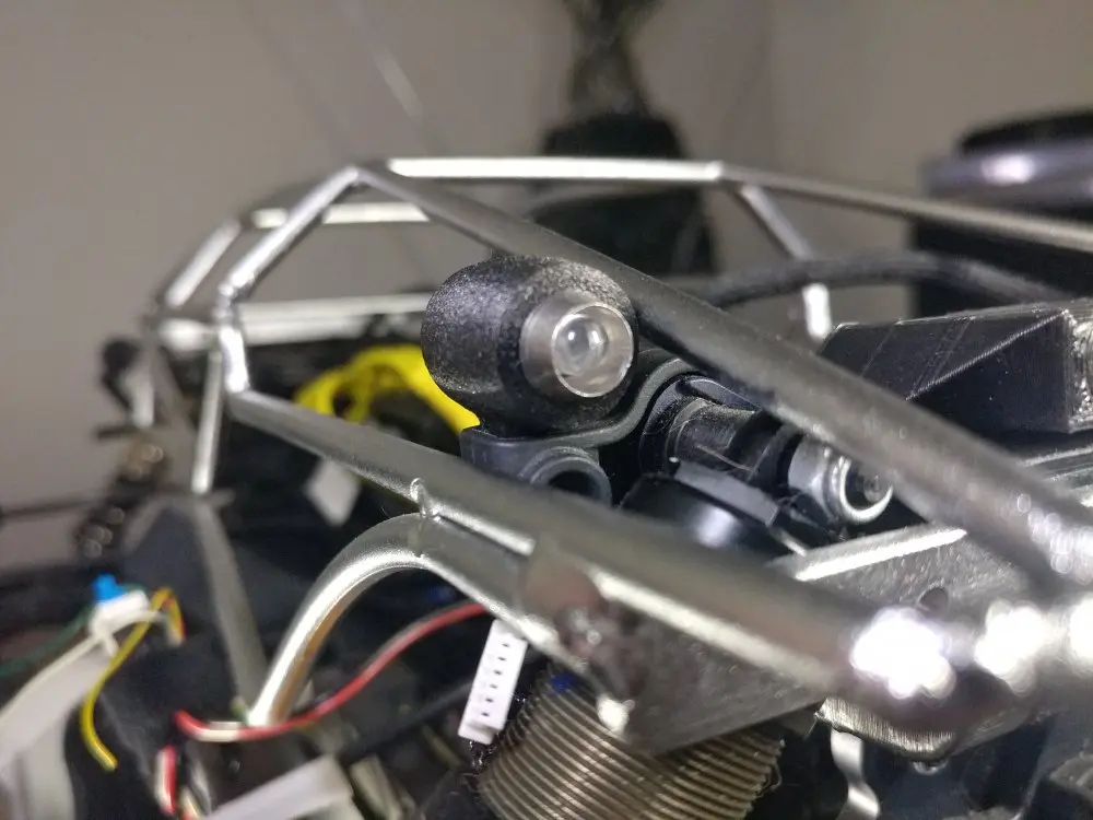

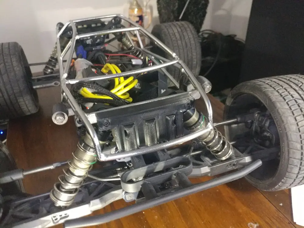

The light mounts are attached to the shock towers in the body mount posts.
Front
Rear
I was thinking of adding something to seal the LEDs like perhaps a Permatex product like their gasket maker. Eventually I want to be able to run this in the wet. I need to set up the other electronics on it in a way that they can be removed, like the cameras (which aren't installed presently).
Front
Rear
