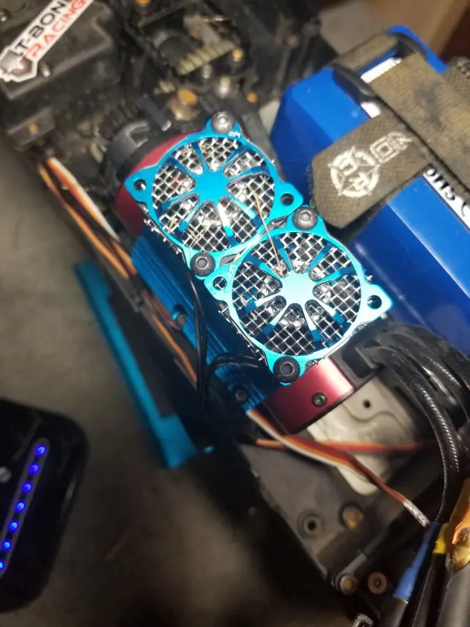

Also dogged my Leopard last night, 100 degrees out. The screens were removed from the fans, and I installed Boca Ceramic bearings in the motor (pulled from my Castle 1515) and only seen temps of 176. Not too bad, this was with Backflip tures, not the HUGE Badlands mx38's.

I got the Orange seals, they did seem to lower motor temps in the Castle 1515 (10 degrees -/+ 2 or 3). When spun in my hand they are much smoother than what I pulled out of both the Castle and the Leopard.

Ran again last yesterday evening, this time with the big Badlands mx38's. I removed the strapping on the tires, couldnt even get to half throttle the ballooning was so bad. Also motor got to 190 degrees with these things on, needless to say I have listed them for sale on a FB group.

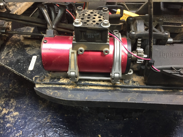

@RC_User Thank you for the detailed build thread where you have outlined the installation of the 1717 motor. I needed the m4 screws to mount this beast, already ordered and should be here around the same time as my motor arrives :)
@RC_User
How did you cram that 1717 can into the motor mount? Mine is stuck and wont go into place :eek:
edit...got it, ithe can was hitting the cap the holds the servo in the wire guide.

Yep I had to trim that down a hair.
