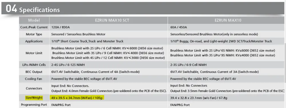

i am new to tekno and i am thinking of getting the et410.2. i like to builds kits and seems this one more for general use like bashing and speed runs. what do you recommend as electronics? i was thinking of the HW max10sct combo. i am looking to race. can car handle 3s lipo?on tekno website it is mentioned 2s lipo.

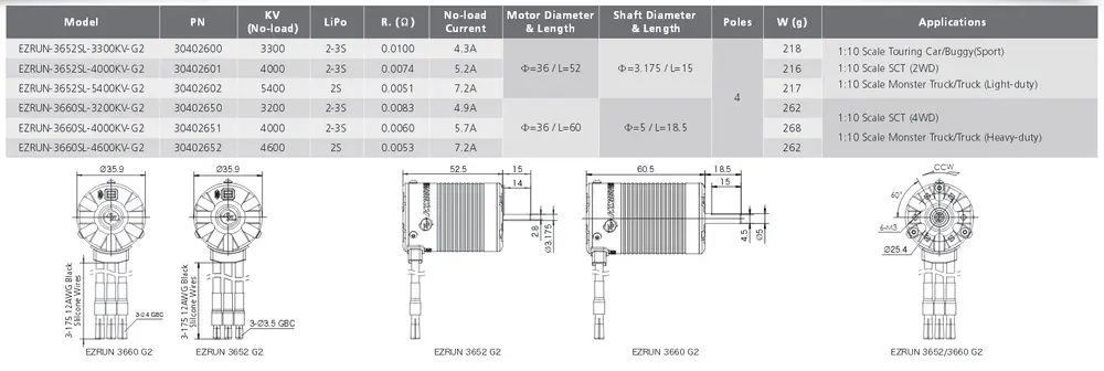

The problem with the et410 is not what the electronics can handle but physically what size battery you can run. 3s shorty batteries are hard to come by and usually a small mah rating so shorter run time. I am running a max10sct with a 3660 3200kv motor at 21tooth pinion. My esc and battery are normally more warm then the motor. I may step it up to a 23 or 24 tooth pinion to get a little more out of it.
I bought a couple 3s shorties from intellect lipo. Like Duval said they are only 4200mah but usually higher V pulls less A? Also have the max10 esc but it doesn't have a sensor wire so I'm stuck with sensorless 4 pole motors. I was thinking of trying like a 3660 3200kv on 3s see if it runs better than the 4600kv on 2s.

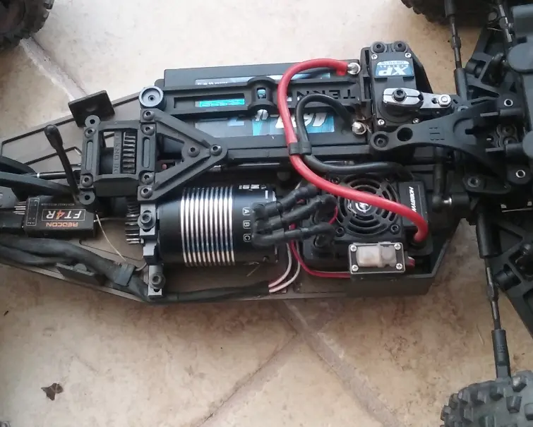

How's the fitment on the esc and motor and did you have to relocate anything with that combo? Sorry for reviving an old thread.

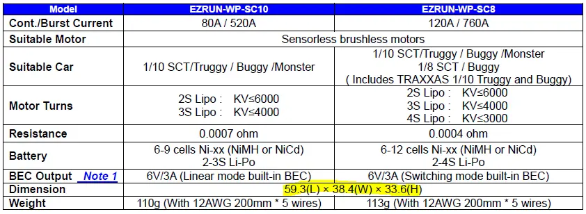

Just for reference: My old school Hobbywing WP-SC8 is about 10mm longer than the Max10 SCT and I could have crammed a 3660 can in there, but I wanted to see how power the 3652 provided... it did not disappoint!
