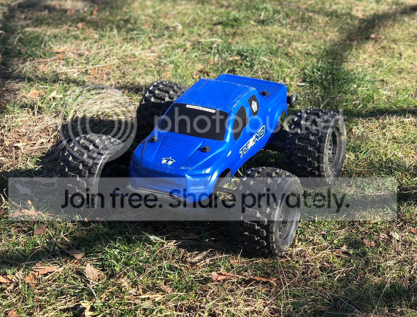

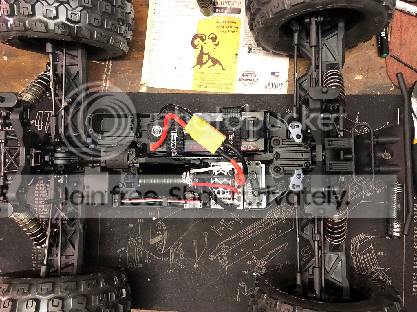

Started this build two weeks ago. Since this is my first RC I had quite the learning curve. Luckily I live a minute away from an awesome RC car hobby shop with indoor track. Those guys recommended the Tekno MT410 and had one on hand for a demo run.
I walked out with the kit and started the build. Added the following components;
Alum servo horn
OMG 32kg waterproof servo
PL 3.8” Badlands
PL F-150 Raptor body
Gens Ace 7500 4S battery
Spektrum DX5 Rugged tx and receiver
Tekin RX8 gen3/T8 2000kv motor
Took it out for its maiden run yesterday and what a BLAST!! This is one hell of a beast. Cracked my newly painted body, stripped the plastic servo horn, drained the rear shocks, and shaved down my spur gear a bit. All is fixed now and I reinforced the body with Gorilla tape. Took it out again today and was able to open it up a bit. Damn this thing takes a beating and keeps on going. Now on to bashing more challenging terrain.

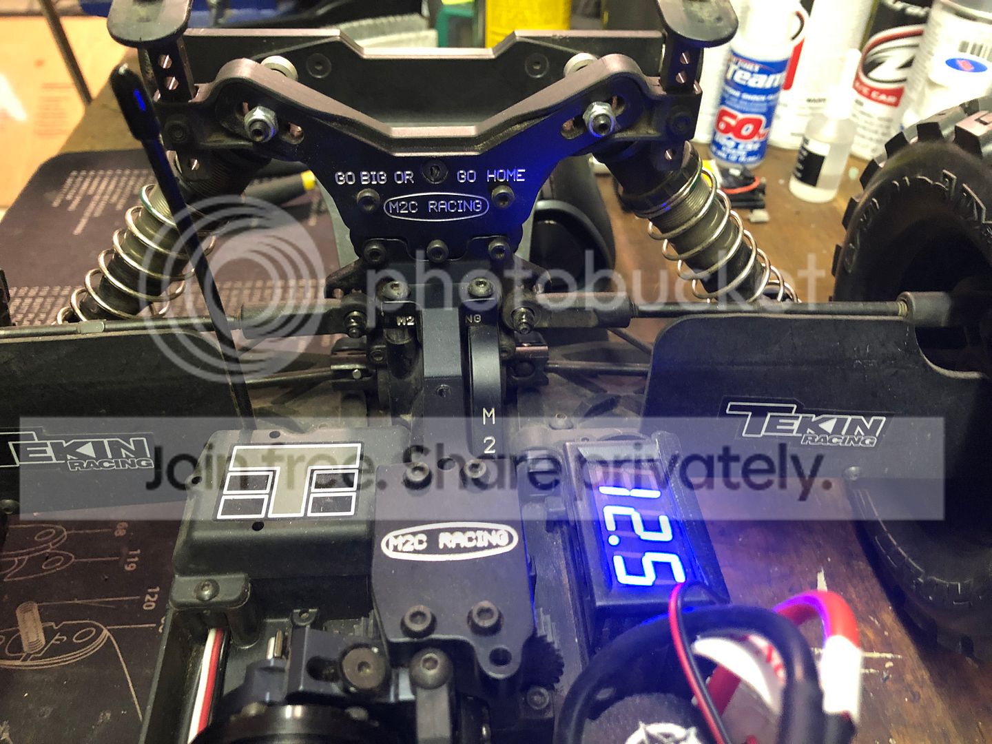

Received the T-Bone Bumpers & mud guards, volt meter, M2C tower and rear braces and M2C shock caps. Finally got those items installed. A few things to note;
While installing the new bumpers, I was left with two screws that attach the shock tower to the front differential case, however they are now too long since they previously ran through the impact absorbers which are no longer needed . To get them snug I had to add a few copper washers. Not sure what others are doing about this.
Another thing was the upper screws that attach the rear bumper were not long enough after installing the M2C tower braces. Keep this in mind when adding both the bumpers and shock tower braces.
Next I’ll be installing the M2C tower to tower brace, metal spur gear, and the RCManiac unbreakable body. Went with the blue one that is already cut. Stay tuned.

I believe I’m done with this build for now. Installed the metal spur, V2 mega brace, and unbreakable body. The body reminds me of those thick blue plastic wadding pools. definitely not going to crack now.
