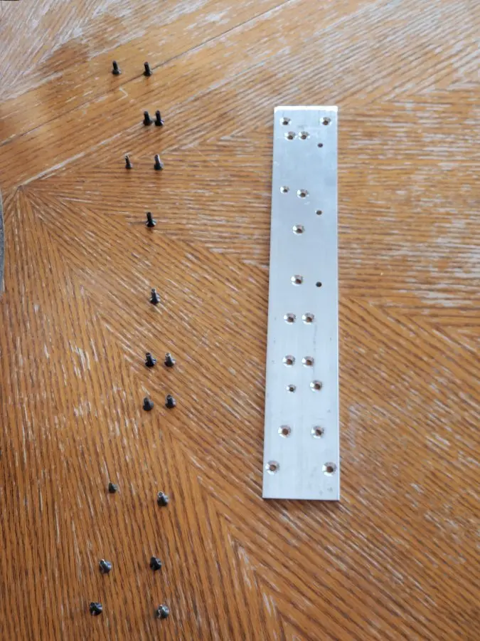

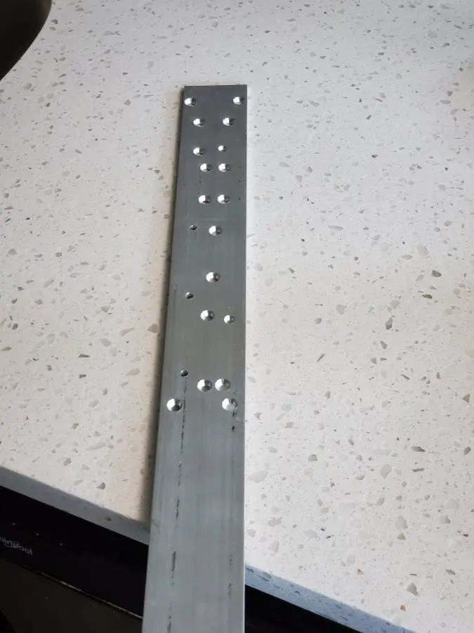

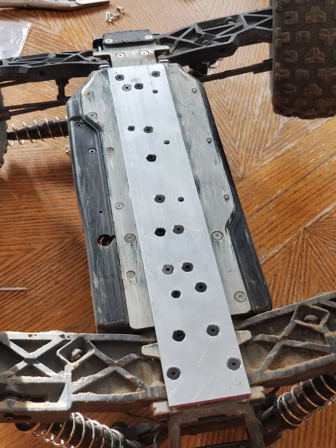

Bought a 2inch wide, 1/8inch thick, 3ft long bar from the hardware store. I was lucky to have a friend who recently bought an MT410 kit, so I used his bare chassis as the template, marked with a sharpie and drilled through at those spots, then countersunk the appropriate side.
That was probably the most labor intensive portion of it.

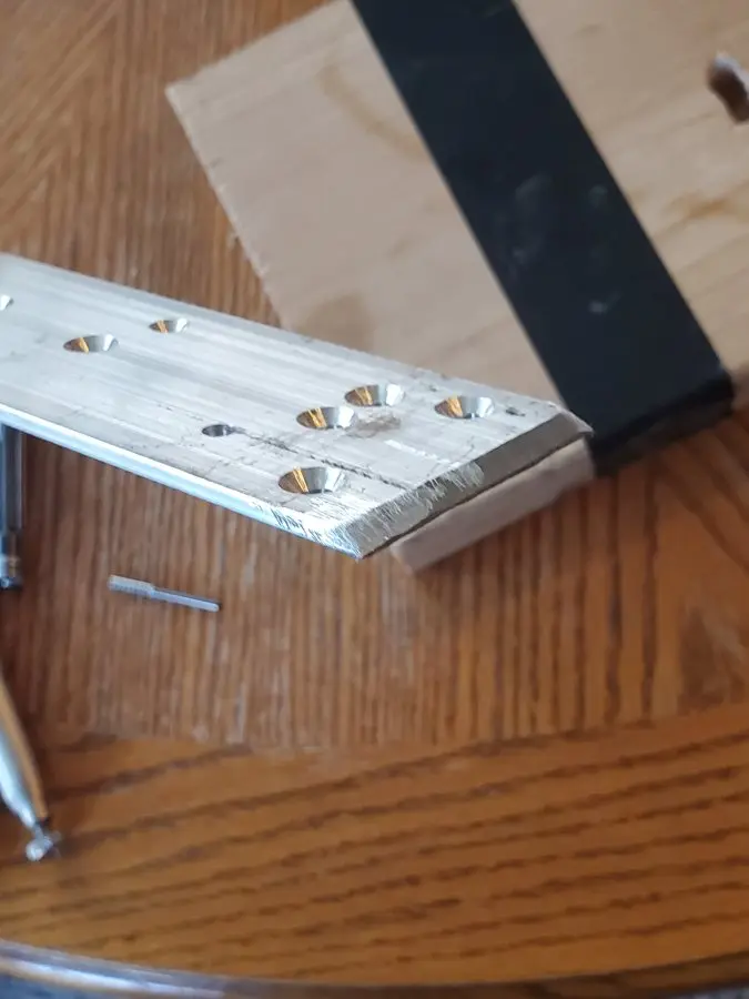

I had a friend grind off at the specified length and I slightly chamfered the leading edge with my dremel.

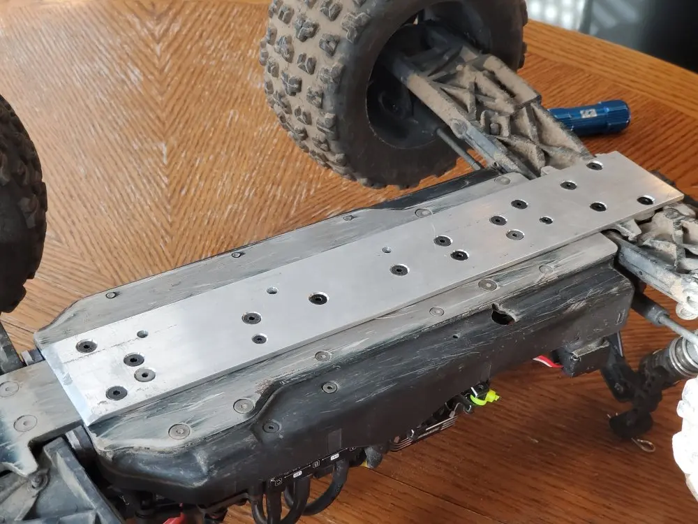

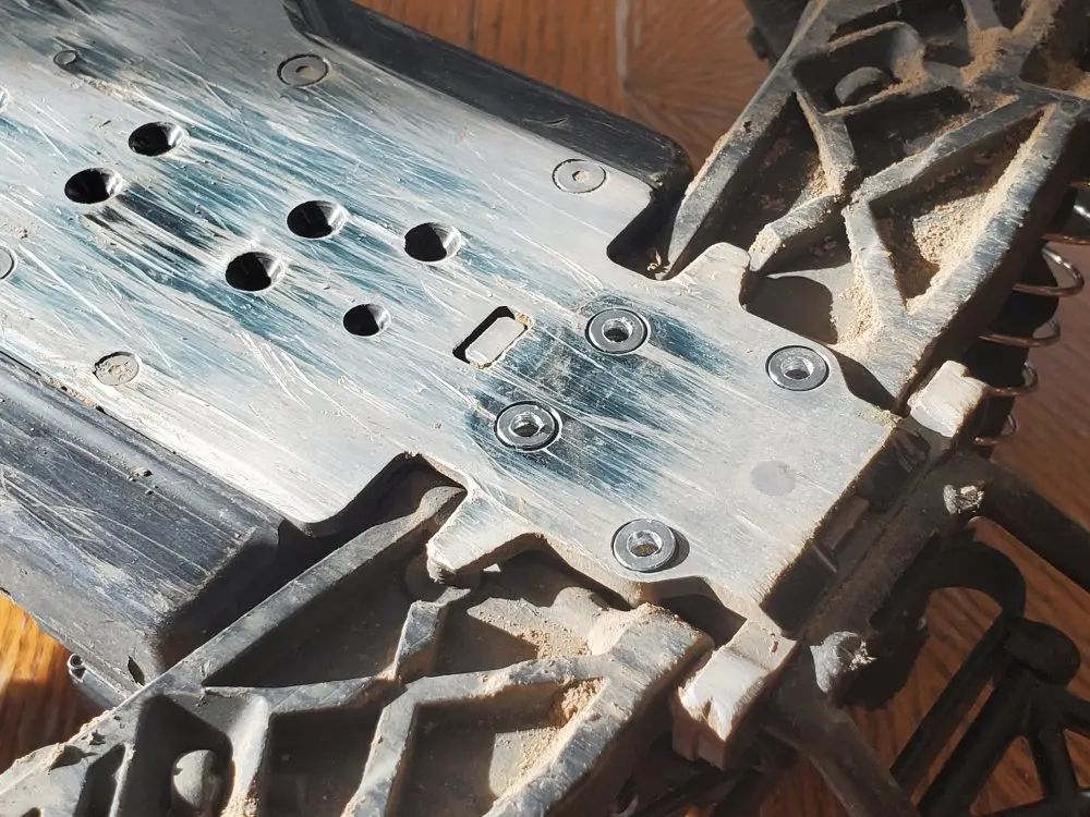

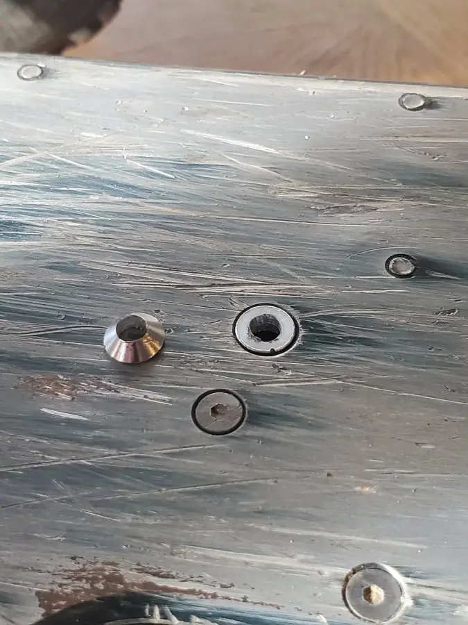

Results were looking good. I wanted to strengthen the rear diff area, so I needed some custom washers to fill the space where the old screws were. This was the trickiest part! Couldn't find anything!

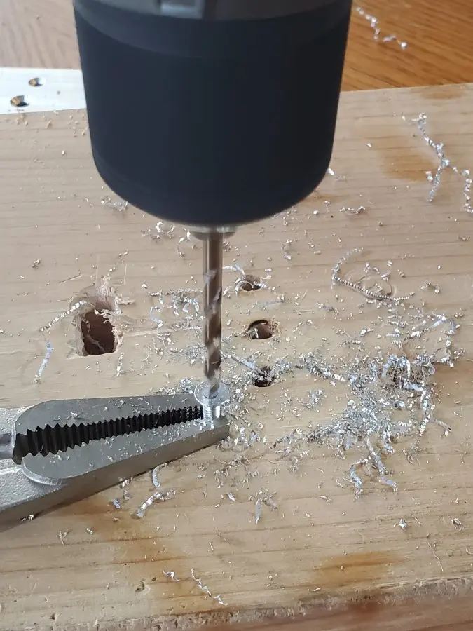

So I ended up purchasing some countersunk aluminum m4 screws from aliexpress and drilled through at the hex with a 4mm drill bit to "decapitate" it. The results are simply splendid! A good tight fit to take up spake and reinforce the skid and chassis. I just used them on the rear 4 screws and the leading two screws. Those specific areas I wanted to be able to tighten down tightly without fear of yielding the skid.
Fully assembled everything just today. I don't have a drill press, so alignment of the holes was all slightly off in the end, but it all "pressed in" once I got some threads engaged in each screw and tightened it down. I used slightly longer screws to compensate for the extra thickness of the skid.
I think the results speak for themselves! I'm excited to get her out and give it a rip!

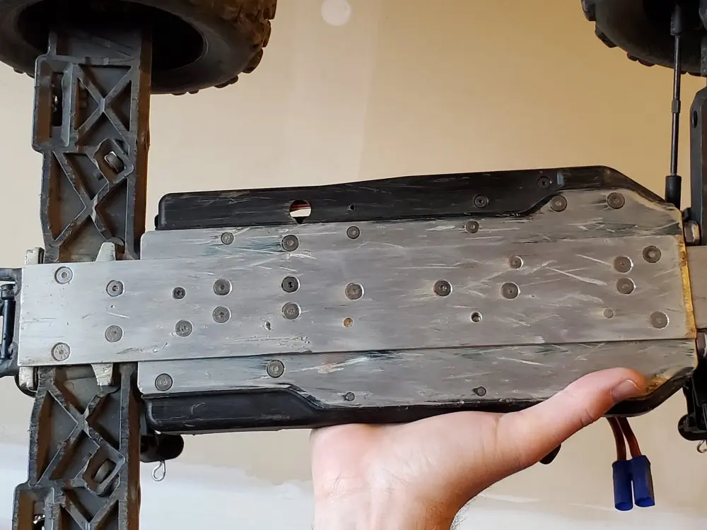

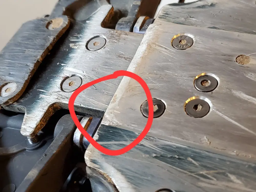

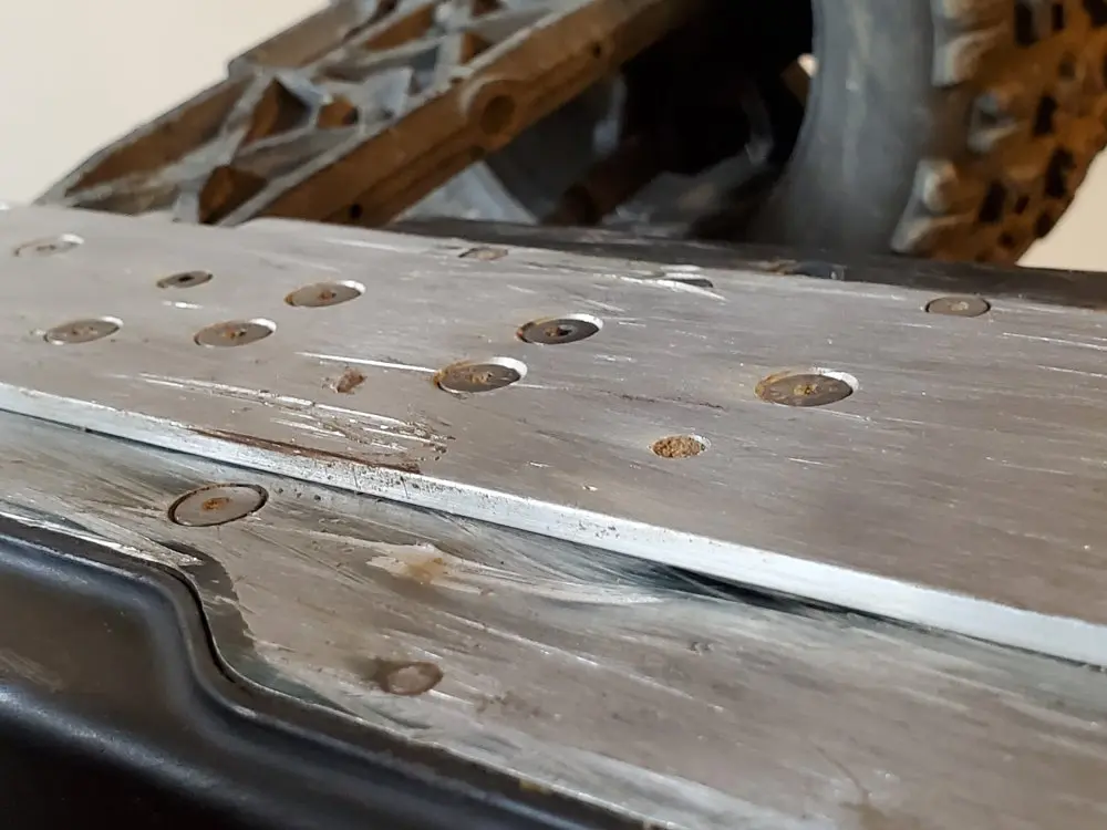

Sitrep after first hard bash. So far so good. I can see a few areas where the bash bar took some good hits!
Leading edge took a few gouging hits. Good evidence that under a direct hit, the bash bar will chip and break rather tranfer all that force to the fasteners on the chassis and sheer them! Lots of good scrapes cuts elsewhere. Those rocks partially protruding from the dirt are a real killer!
After bashing it was painfully obvious that the bash bar doesn't provide full coverage! Apparently those rocks stick up enough to create this bad gouge!! And imagine how bad it would have been on the chassis without the bash bar...
Overall, pleased with the results. Would do again. For the price of what I paid to build it, I think it will pay for itself many time over for not having to buy another $100 chassis as soon!
