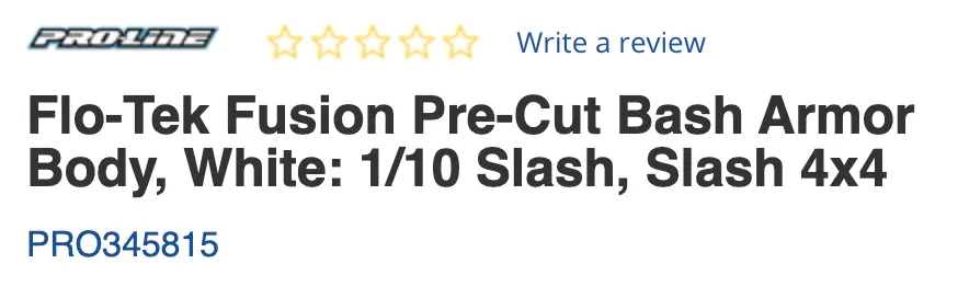

This is the product I'm reviewing today:

The reason I bought this product ~$100 USD is because I'm sick destroying bodies on my SCT (including so-called unbreakable bodies) and I've had extremely good luck with those Bash Armor bodies in the past.
The second reason I went for this body is because the it is a Flo-Tek body and I'm hoping to get a lot less parachuting with it.

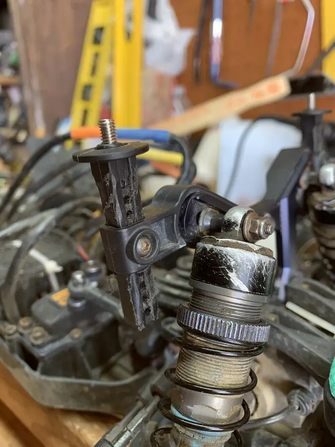

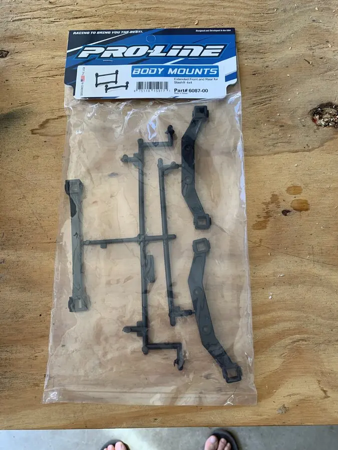

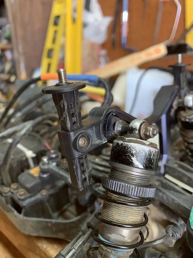

Note that the body is extremely thick and it will not fit with the stock Tekno posts (the hole for the pin is too low).
To make it work nicely, I decided to use those posts:
To get them fit in the stock mounts, you will need to grind them a bit:

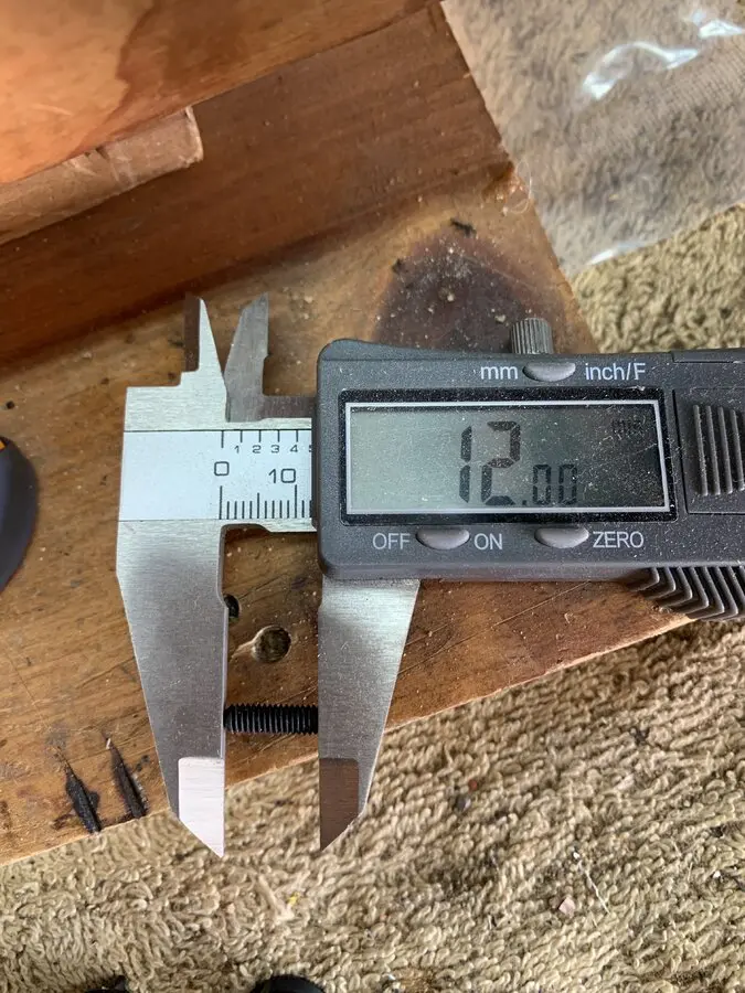

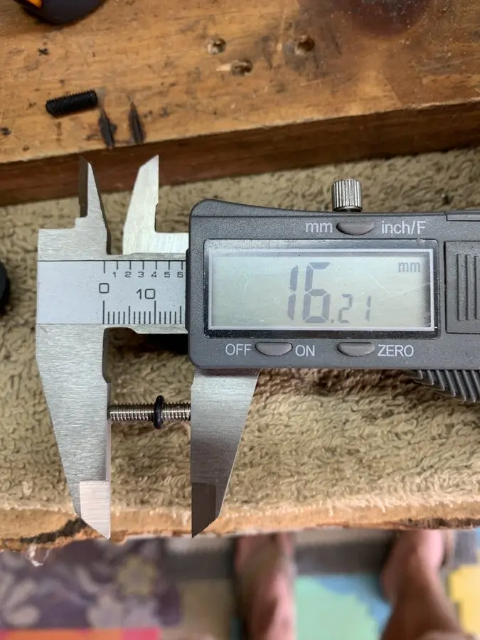

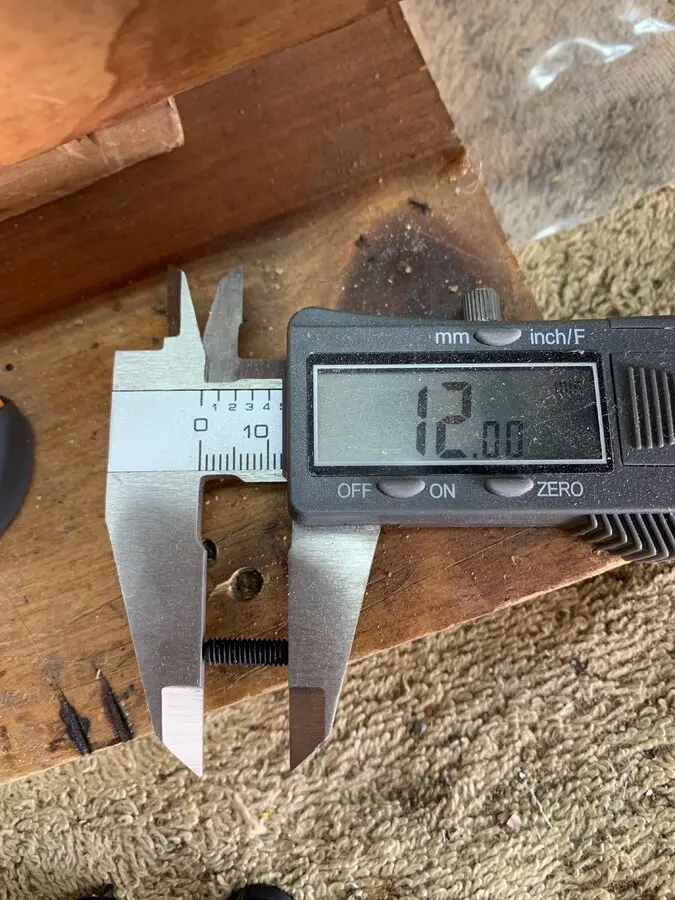

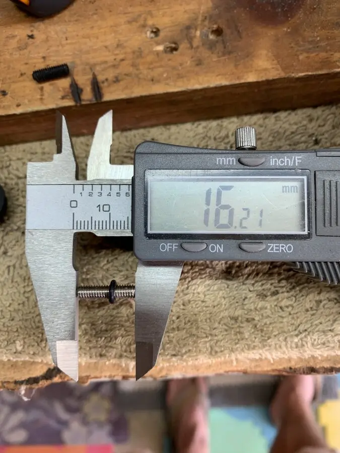

Since I already run those posts on a slash in the past, I decided to replace the head-less-screws with longer ones I got at a hardware store.
Stock screws:
Longer version:

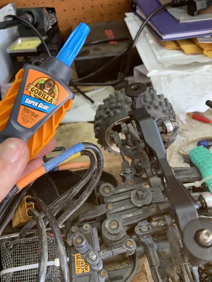

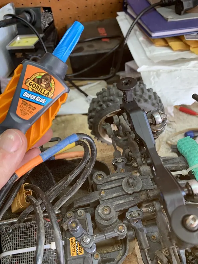

To also prevent them from pulling off, I glued the screws in the posts:

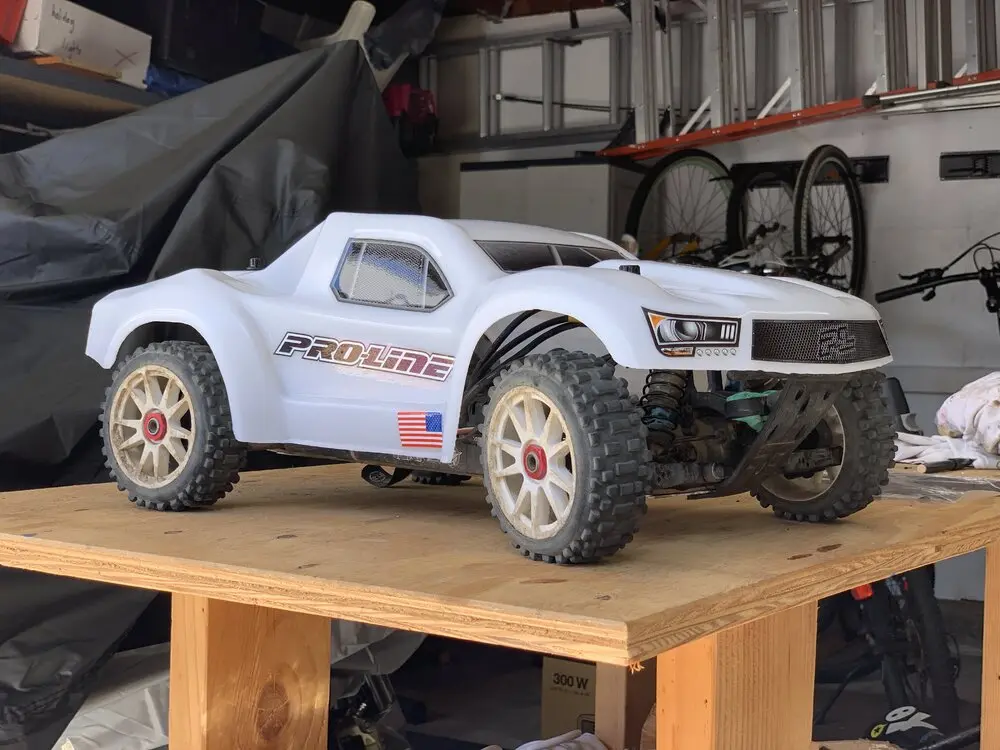

Final result:

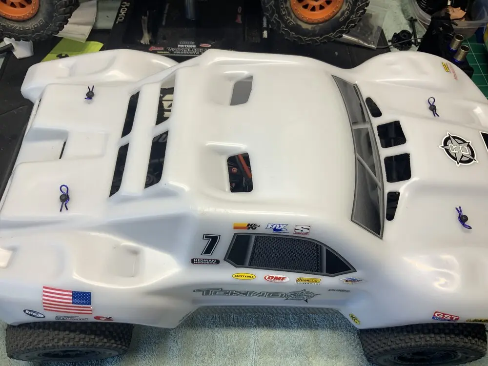

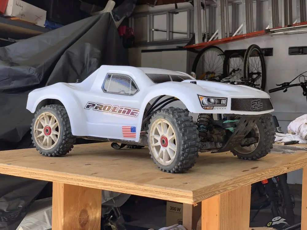

Mounted on my "1/8 scale SCT", (this is an EB48.2 turned into an SCT):
I love the fit and stance it has. Although I could live with more stickers to give it a bit more color.

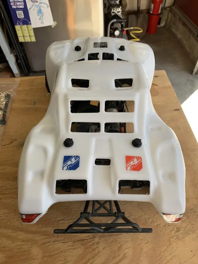

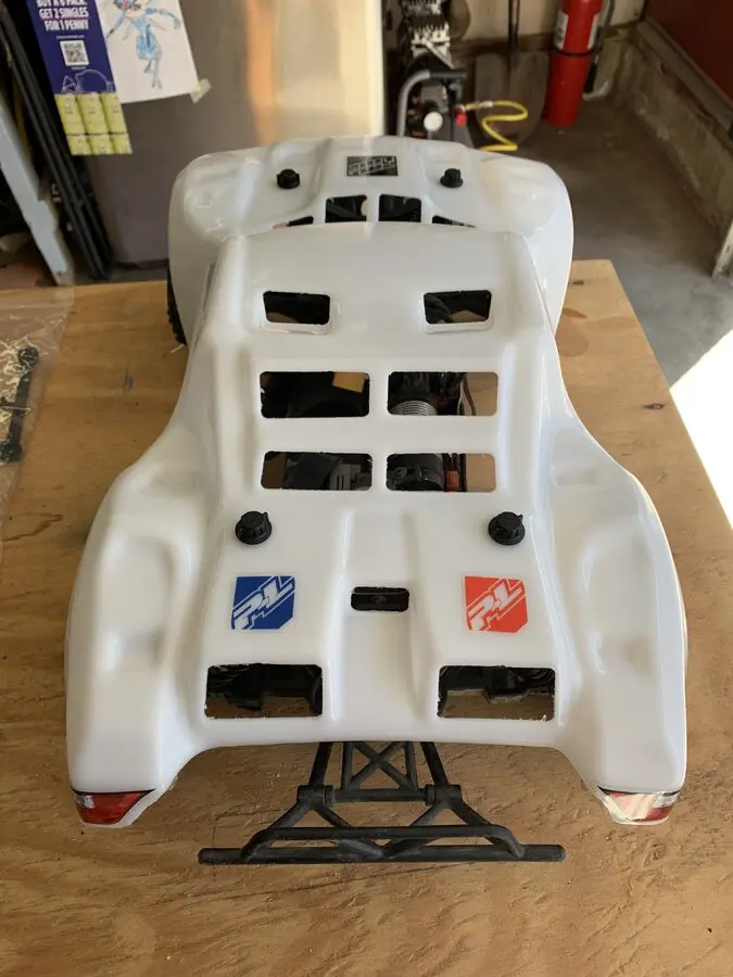

See from the rear all the vents for air-flow:
I can tell you this thing is STRONG.
Full review in the next post.
Stock screws:
Longer
version:
Final result:

Great job! You are spot on with your observation. But…. I have been able to use 1/10 clips fairly easily With no other modifications. Takes a bit of concentration but holding well so far.
This is a great review Nicochau! Am looking forward to some post bash analysis. I really appreciate your posting how you made it work with the body posts.
I wonder if it’s worth painting the outside for more color.
I agree that more decals would be great. I think there are some to be had aftermarket.
Also wondering about any appreciable reduction in parachute effect
