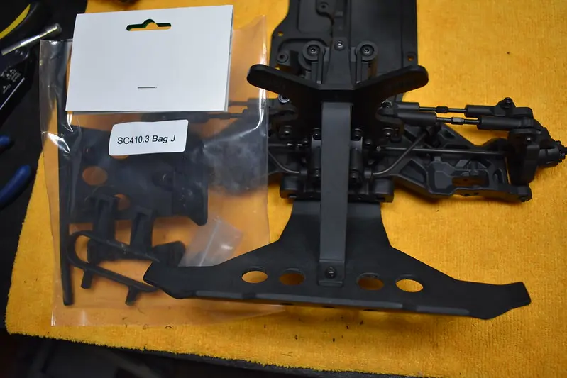

I rarely broke any parts on the SCT410.3, when I last drove it a couple years back but the single most important upgrade was the TBR front bumper which drastically improved the durability... they recently went out of business, so if I were to run this class myself today I would make my own custom bumper out of a sheet of 1/8" Kydex that you can order off Amazon.
Here's what it looks like for reference:
