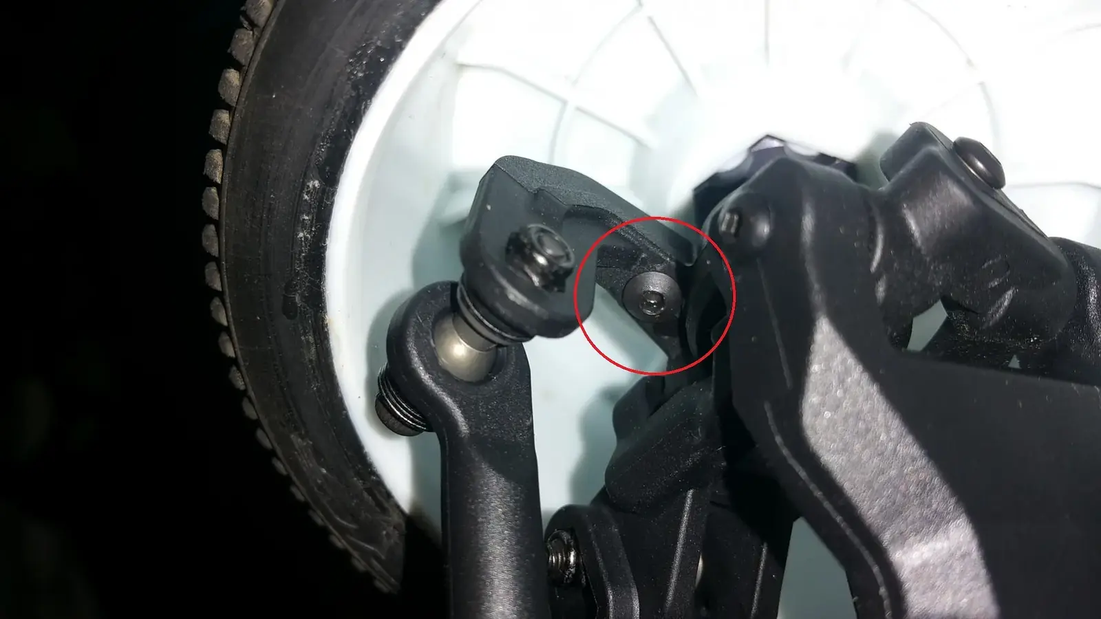

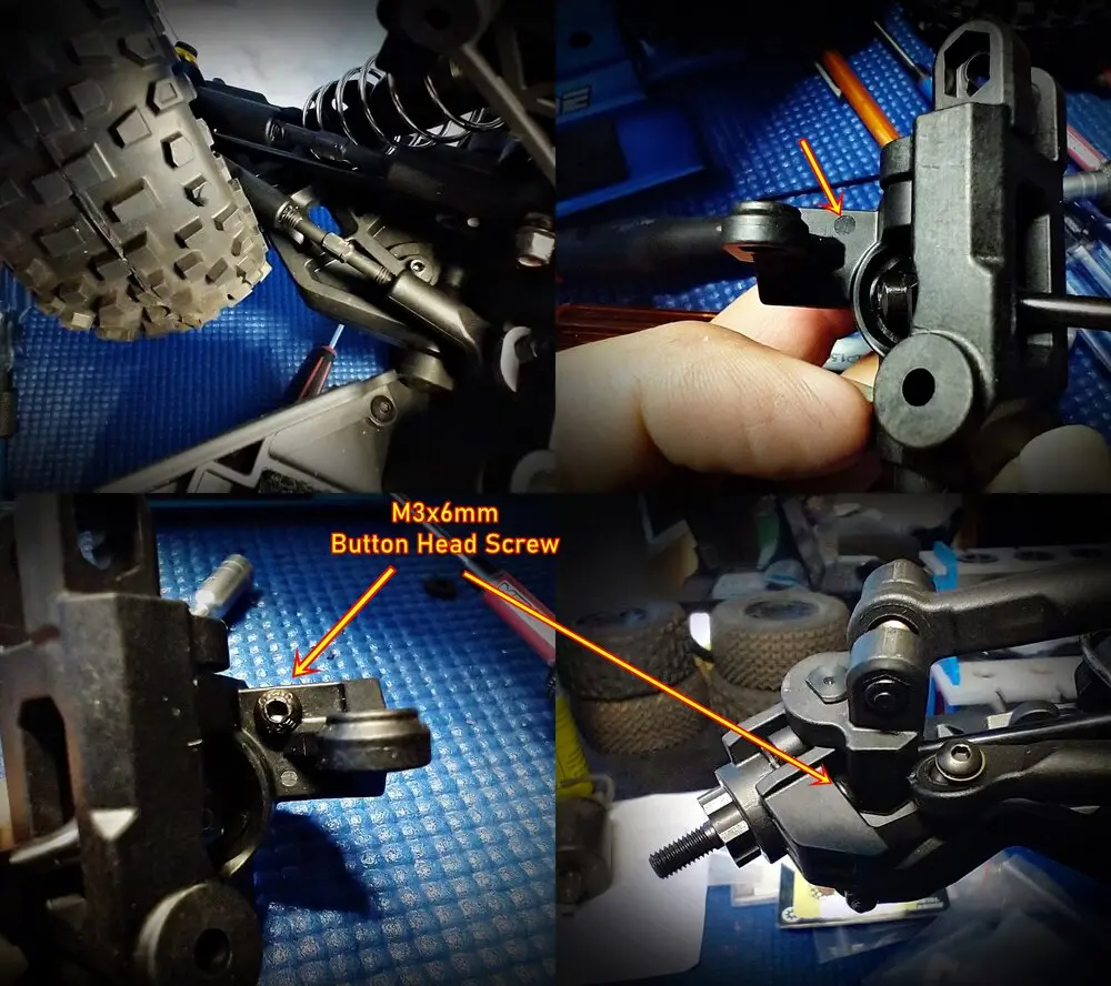

Having lots of steering is always nice, but that last little bit of steering throw has very little leverage on the inside tire while going into a turn. This allows inside wheel/tire rubbing on my 2.0's arm. The 2.0 manual does not suggest, nor does the kit come with, any steering stops (screws) to physically control that last little bit of movement of the inside spindle/steering block. There is a molding mark on the spindle and I though it would be a great place to add a M3x6mm button head screw.
I would consider installing wider hex adapters so you can leverage the max steering throw to prevent rub
Sorry, but that will not fix inside tire/wheel from "floppin'" around. It's just like on the SCT410.3, and other platforms. The inside steering linkage has no push/pull (leverage) on spindle at that last bit of throw.

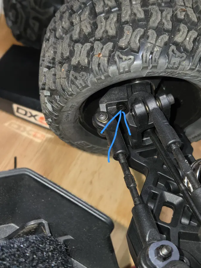

Thank you for the detailed write up and photos. A steering stop screw seems like it should be a standard kit part.
Any complaints or broken knuckles since adding the stop screws?
Starting to get a bit of wear on the arms of my 2.0 as well.
Probably a noob questions because well, I am a noob but couldn't you just adjust your servo end points vs putting the screw in?
