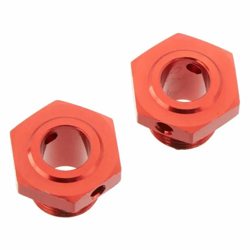

Hi, I have a sct410.3 with the 17mm conversion (that's the way I bought it and like it for tire choice/price reasons). But the track width I'd like to bring back to SCT width. I believe that's what TKR5569 is for but can't find them in stock close to me right now. Could I use some other similar 17mm hubs? Arrma, Traxxas? The axle diameter and pin dimensions seem to be pretty standardised across the 1/8 buggy world from what I've seen. Just choose some that have the pin going through the hex which makes them narrower.
Edit: how about this? In stock and on sale. But the axle hole diameter seems thicker compared to my current ones (and the arrma lineup). TKR9674 for the 2.x EB48/NB48 etc...
Scratch that, I just realised that the inside diameter is much narrower. Guess I'll have to find the original hexes.

I made the mistake of thinking I could use Tekno 2.x hub adapters on my TC and Arrma 1/8.. not exactly. The pin that secures the adapter to the stub axle is bigger, say 3mm vs the xx.3 that were 2 or 2.5mm not sure but they're different.
I drilled the stub axles on my TC kronos to fit the Tekno pieces. They work, no real benefit that I can tell though..
I was trying to get rid of the slop between the adapter and stub. Worked for a while but I have freeplay yet again now..🤷‍♂️
