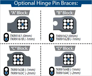

So, if I'm seeing things correctly...
The stock setup is based off the center position of the -1mm A,B optional blocks for the front. For the rear, the stock setup is based off the center position of the -2mm C,D optional blocks.
Is this correct?
What are the benifits of the different hinge pin braces in regards to the I assume the offset of -1 and -2?
What is the stock offset for the SCT410 2.0?
