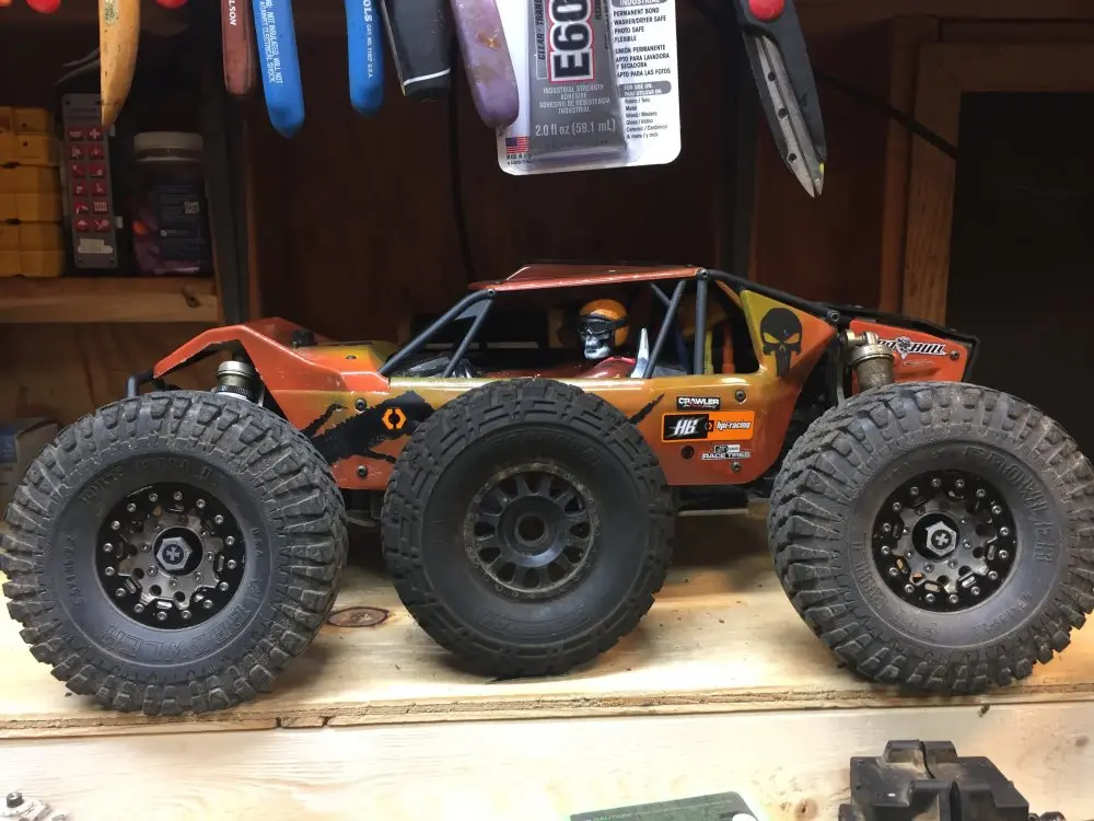

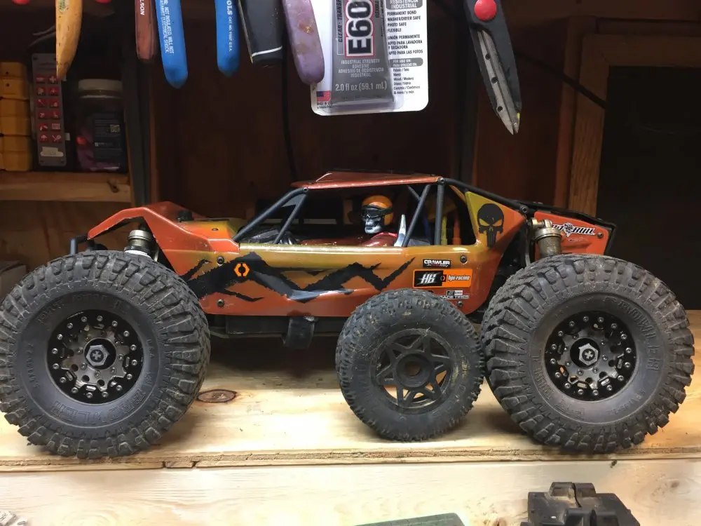

And here’s a comparison with a Nomad DB8 tire
What is the outer diameter on those growlers? 7 inches?
Thanks. How does it drive with all that rubber? Does it ballon a lot at speed?

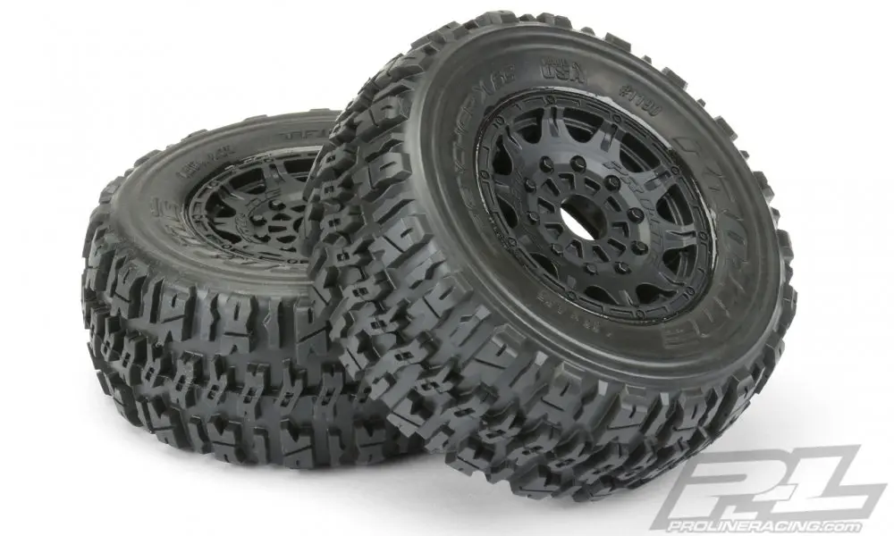

Drives great. I mostly run 5s. These Pitbull growlers do not balloon much at all...partly because they are designed for some speed, plus I’m using crawler innovations closed cell foams.....and I also have the tires wrapped with fishing line at the center tread. I also have a set of Proline Hyrax 2.2 tires that really do good at speed.
I also have Pitbull rockbeast tires, but they balloon like crazy so they’re used mostly on my Wraith.

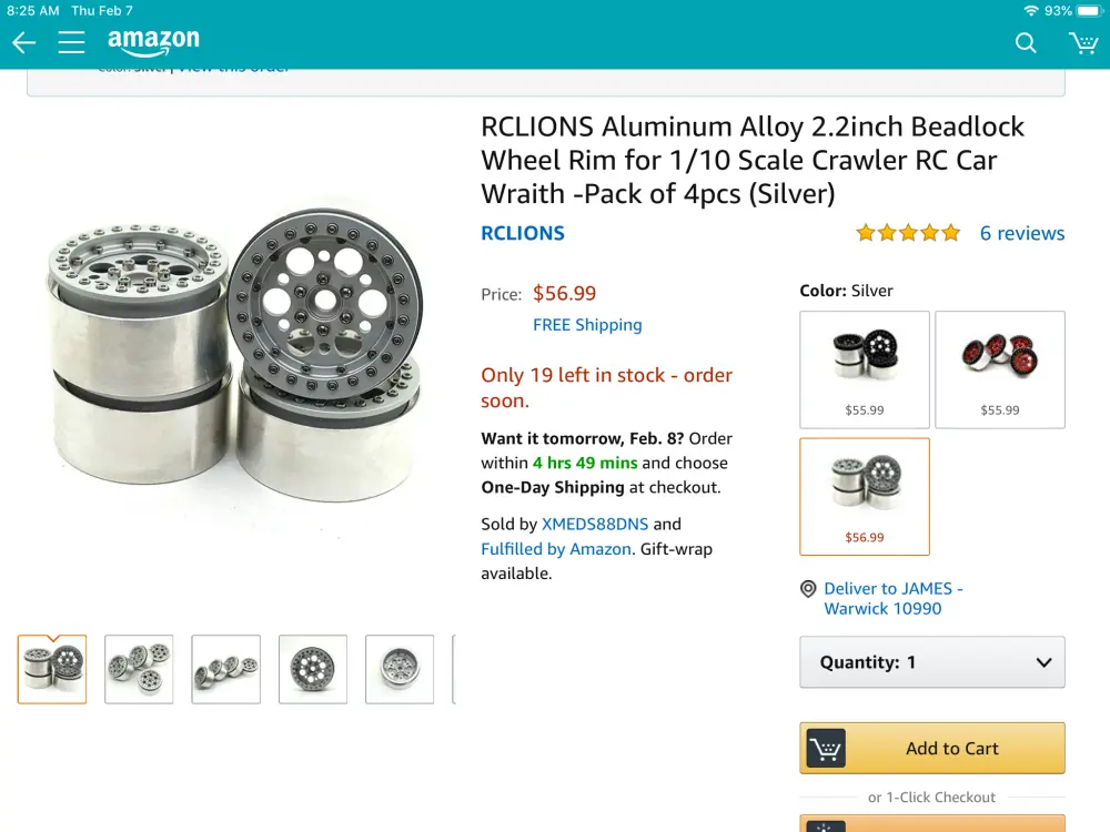

. With these Dlux hubs you must use Vanquish wheels or wheels with same bolt pattern as Vanquish. Many of the Amazon and EBay Chinese beadlocks are Vanquish equivalent. ...and they are actually very nice, and cheap. I have a couple different sets.
I have a set of these. Cheap, very well made and very easy to assemble
