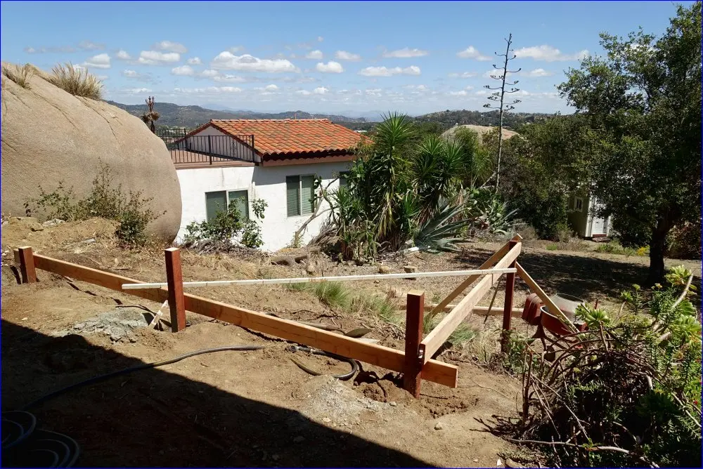

I built my shop over a slope in the yard that wasn't useful for much of anything else. Digging the holes for the posts is the ONLY thing that I paid someone else to do. My 60-year old legs and back weren't up to that. Besides, the earth here is mostly rocks. The guy who dug them out for me got down in there with a large rotary hammer drill which did a good job of breaking up the dirt and rocks. Once in a while he'd hit a fairly large rock. He'd dig around those to loosen them, then lift them out separately. A couple of those were a serious struggle!
Each hole is 3-feet deep and 2-feet square. Each hole gobbled up about 1/3 of a cubic yard which I mixed on-site with an electric mixer that I bought years ago from Harbor Freight. That sure was a great purchase! That mixer has been loaned out multiple times and is beat to hell, but it still runs great. I chose to use bags of high-strength concrete which I had delivered and placed nearby on pallets. While mixing, I supplemented the concrete with an extra scoop of portland cement. My mixer could handle 3 bags at a time. Depending on the hole, I'd use anywhere from 6 to 9 bags. After all, this is Californica - land of wiggly earth. I wanted some serious strength for the base of my shop. Fortunately, where I live, we have granite everywhere, so I don't have to worry about liquefaction during an earthquake.
Here is a year of my life boiled down to a few pictures:
Getting the foundation completely square was important to me. Thanks to my old pal, Mr. Pythagorus, it wasn't too hard to do:

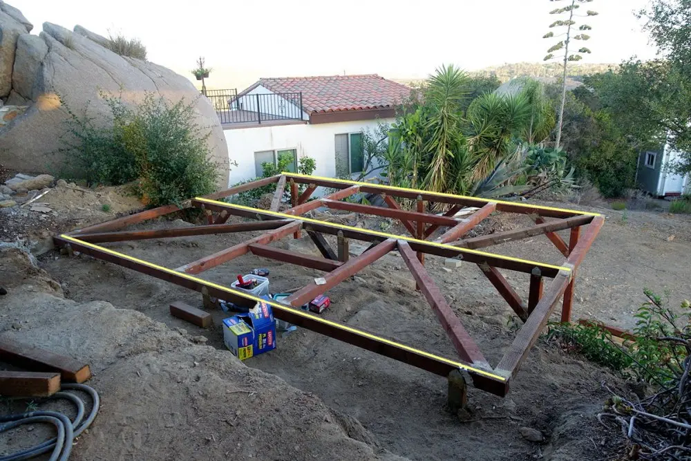

Once I had placed all 9 posts, I cut them off level and placed three 16-foot 4x4's across. The yellow lines in the picture below show the 3 16-footers. All of the others are filler for structural support. I used construction glue and lag bolts at every intersection. I also made use of several galvanized brackets and straps.

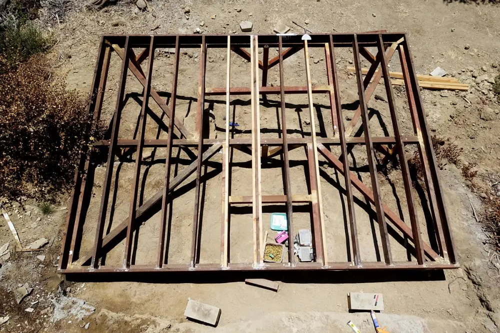

I built the subfloor frame "floating" on top of the foundation structure. Once it was fully assembled, I squared it up to the foundation and then secured it with glue, straps and 3-inch exterior grade screws.

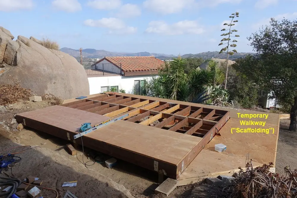

The temporary walkway "scaffolding" around the shop allowed me to complete the exterior without having to do everything from an extension ladder. When the exterior was complete, I removed the walkway.

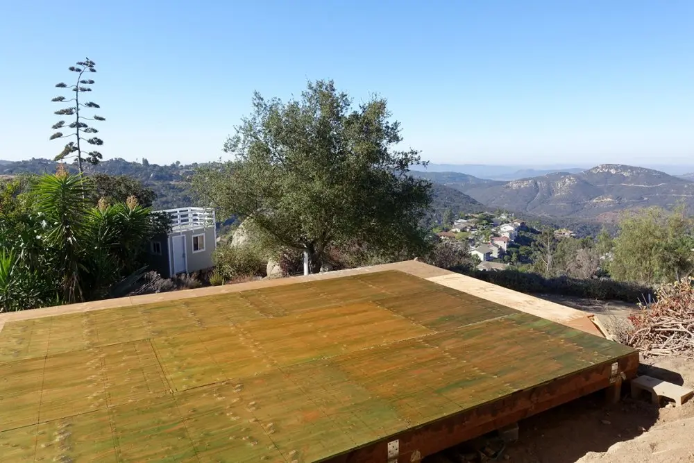

The odd color of the plywood is a liberal treatment of copper-green wood preservative. I never expect this subfloor to get wet, but better safe than sorry.

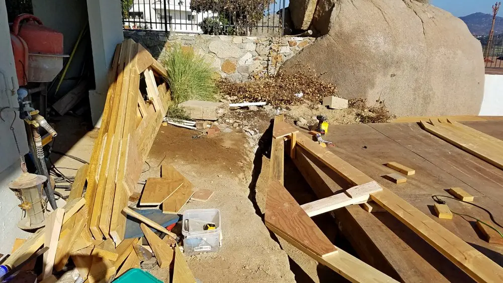

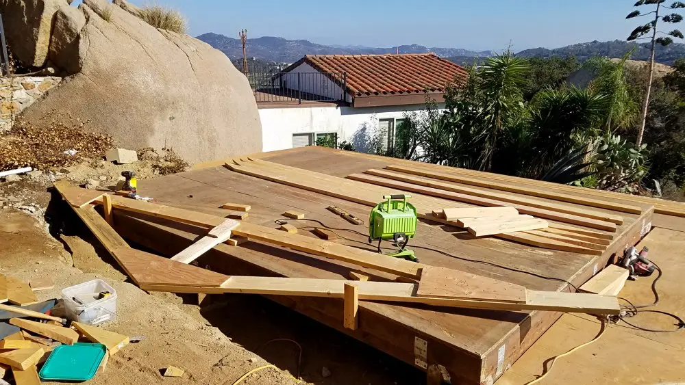

I built the roof trusses using a temporary "jig" laid out on the shop floor. When each truss was complete, I set it aside. Later, I lifted them up onto the completed wall frames.

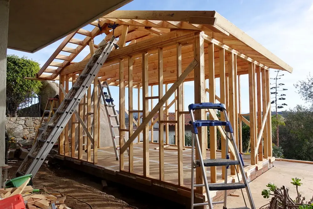

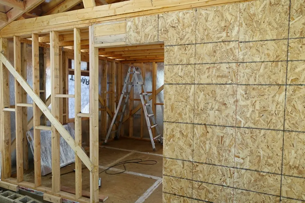

All of this assembly is glued and screwed 100-percent. There are no nails in this structure. Even though I later sheath the exterior 100-percent with OSB, I added these diagonal braces to the studs to help stop any twisting in an earthquake.

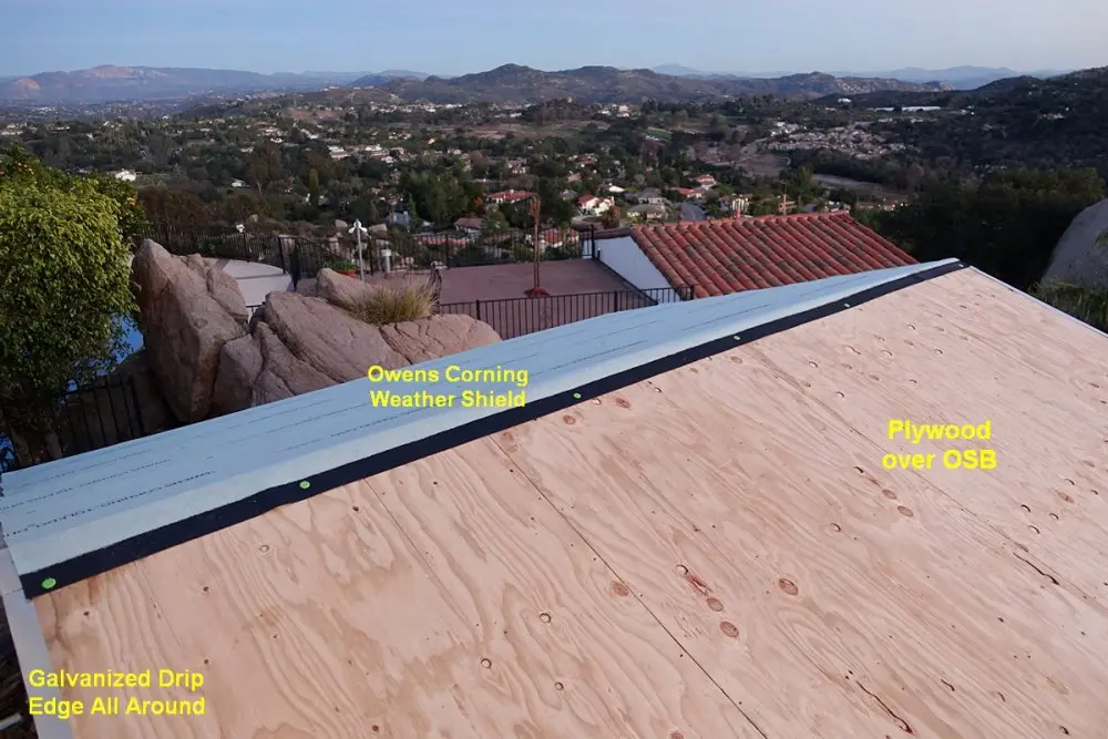

The roof is a double thickness of wood. The sub-layer is OSB with radiant barrier facing inward per specification. A layer of 1/2" plywood was placed over that in the opposite direction. I covered all of it with Owens Corning Weather shield.

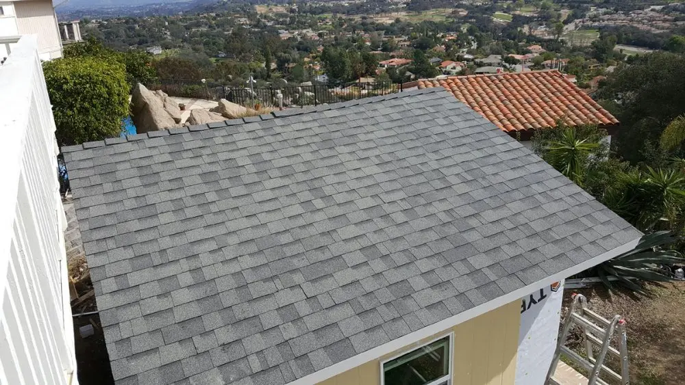

My son came over and laid the shingles so that I would not have to toddle around on the roof. I really appreciated that!

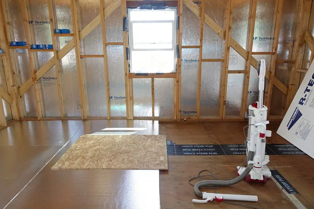

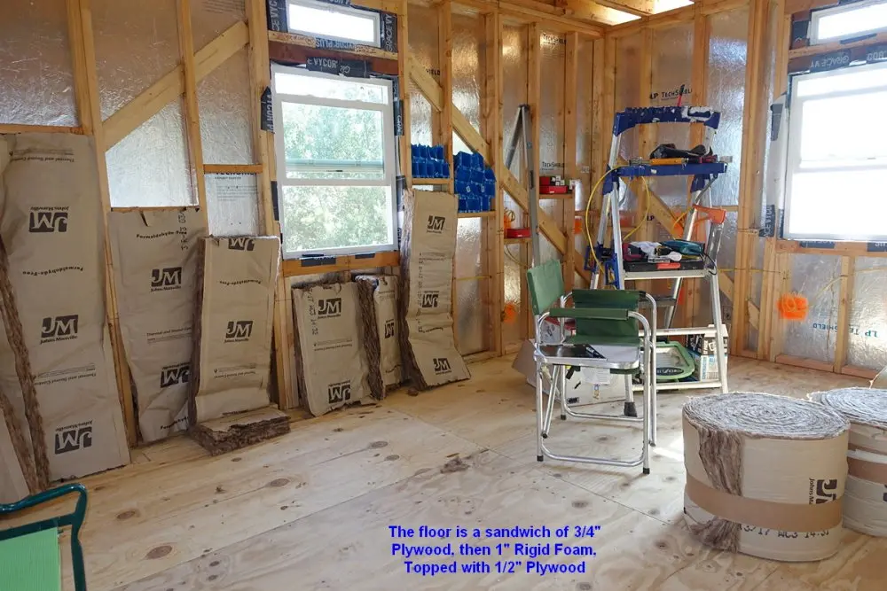

Inside, I created a sandwich structure on the floor. The original sub-floor was 3/4" plywood. Over that, I glued 1-inch of rigid foam insulation, then floated 1/2" plywood over that in the opposite direction. The "floating" upper floor was secured by screwing through the foam into the wood below. It was a bit of a challenge to get the tension just right on all of the "floating" floor panels.

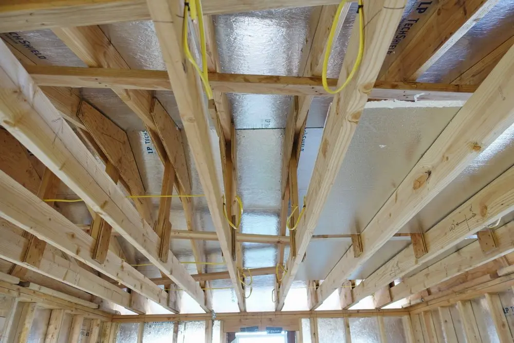

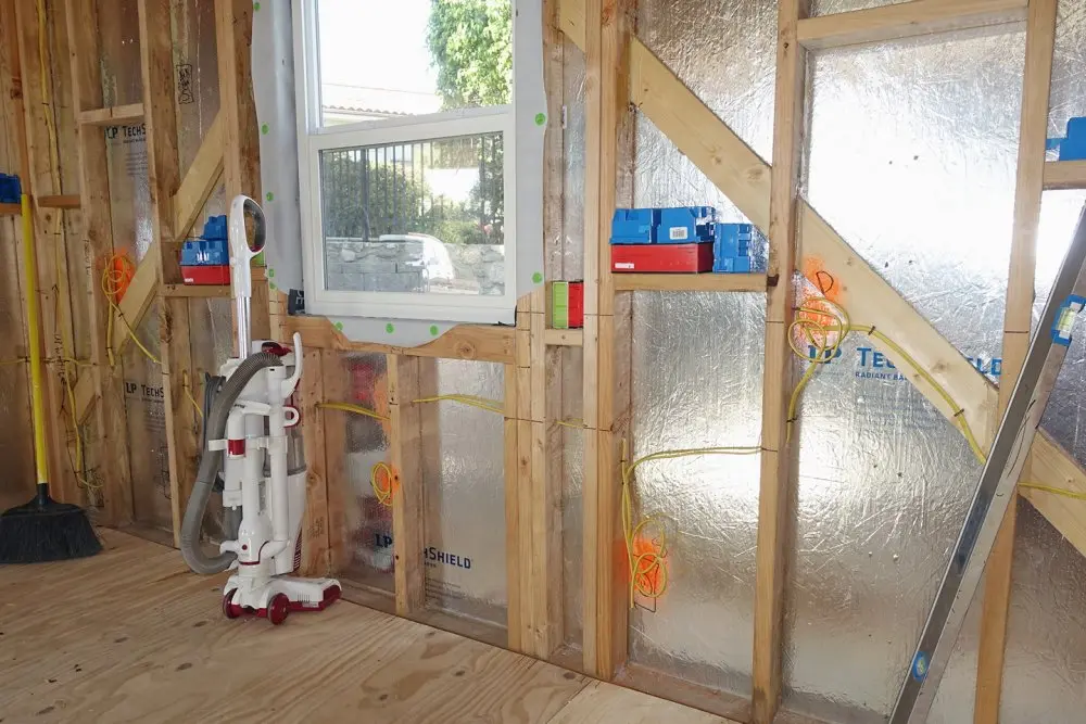

I ran all the wiring in walls and ceiling before placing the insulation.

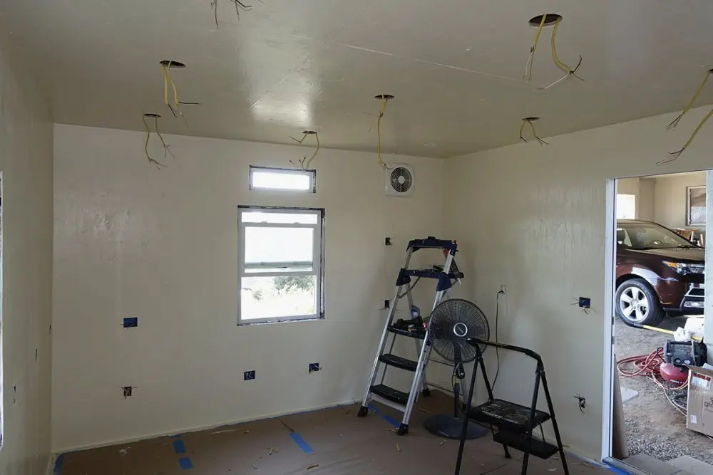

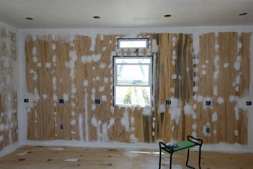

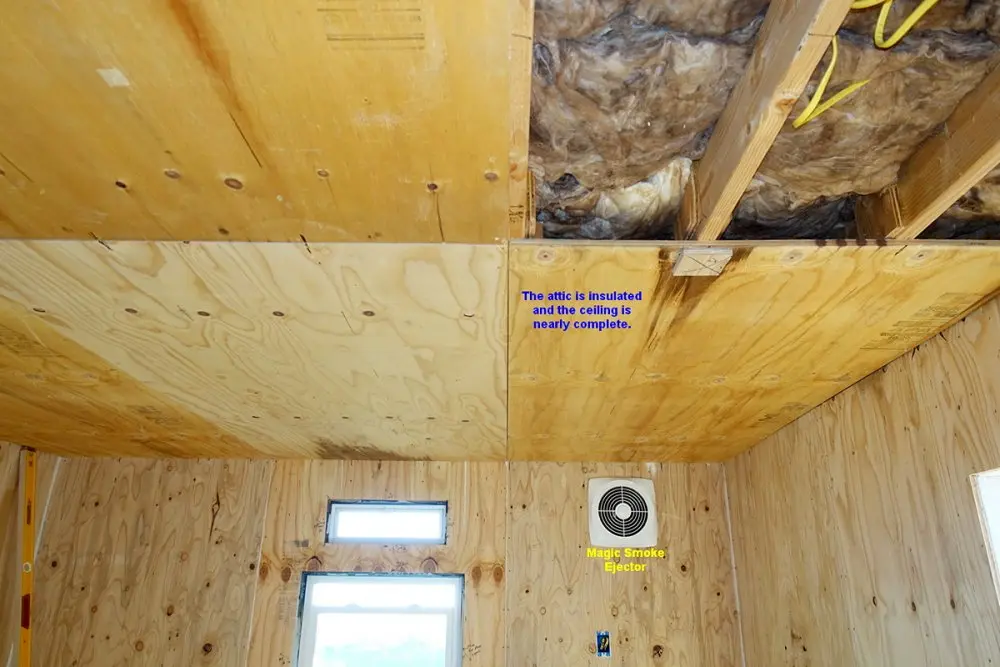

I chose to use 1/2" plywood rather than drywall on the interior. I know that is not applicable for fire-code, but I did it so I could hang planes on the walls and ceiling at any location without having to worry about wall anchors.

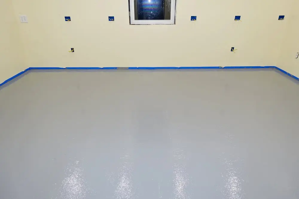

I originally intended to lay vinyl plank flooring. However, to save money, I used three coats of porch/floor paint. I can always cover it later if I choose to.

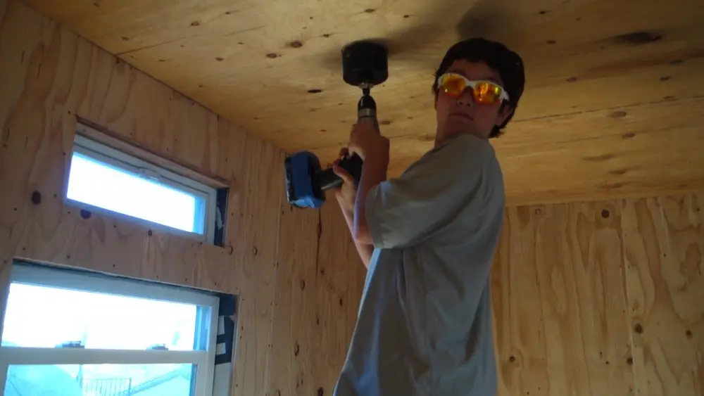

Here is my crew foreman, my 13-year old grandson. He enjoyed helping me and learned a lot doing so. Here, he is drilling a hole in the ceiling for a 5-inch can light. He and I are into the RC hobby together. He will have space in the shop.

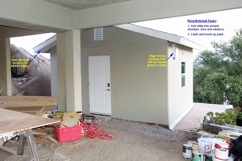

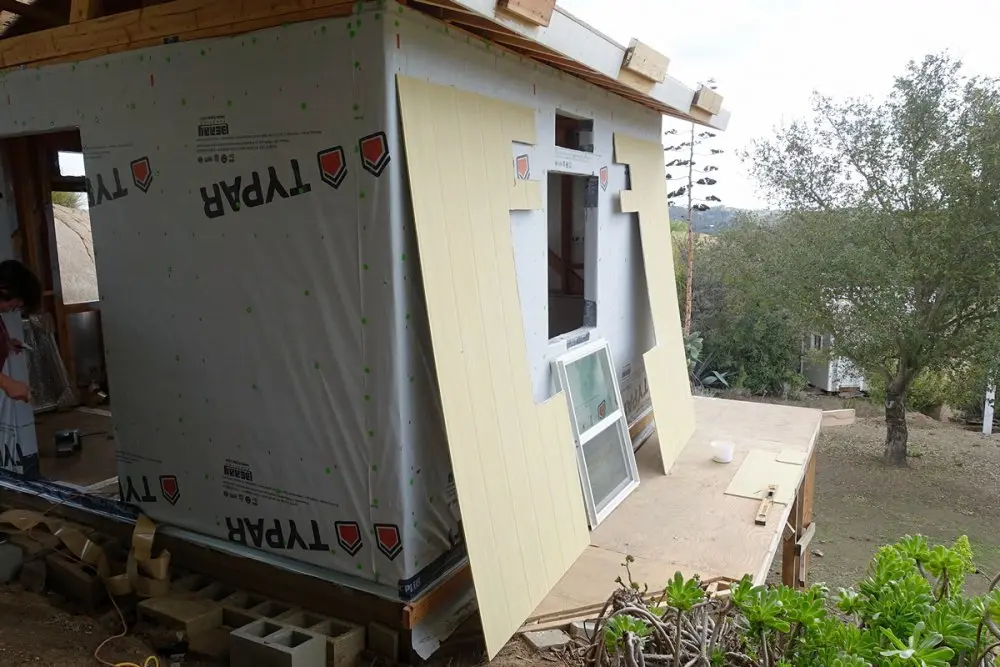

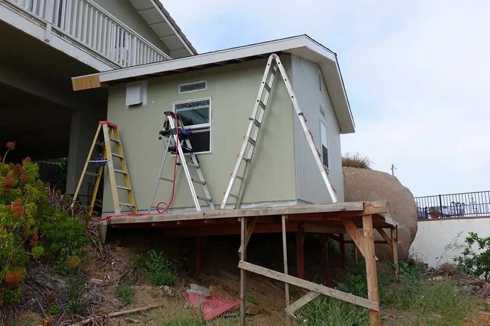

The exterior was nearing completion at this point.

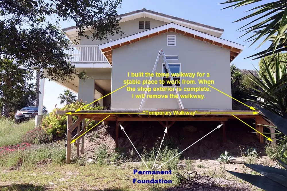

This shows the true benefit of the temporary walkway. It made working on the exterior both easier and safer.

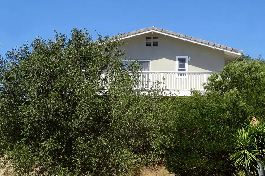

Just for the fun of it, here is what that bit of property looked like before I cleared it off for the shop.

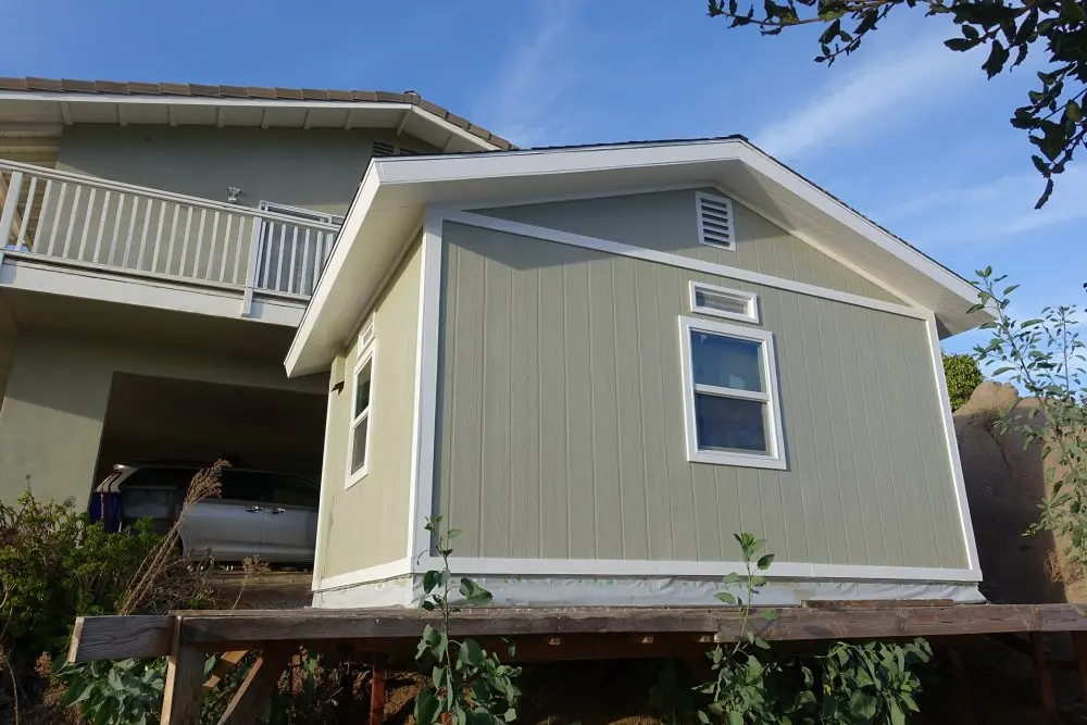

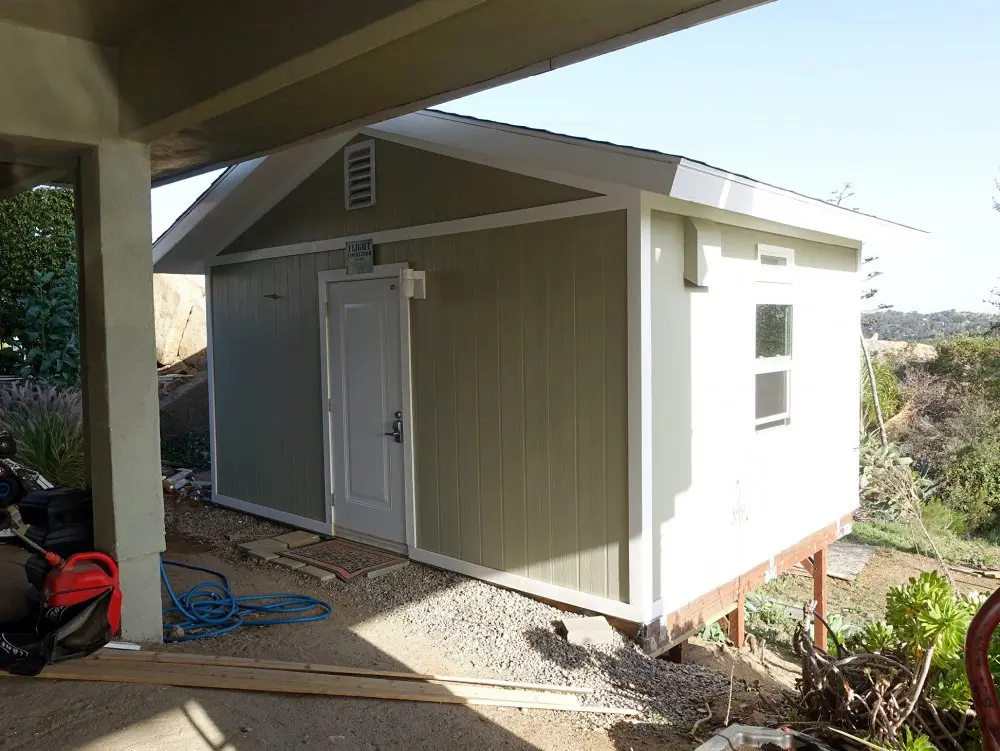

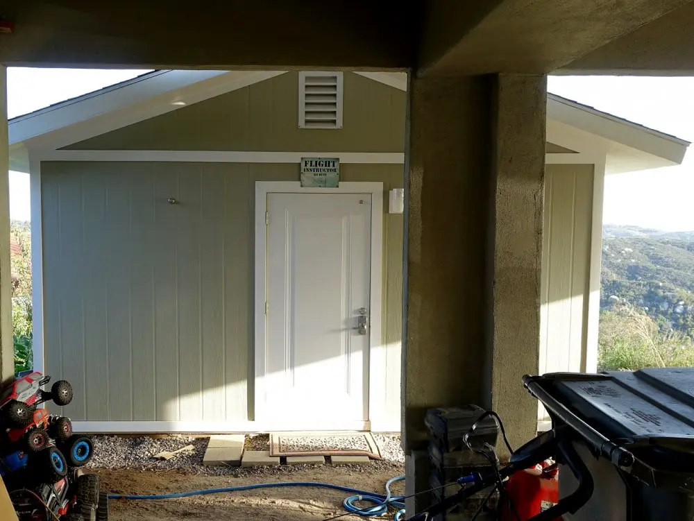

Exterior finally complete. Ready to remove temp walkway.

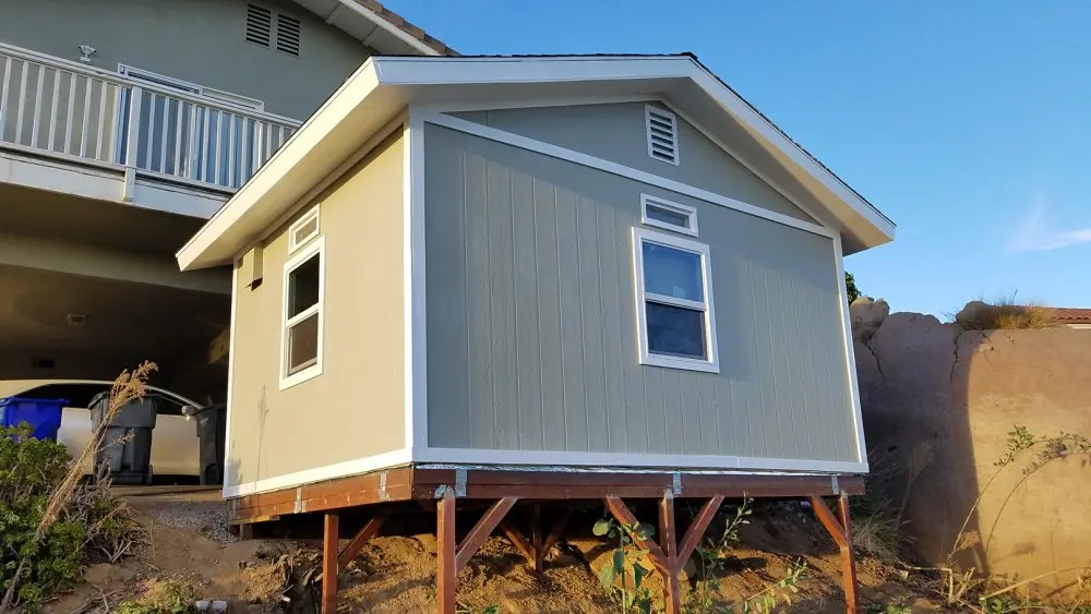

Walkway removed. Eventually, I will put a skirt around it, but that can come later.

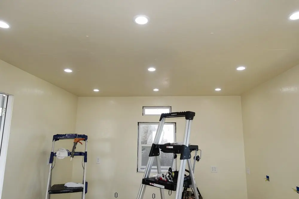

My eyes are not as young as they once were, so having good light is important for me to do detailed work. Therefore, I installed twelve 5-inch can lights. My wife originally tried to tell me that 4 was enough. Now she sees the light. Each of the cans holds a 60w-Equivalent A19 LED bulb in 5000K color.
I sure wish the floor paint would have stayed this glossy after it dried!

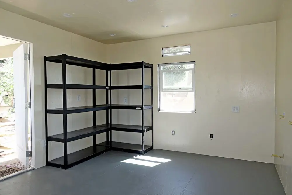

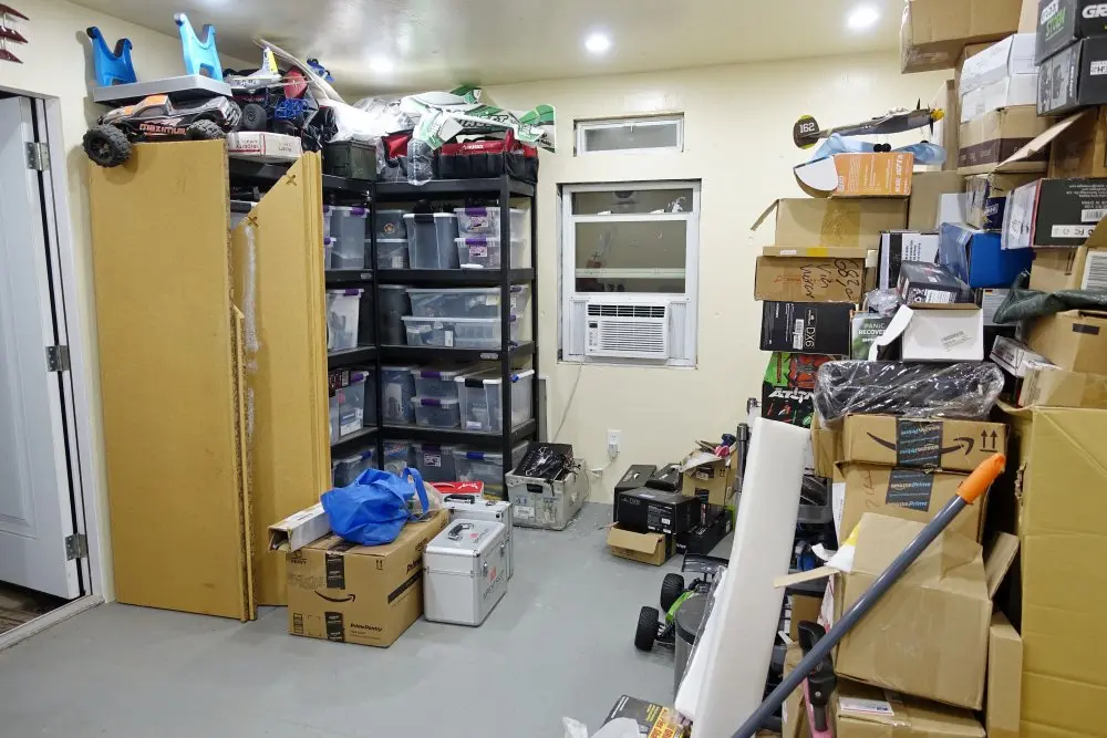

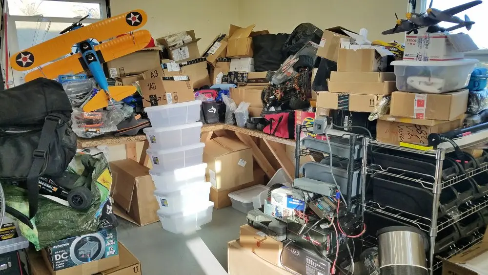

I never planned to move into the shop until it was complete. When wives are involved, husband's plans can be unexpectedly changed. She wanted my stuff out of the closet in the house. I just hauled it all to the shop and made piles knowing I'd have to move it a couple more times to finish the interior.

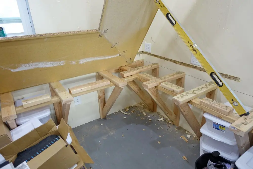

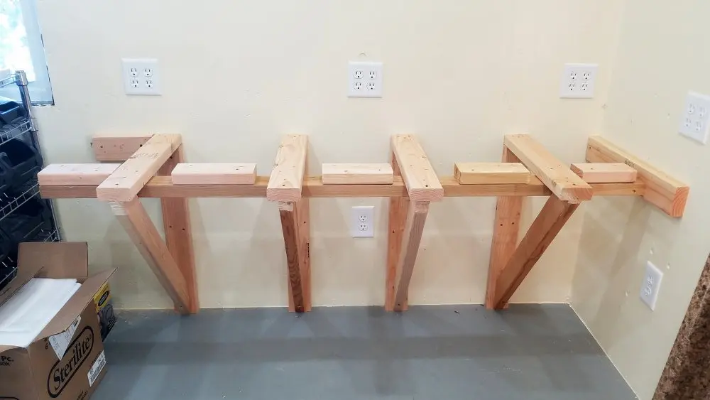

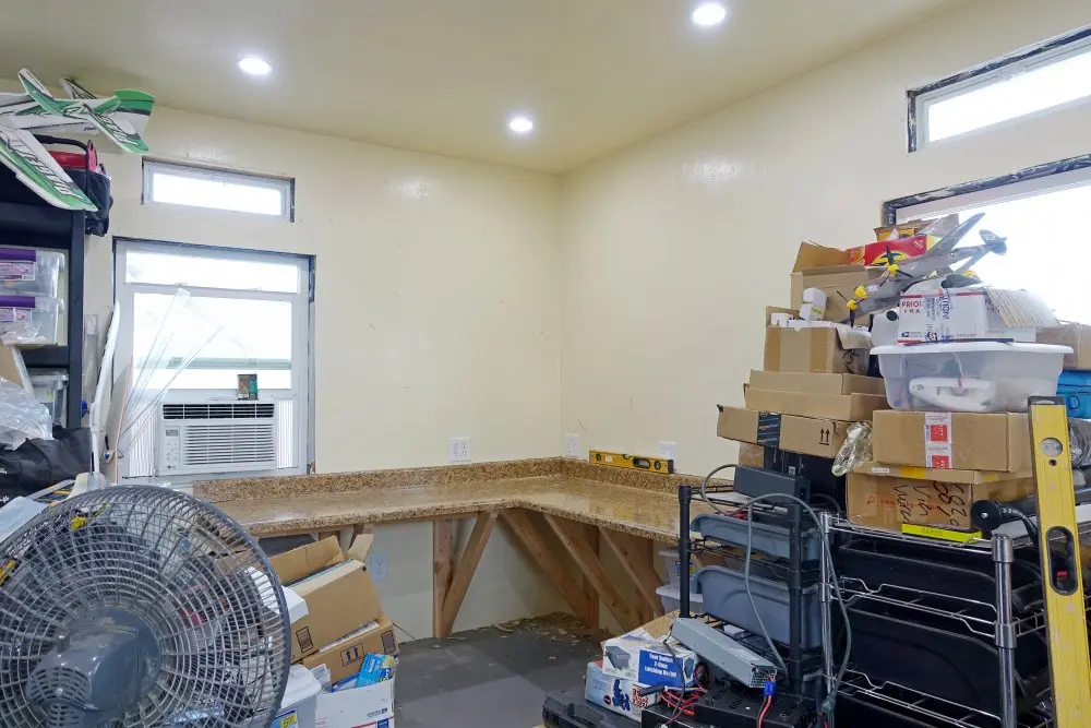

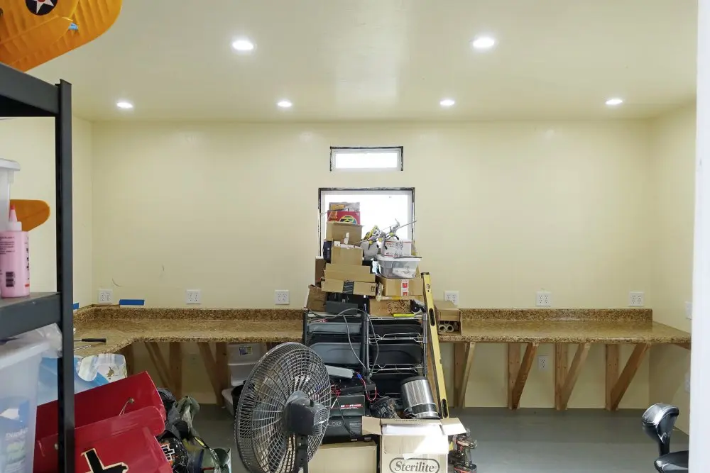

I wanted two workbenches, one for me and one for my grandson. Mine will be larger than his. In this picture, I have started the L-shaped corner unit for me. I wanted the workbenches to be extremly sturdy, but I did not want any vertical legs because they get in the way of a rolling chair. I decided on triangle supports made of 2x4's:
I glued and clamped the L-shaped formica top the day before. Now it's dry and ready to install with construction glue and a few strategic screws:

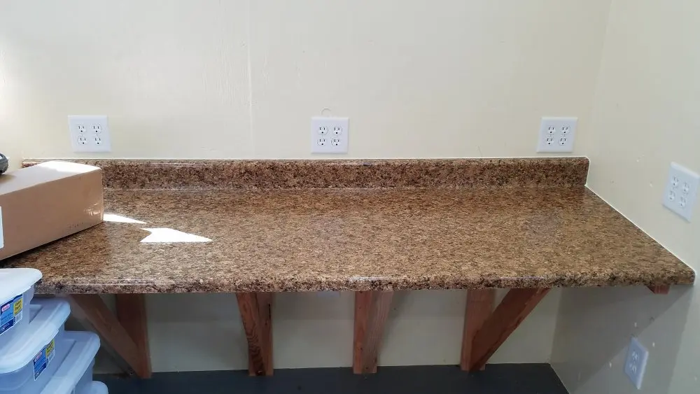

My workbench is all done:

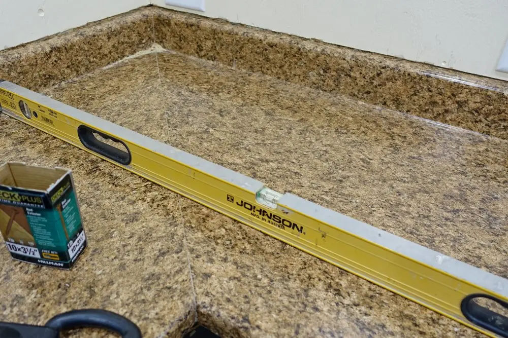

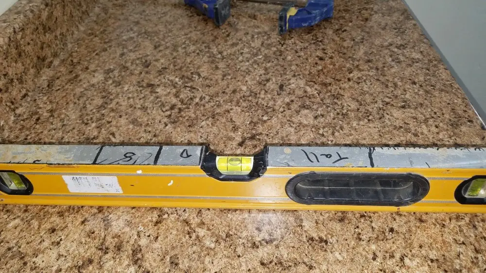

It is perfectly level in every direction which is important when building kit or scratch-built airplanes:
I had to cover my new workbench with all the stuff from the other corner so I could build my grandson's workbench:
Working on my grandson's workbench:
With both workbenches in place, I can now get on with the process of sorting everything to make sense of it all. I chose not to build drawers and cabinets under the workbenches because I prefer working with tubs that can easily be stacked or moved.

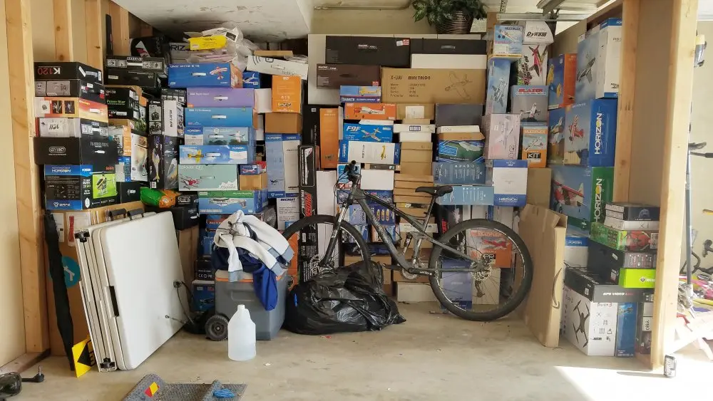

Now I guess I need to build a storage facility for my workshop. These are helicopters, quads and airplanes that are still in the garage because there is no room to store them in the shop. I did not plan ahead very well:
