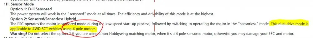

Also note:
https://cdn.shopify.com/s/files/1/0109/9702/files/User_Manual_XERUNXR10_ProG2en.pdf?92
Thanks for the reply Bill.. Customer support at Hobbywing was who said that it wasn't a good thing to pair the two.
I saw that in the manual... I'm not 100% up to speed on sensored vs sensorless mode. Does sensorless still boost timing etc.?
No, sensorless will not offer boost/timing advance from the ESC.
