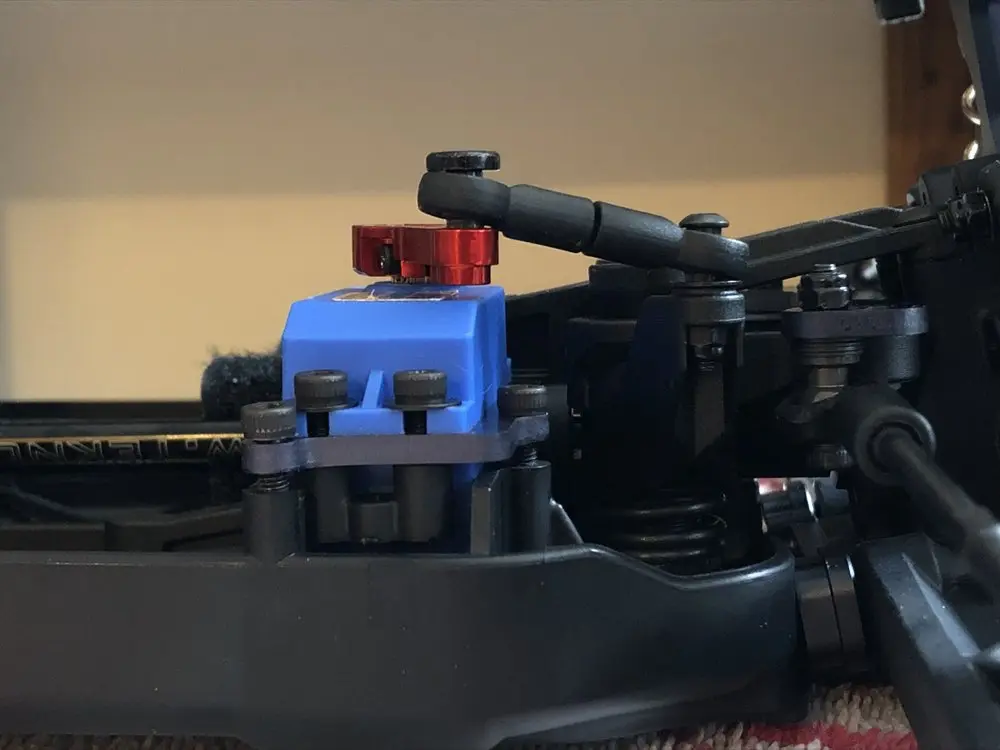

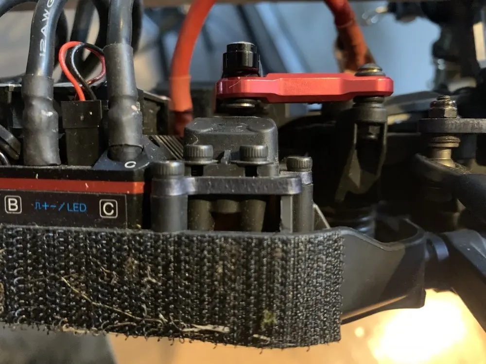

Why is my servo linkage at an angle? I need some help this doesn't look correct.

The plastic part shaped like a u is upside down, the screws of the servo mount aren't all the way in, your servo I'll go lower.
You drunk mate? Don't build drunk.
Servo arm type is also not ideal compared to tekno's

Yeah that is listed as a tall servo. I'm guessing that is the reason for this issue. A standard servo is 38mm tall and this servo is listed as 42.9mm tall. That's why you can't tighten the screws down anymore.
https://www.amainhobbies.com/savox-sw0231mg-tall-waterproof-metal-gear-digital-servo-sav-sw-0231mg/p262192?gclid=Cj0KCQiAjszhBRDgARIsAH8KgveYL-iF7FSQ2W_pNjv5nfjp8rTeKZwLg_iJG2mC_AGGrSgMNSpQNsIaAqOCEALw_wcB

Your servo mount looks bent now as well. I’d recommend replacing the servo with a stand one. If the mount is bent, be sure to flatten it back out.
