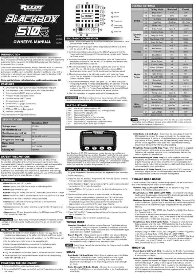

I did not double tap for reverse. I'm trying to get it back to factory setting but I think I need the program modular to do it. The manual says rebind/calibrate. I did everything and still not working. Maybe you can figure these instructions out.
page1image4066005360
Most esc's that are designed around racing in order to reverse you need to push trigger forward once for the break and then forward a second time for reverse. This is to make sure you don't accidentally reverse on a one way track.
