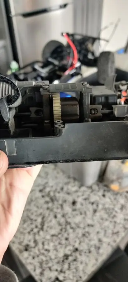

Hey everyone.
I just scored a great deal on a 48.4 used that I couldn't turn down.
I'm just going over everything (basically another winter rebuild project) and noticed the previous racer has a white spur gear.
Is this aftermarket or a hop up? I feel like I've seen a few photos on people's builds here but never really paid that much attention to it.

I believe some of the earlier kits had some white delrin bits. You might find the spacers in the lower shock cartridges to be white also and not have the center spacer between the o-rings.

Had a used rig with such a spear gear, never was a problem and is still running strong.

Tekno made replacement spur gears for the .3 and .4 series rigs that are not died black so they are that off white color. They aren’t made from a different material so they aren’t going to perform better or last longer. When I got my EB48.4, ET 48.3 and SCT410.3 kits a few years ago I picked a couple of them up in addition to some of the regular black ones to compare. The steel version is the only “upgrade” spur that I know of, but after running them on the EB and ET for a while, I went back to the plastic because they are so much quieter plus they last surprisingly long, even on 6s in the ET.
