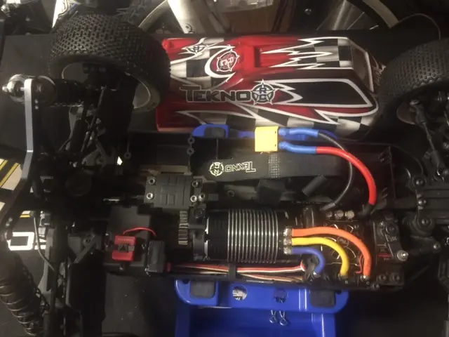

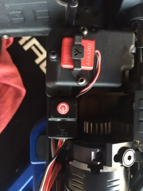

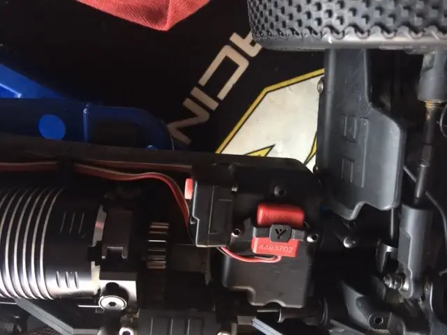

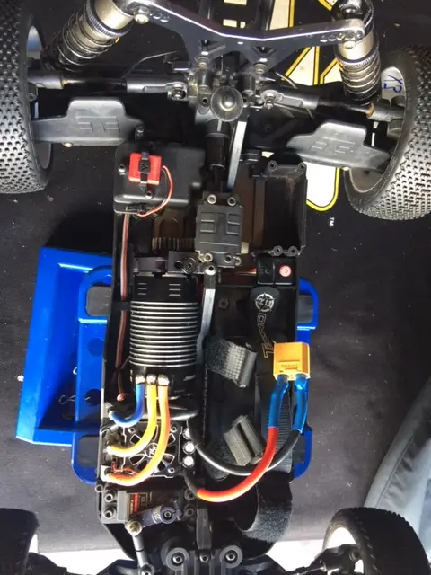

I installed a transponder and screwed it to the 3 holes on the receiver box. I had my on-off switch there so had to remove...now I am trying to figure out where the heck to place it. It can't fit right in front the box on the floor. I found 3 other possible locations (given the length of the wires)...all of them are not ideal. If you have pics of where you have your switch, please post...perhaps there is something I am missing. Thanks
I think the last pic secured to the receiver cover sideways seems like the best choice since it has the most surface to secure the switch with double sided mounting tape. Again, I am not able to place the switch flat on the floor as the motor mount is in the way.

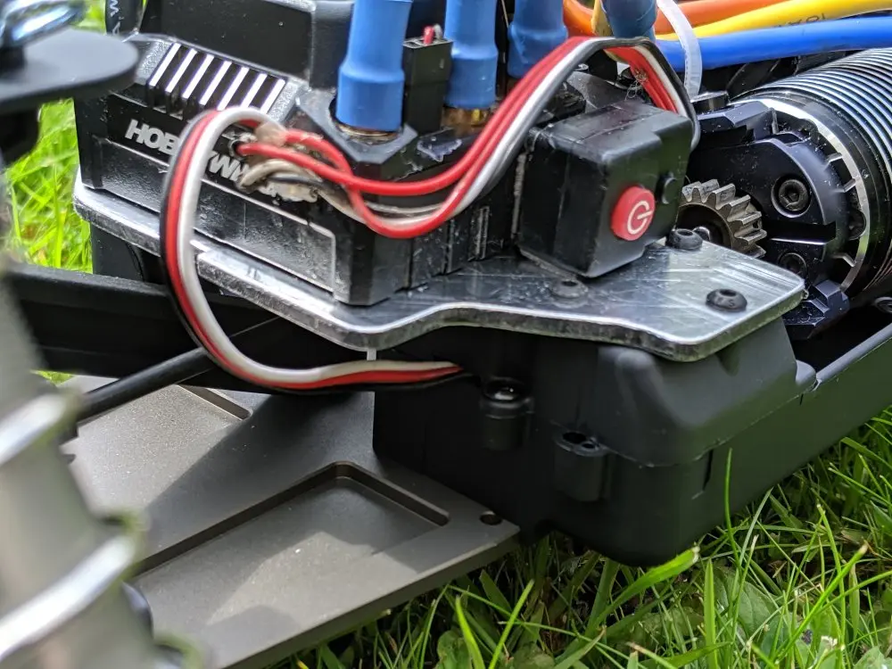

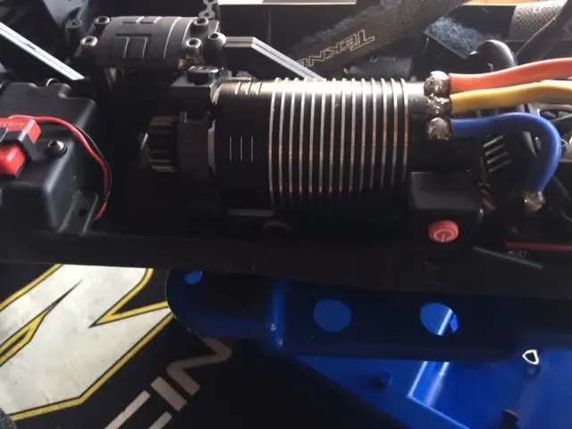

The switch on my Max8 is mounted on the side of the ESC with double sided foam on the bottom and side of the switch. It has been mounted like this for several months and is still secure.
Thanks for the pics. Nice to have so much space. I have EB48.3 and my esc sits on the opposite side of the motor so the wire length is also an issue. If if were a bit longer, I could have mounted it on the receiver cover next to the transponder. My transponder which is mounted to the 3 screws next to your switch.

I started a thread about this a while back...there a few good ideas posted here. https://www.teknoforums.com/threads/esc-switches-where-how-are-you-mounting-them.242/

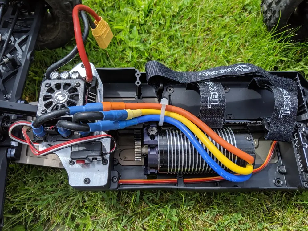

Appreciate the link...I really like the location of your switch next to the battery tray. My set up is similar to yours...I also have HW Xerun XR8 Plus esc with HW Xerun Gen2 2250kv motor. Great electronics but a bit on the large side. Where did you route the wire under the driveshaft?
I currently have it mounted with double sided mounting tape to the front side of the receiver cover. Wires are clean and secure, and it works, however it looks out of place i.e. doesn't belong there so it bugs me. Will try to get it where you placed your switch.

Yes the switch is ran under the motor and drive shaft. I have it secured with a dab of hot glue to be safe. The switch almost wedges itself in that space tight enough you can probably get away from using anything else but I did double sticky tape it down, again to be safe.

This ESC mount is cool as hell. How do you like that weight distribution? Having more weight in the rear compared to stock mounting location?

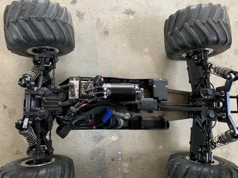

My Racer is without an ESC for the time being, but here's my custom monster truck. Currently, zip-tied to a lead. Not the most ideal place and I wouldn't recommend it. But it works. I'll move it one of these days. I like the mounting positions you guys have come up with.

Thanks for the input. Used Tbuggy's location which IMO is ideal...just need to lift the motor mount/center diff to route wire. It also clears any obstruction for the transponder to emit signal. I am a happy camper now. Let's go racing!
