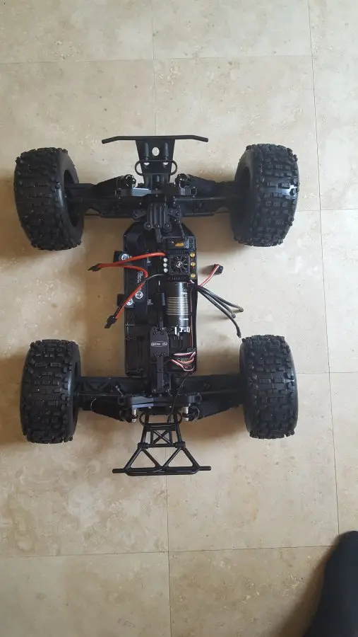

Finally finished the assembly and my front end is all jacked up looking, lol. What did I do wrong and how do I correct it?
Any help appreciated.

Did you set the front turnbuckles to the correct length as stated in the manual?
Also check that the grey steering rack is the right way round.
The front wheels should be slightly toe-ed out but not that much!
You used the right turnbuckle in the right place?

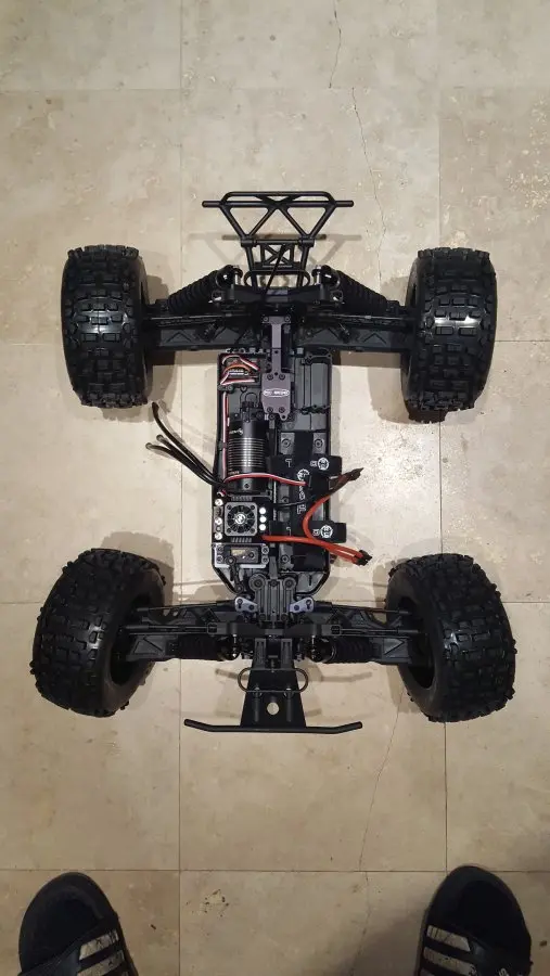

Yes, the turnbuckles were installed in the holes specified in the manual. I took off the camber links and turnbuckles to see what needed adjustment and got the bulk of the problem sorted out. The turnbuckles were the majority of the problem, so thank you for suggesting that. What is odd is the right side hub carrier doesn't sit at the same angle as the left one. It points somewhat down in comparison, so the tire on that side is angled so the outside is taking the majority of the weight, yet the right side sits as it should, completely flat. Oh well, it is about as good as I can get it for now.
Check that the inner end of the camber links are both attached to the correct hole on the shock tower. I believe it's bottom left?
The manual has the stock setting as being the upper outside hole and that is where mine are. I also have the correct hole for where they connect to the hub carrier. Really weird that one side is exactly where it should be and the other is slightly off. Oh well, I'm not going to stress over it unless it's all screwy once I get it running.

Maybe someone will be able to see what's wrong if you take a closer picture of the turnbuckles and hubs w/out the wheels attached.
Have you confirmed that your turnbuckles are all adjusted so that their corresponding link on the opposite side of truck (left and right) is the same length?
Do you have a set of calipers, if not this is a perfect time to get some. They will help you immensely when messing around with RC setups.
That's a great idea. All I did was line up the turnbuckles and camber links to the manual. Yesterday I saw I was not exact (both sides), so I made adjustments, but never compared each side to eachother. I did one side at a time, amd ended up doing it twice on the right side since it was still wonky. Thanks for the tip.

Its all in your steering and camber link turnbuckle seting... Ad others im sure have said. All of the Tekno rigs ive built came out perfect making them to the exact length in the manual...
