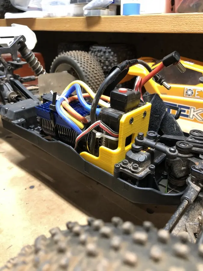

Hi All. After a crash and long wait for parts, I'm back in action and have results. I got the Hobbywing Max8 ESC and Hobbystar 4082 1600kv motor. Due to the motor being longer, the ESC wouldn't fit so I had to 3D print a custom bracket to stand the ESC on end. Everything fits fine now. I also put a extra heat sink on that I had laying around. My testing confirms klappers setup of a 17T tooth for hard grass running. Below are the results. I couldn't find definite temp specs on the motor, but I think 185-ish is on the verge of being to hot. The 17T's temp of 160F should keep the motor's temp in a good range.
