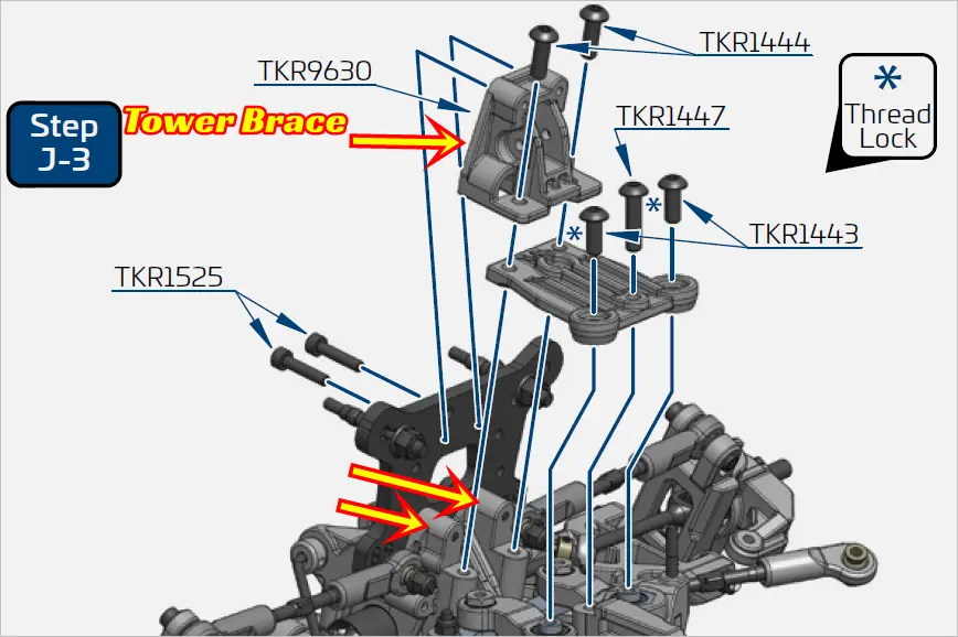

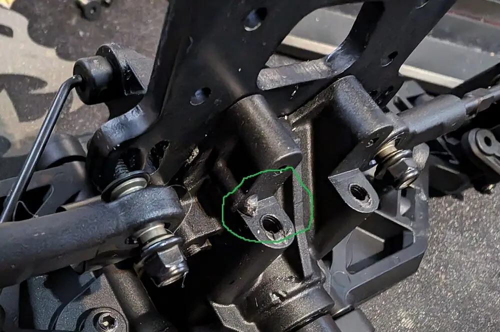

Yeah, I'll probably get roasted for this post, but Step J-3 was the most frustrating thing I've had to go through on any kit. Getting the front shock tower brace to line up/fit onto the gearbox was just awful. It was like the tower brace mold didn't match up to the gearbox's two "humps" (pointed out below).
I didn't take pictures of the "before" gap that was there. I took the thing apart ten times while saying to myself, "What the heck am I doing wrong?" After using lots of hand strength, thumb pushing, and drawing things together with the two TKR1444 M4x12mm Button Head Screws. I was finally able to secure the brace on. Is it on correctly? I don't know, and I'm not taking it apart again. I do know all the screws lined up, but there had to be some give on the part of the brace.

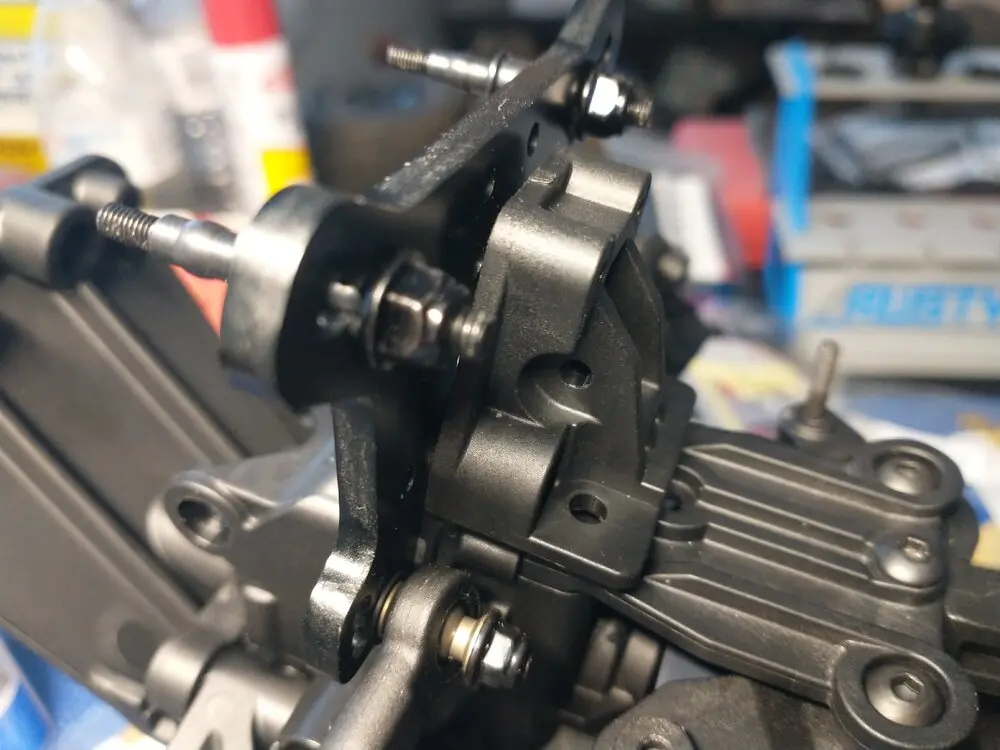

You wouldn't believe what I went through before I almost gave up. I treat builds just like changing a wheel/tire on an automobile. I always keep front/rear assemblies barely snug/loose, 'cause I know all too well it may take a little nudge for that perfect alignment before I begin tightening down things little by little... drawing everything together.

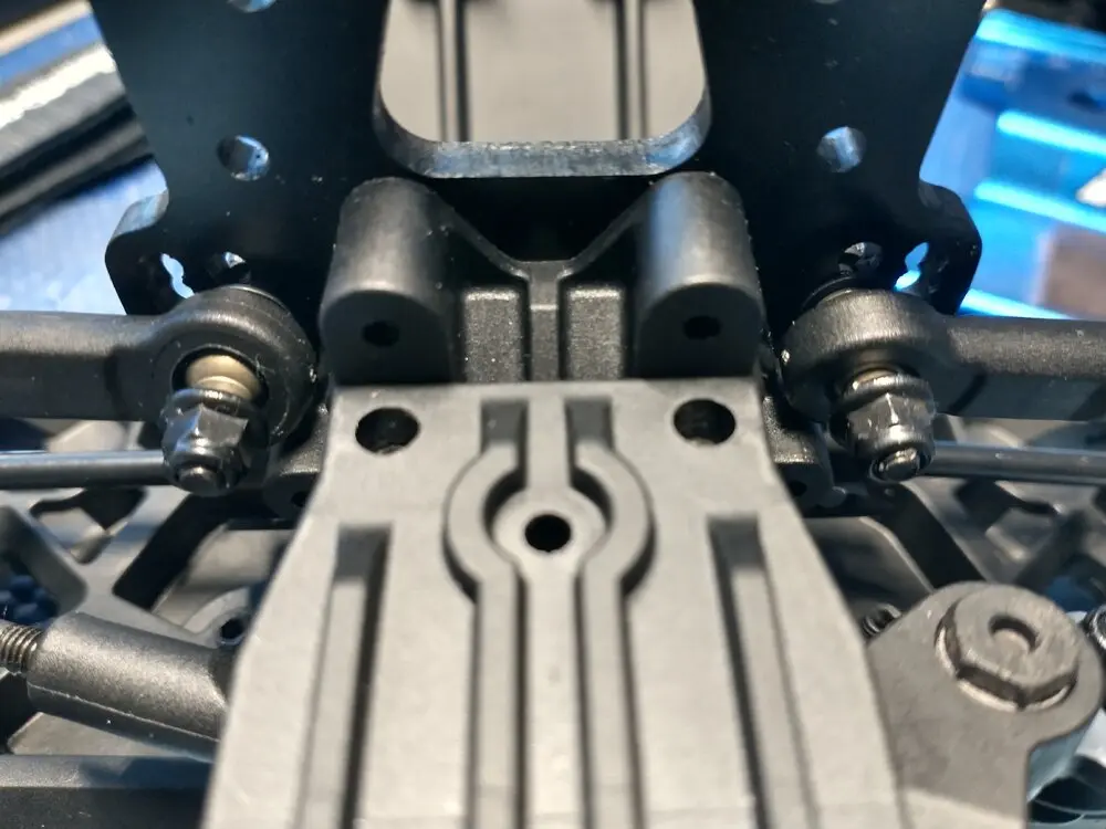

Everything is keyed to fit another part....

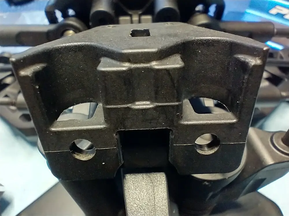

Taking all the pressure off of the part, and I was left with this...
Carefully applying lots of force, I was able to line screw holes up with shock tower, and top plate while tightening things down.
It truly was a square block into a round hole moment.

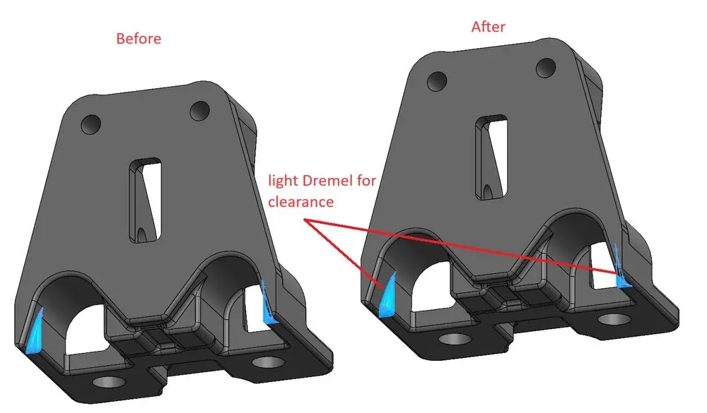

That front brace will have a running change done to it. When the brace was originally made it was designed around the big diff bulkheads on the EB/NB/ET/NT. When we made the decision to use the medium sized diffs from the previous generation of cars, we had to make new bulkheads. Those new bulkheads had a little more material in one spot that caused interference that we didn't catch. You can simply dremel or sand 2 spots on the brace and it will fit on without any issues.
Thanks for the clarification, and rendering on that part. I was loosing my mind. It's together now, but I will Dremel the brace at some point.

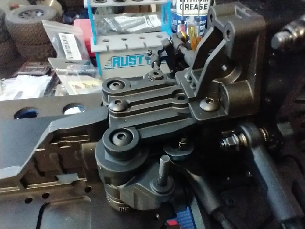

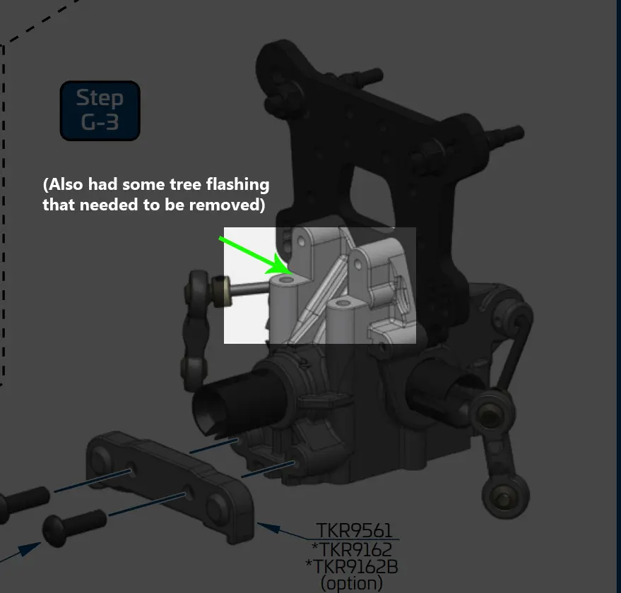

Just finish building and ran into this also I found the key is what order you attach the bolts. When I figured this out it went on like butter.
I also had some flashing

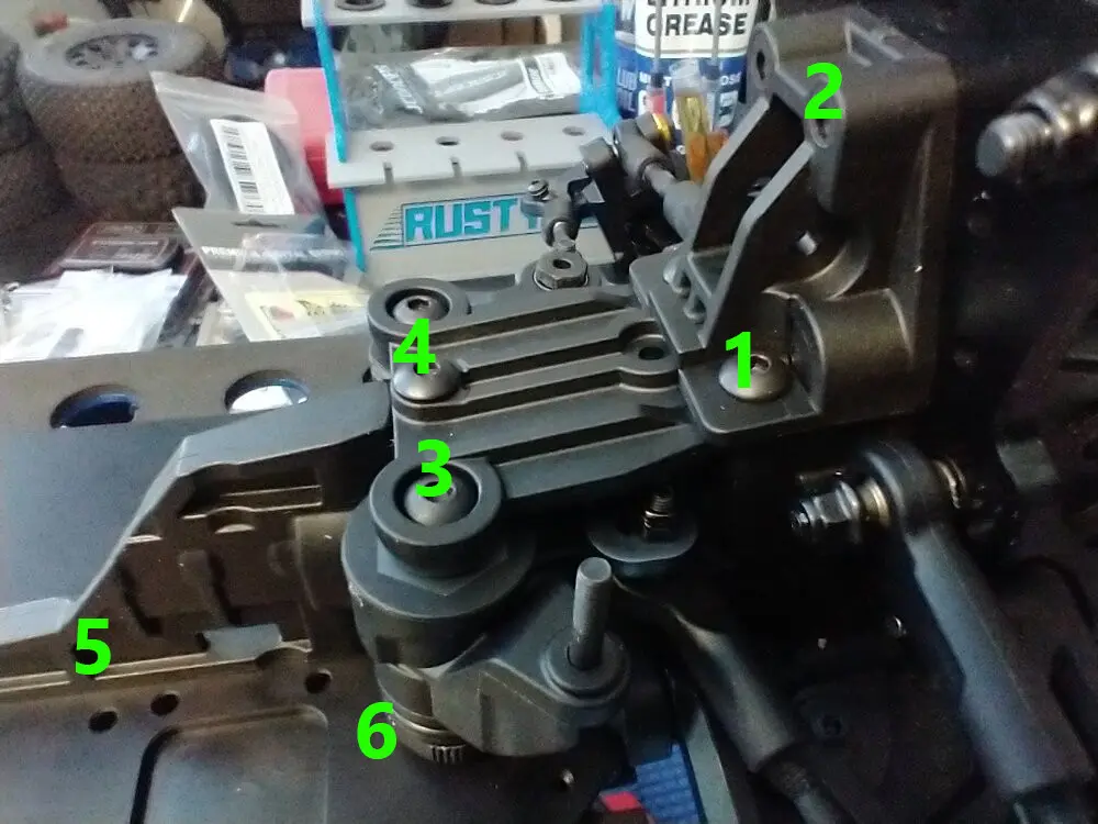

1- Remove the lower brace and #5, #4, #3 and #2 screws
2- #6 screws stays but loosen to allow for movement
3- Tighten down screws in this order - #1x2 -> #2x2 (making sure the two plates are mated and seated) -> #3*x2, #4, #5 and then #6*
* Dont forget the Loctite
This is the order I used and went together really easy
