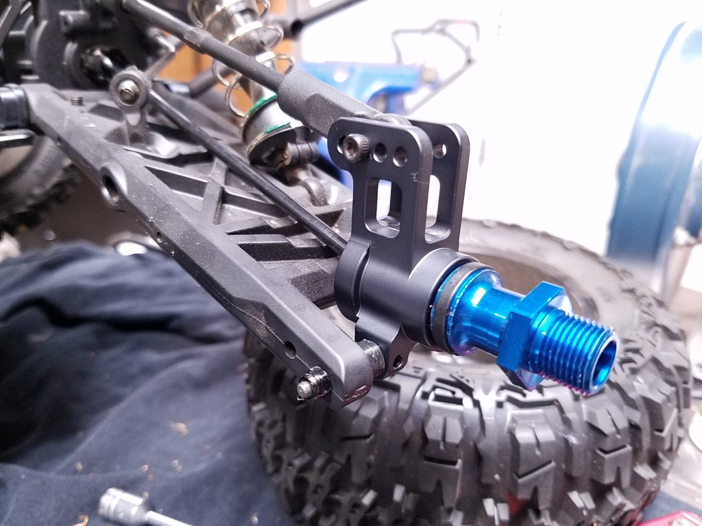

one thing to consider, these wheels have a narrower offset that makes them set inward more than a normal wheel, so to avoid rubbing on the body when turning (depending on body) you might need to use extended wheel hexes to push the wheels out a bit.

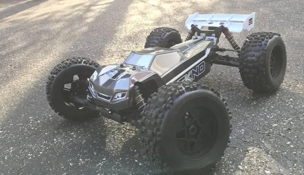

Don’t get Badlands, go with DBoot Backflips. I love em.

I’m not too sure but they do have some weight to them. I know my ET even with the Backflips is still lighter than my stock Kraton if that helps any.

I think they are pretty tough. They are a firmer and possibly thicker rubber than the Badlands. I haven’t personally used the Badlands but I have had them in my hands at my LHS and I can say they are firmer.
I run a mix of off-road and on road and they have been holding up well. They sound pretty good on road too....like a 4 wheeler lol
Also, I think they have the perfect amount of bite...enough to hook up and launch but enough to kinda slide on a turn....even in grass. The sidewall is tall and relatively stiff and holds its edge on turns. They really compliment the ET’s suspension.

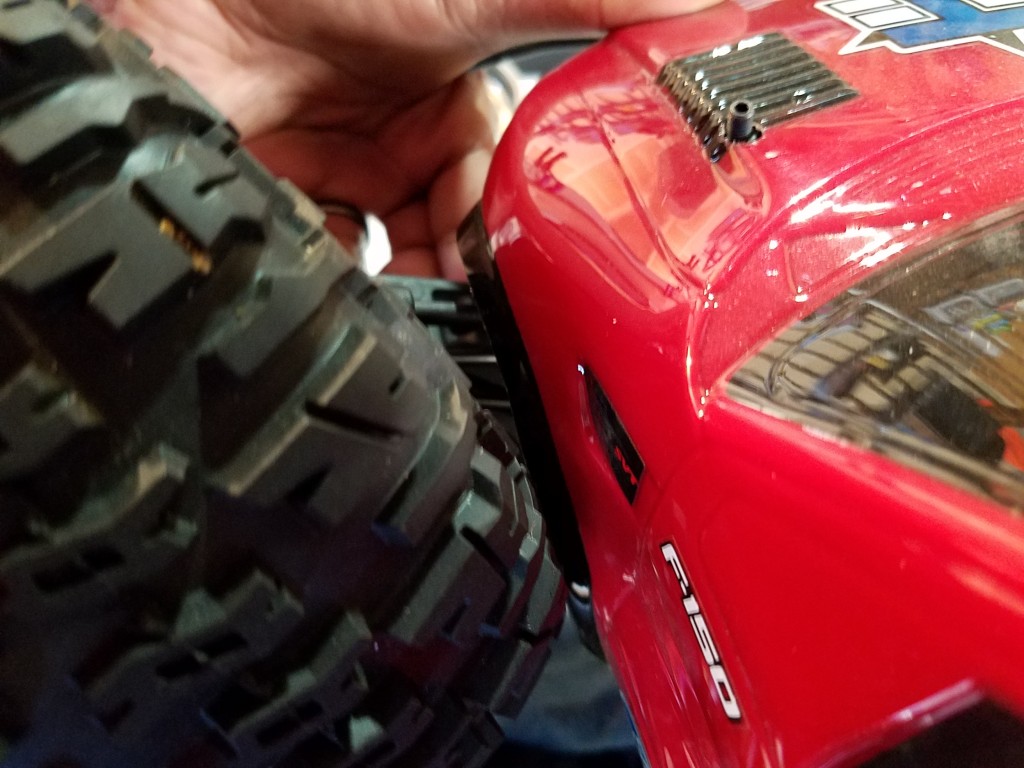

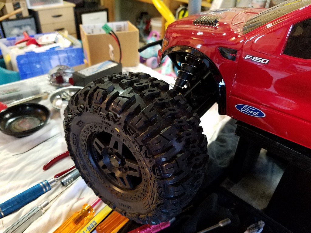

I was also liking the narrower track, I was bummed to find that it rubbed on the body. Pretty much had to go with the wide ones i think. I'd suggest just getting wheels with a decent offset. I'll take a pic how close it is at full turn.

Even with the extenders it rubs slightly but only at compressed suspension and on the back side.
Thanks for the pics. It's not that bad with the extender
