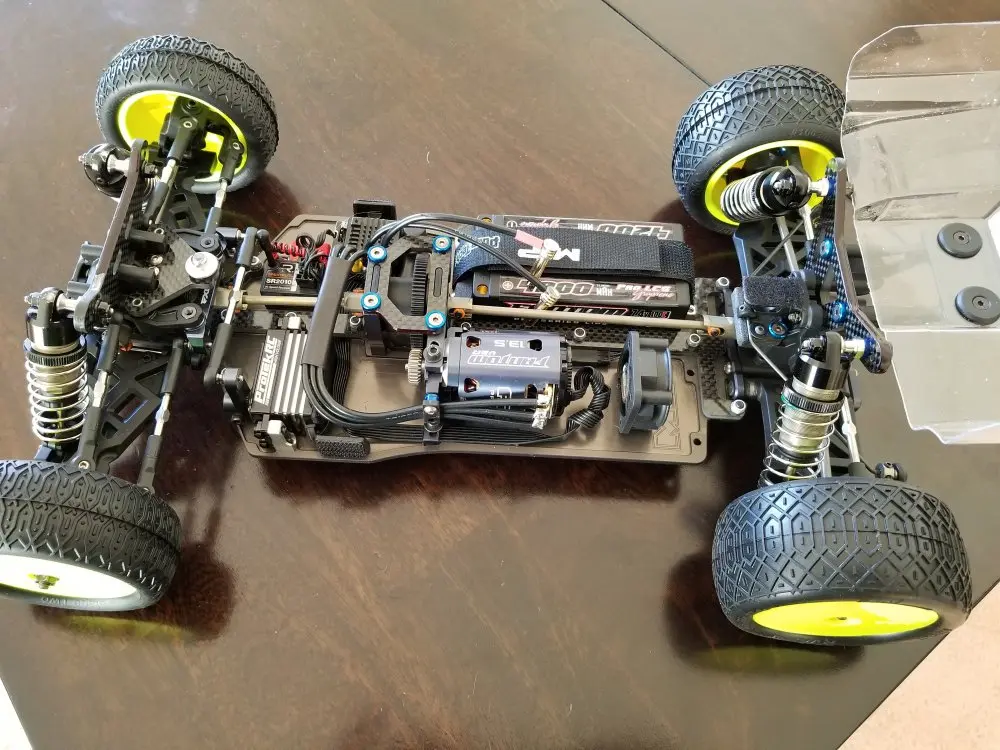

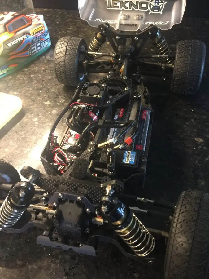

I'll be the first to show how to blow an obscene amount of money on 1 car lol.
List of Mods:
MIP chassis, aluminum shock caps,carbon front and rear tower, titanium turnbuckles, titanium screws, exotek steering rack, composite diff gears, full speed secret bearing set, exotek titanium hing pins, exotek rear hubs, aluminum stub axles front and rear, titanium shock standoffs. Not mods but have front and rear seat bar sets and every available spring for it. For my stk chassis I have the puck kit and carbon fan mount and top plate.

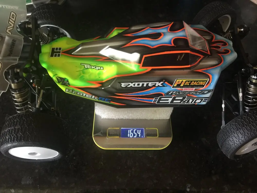

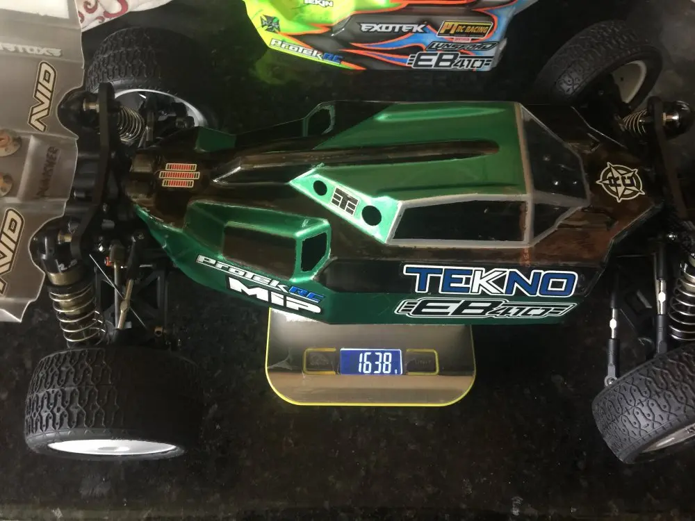

My clay runner:
Protek Titanium screws through out (except the lower chassis screws in rear...I wanted the weight down low back there)
Protek aluminum servo horn (lighter than tekno)
Protek aluminum spacers
T-works Titanium ball studs
Lunsford Titanium shock stand offs
Lunsford Titanium turnbuckles
Exotek titanium wing buttons
Exotek rear hubs
Exotek rear steel "D" block (13g)
Exotek chassis weight (using 40g)
Tekno cabon fiber top plates; center and front
Tekno carbon fiber shock towers
Tekno composite gears
Tekno +1mm hexes
Tekno lite weight body
Tekno Delrin pistons (front 1.7mm and back 2.0mm)
Tekno Aluminum shock caps
TLR shock limiters (using small spacers to accomplish the same thing MIP shock cartridge set does)
Avid carbon fiber battery strap and aluminum thumb screw
MIP puck system
Mattox designs indoor chassis protector
Avid bearings
Homemade lexan wing riser
PT diff and shock oils
Running Tekin Spec R 13.5/ Gen2 RS (Swapped ESC for Tekin RS pro BE)
Protek 130t servo
Powered by Team Orion 3800mah shorties
With the lite weight body its a lean 1638g RTR.
Haven't installed my tini shock shafts yet. Probably wont until I need to either.
Had the Exotek spool installed but took out after installing composite gears to be safe. I like it with the center diff back in better now anyways. Also removed the front sway bar...liking the way I can carry out of a corner after removing it again.

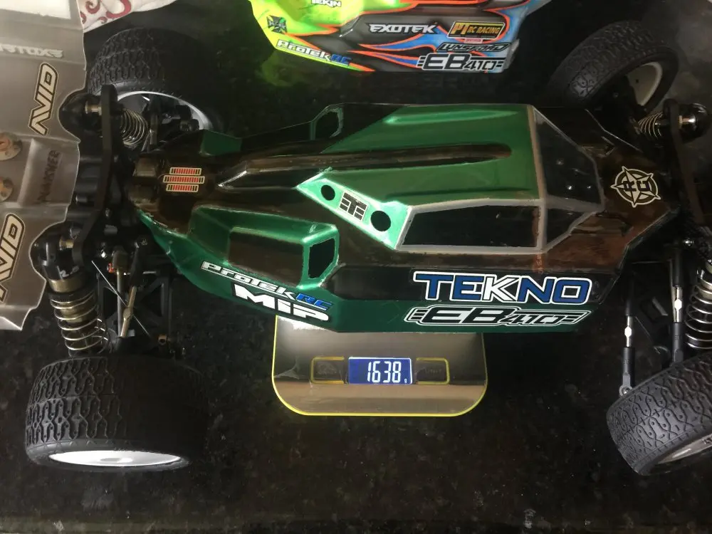

My clay runner:
Protek Titanium screws through out (except the lower chassis screw in rear...I wanted the weight there down low back there)
Exotek rear hubs
Tekno +1mm hexes
MIP puck system
Avid bearings
Protek 130t servo
Nice looking setup you have there. Running the lp battery what did you use to take up the space between the battery and battery strap?
It was just some stiffer (but still squishy) foam I had laying around. I believe it may have come from a castle motor packaging.
I'll have to look to see what I have, i was thinking of servo taping mine in but i really dont like playing with fire like that lol.
The foam is adhereded to the battery strap, but doesn't need to be. I used an edge banding tape designed for cabinets LOL;). Then there is an even stiffer foam that is wedged in front of the battery that is removable.

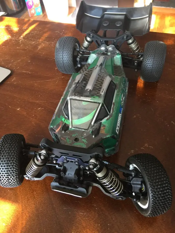

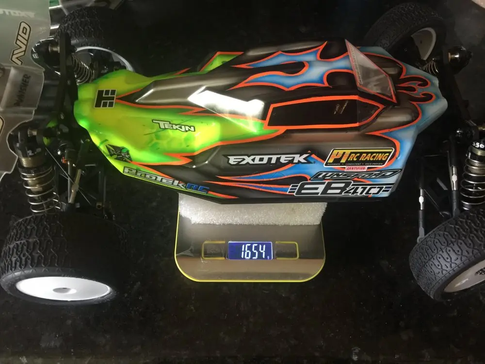

Here is my other EB410...(I am a little annoyed with my paint job, seems its all flaking off)
Parts list:
Tekno servo horn
Tekno carbon fiber top plates; center and front
Tekno aluminum +1mm hexes
Exotek front camber plate
Exotek "B" block
Exotek steel "D" block
Avid bearings
Homemade SS front and rear skid plates
Mattox design chassis protector
SWorks wing
Running Team Orion Vortex Ultimate stock 13.5/Vortex R10 (160amp) (swapped ESC for the tekin RS Gen 2)
Savox 1258TG servo
Yeah Racing fan
Powered by SMC 4600 or Team Orion 5000

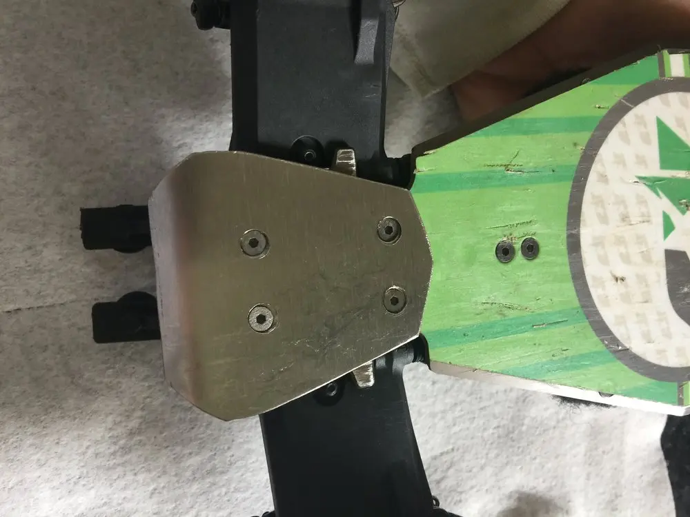

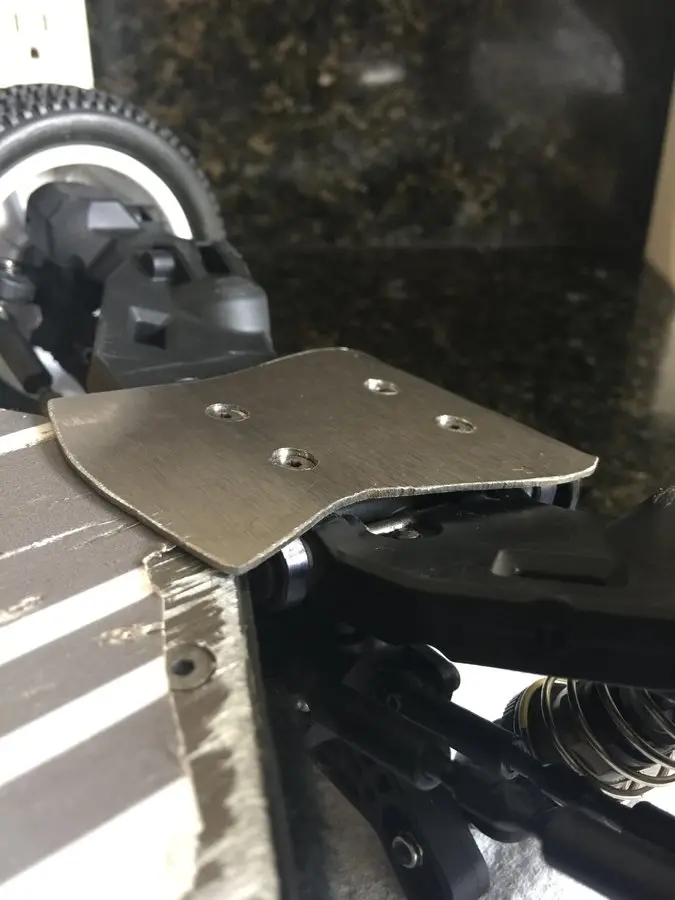

Pics of the skid plates:

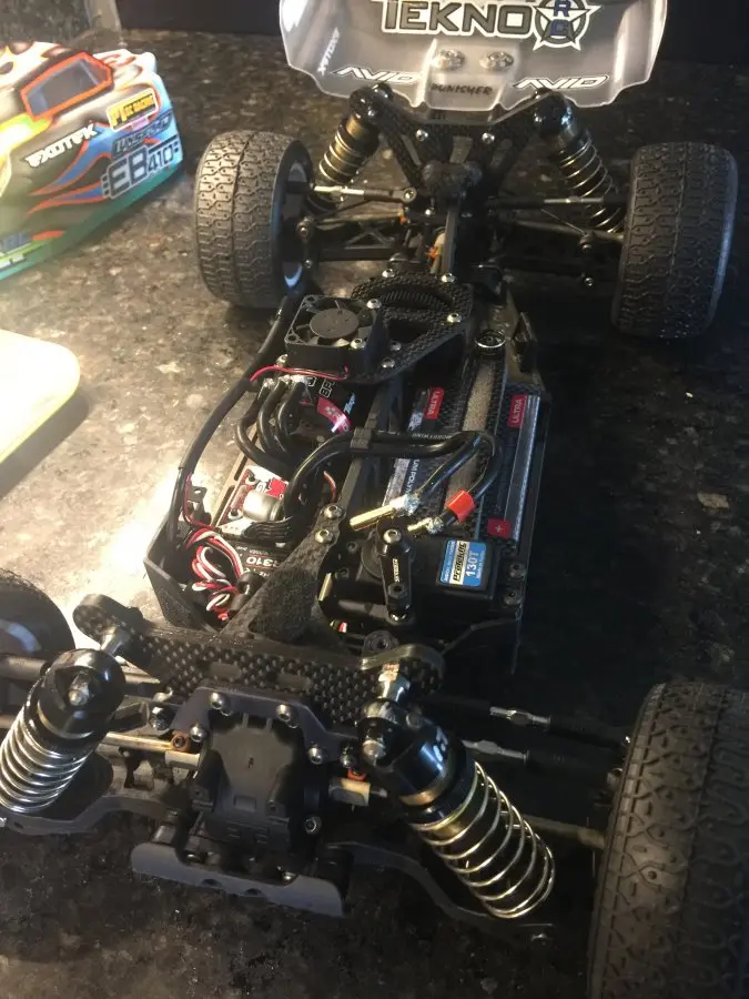

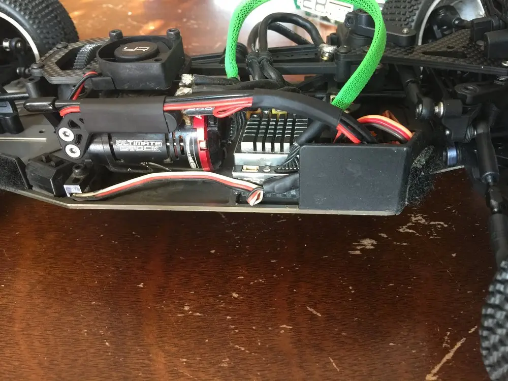

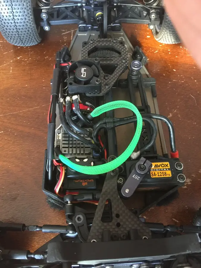

Convenient way I found to run the fan wiring and to secure the antenna under the body.

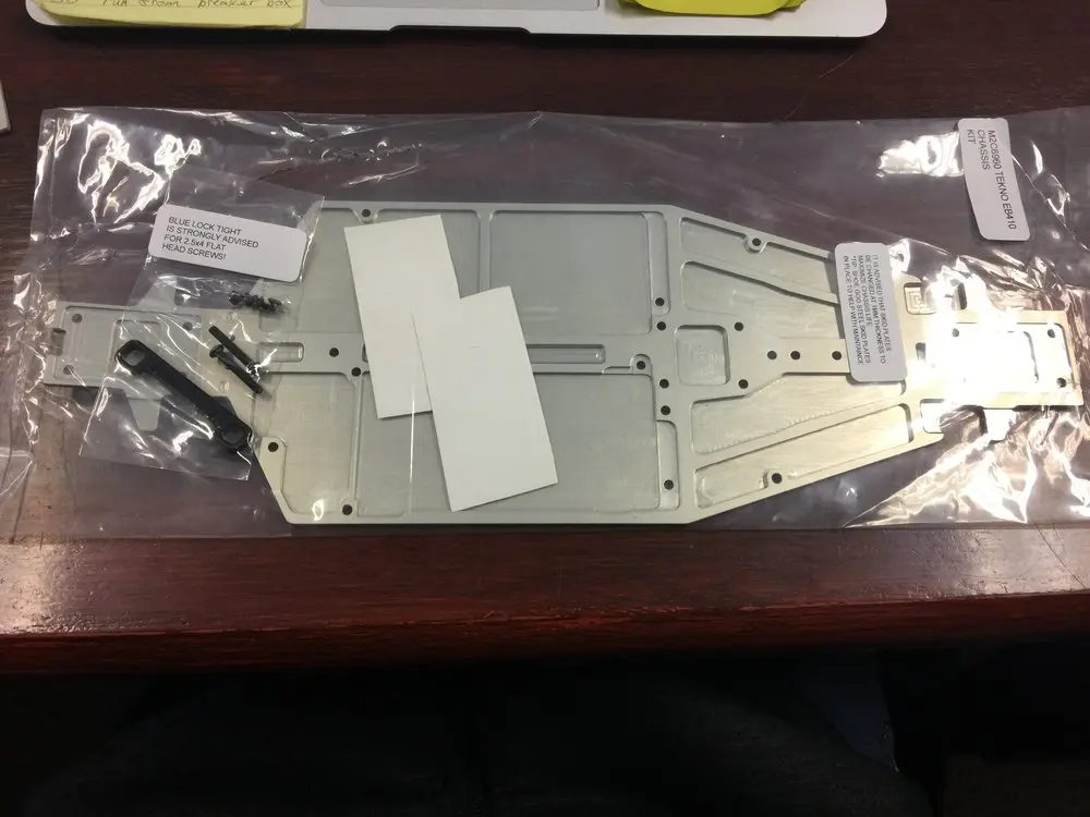

Uninstalled M2C chassis (for once the stock one wears out)
@TBuggy your buggy looks pretty nice and I like your homemade skis plates. What did you use to paint your body with? What did you all do for prep work for the paint?
I used Tamiya brand paint for lexan. I almost wonder if it had something to do with the cans being older? I have painted a couple bodies with this paint already and all of them are holding up nicely and are way older. As for prep I wash with dish soap lightly rub down with a scotch bite pad.
Yeah it could be the old cans. I use 150 grit sandpaper and then wash with dish soap and have had good luck with Tamiya too.
