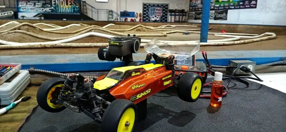

As luck will have it I recently raced my 401R at SDRC a few weeks ago on vacation to SoCal and even though the car has collected dust for the past 18 months, it's still very competitive with all the local fast guys, here's my race results with the 401R:
https://sdrc.liverc.com/results/?p=view_race_result&id=3902059
It's worth noting that I'm running a 2019 release of the kit and they recently updated a 2022 version of the 401R earlier this year.
