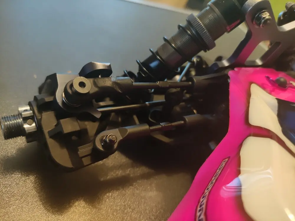

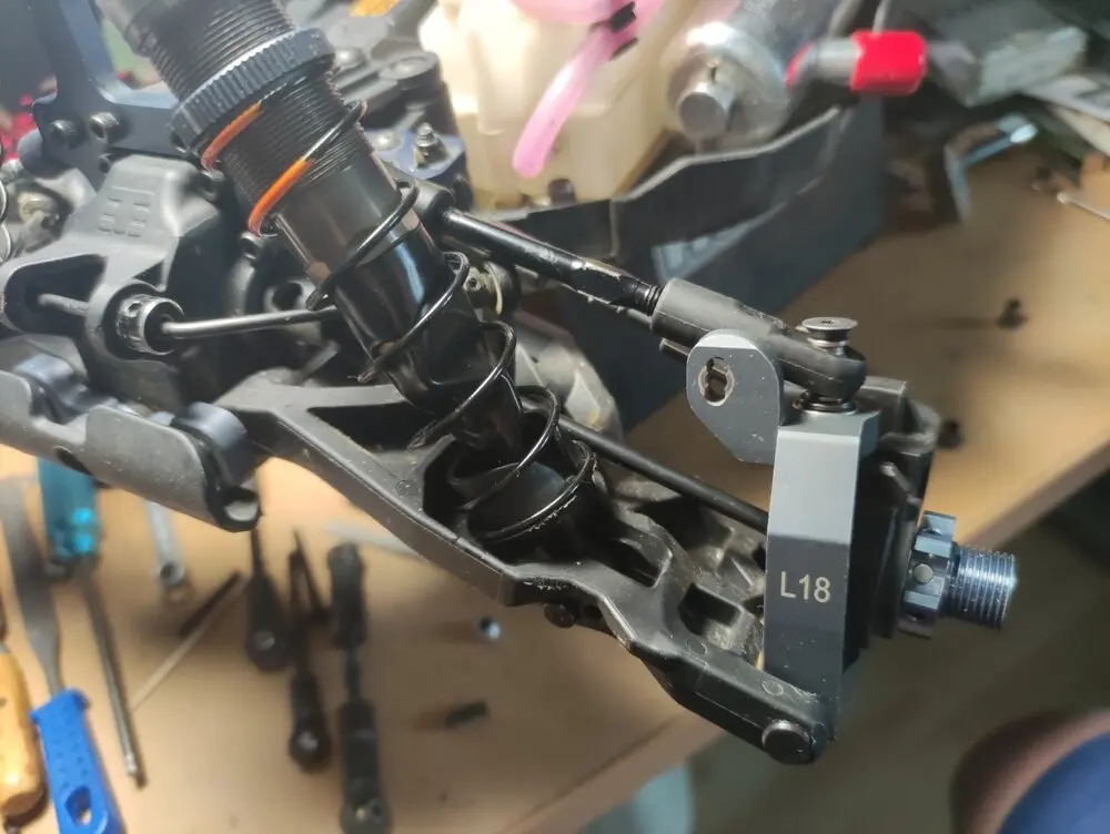

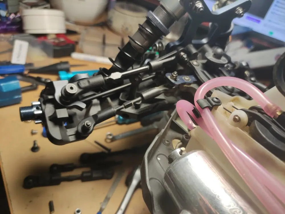

i actually did my own, for the buggy i used
TKR9050 buggy rear turnbuckles..(first i had some random xray 808 ones from the old parts box)
the inner plastic is wich comes with the kit´s as option for more droop
xray 353152 is the outer plastic ball joint i used.
the balls itself i used old odonnell ones and driled them 4mm for m4 screw, but i think tekno or xray balls could work also.
the bearings in the hub are stock and i think i used JQ steering bushings wich i filed down a bit to fit into the bearing. just beacuse they had the perfect lenght allready. i think a lot of 1/8 steering bushings have the possibility to fit if you shorten and/or thin them with a file.
then i just bought the m4 screws in correct lenght. in my case 22mm as far as i remember.
it works perfectly fine and the rims just slightly rub if you run full droop sometimes, not an issue. have to replace the xray outer plastics at some point.. but on mine i allready ran like 3gallons and they look worse on the pictures than they really are.
so this was my europe way to avoid high import costs and missing stock of the thornhill mod.
for me it was not expensive because i had a lot of those parts laying around in the parts "graveyard"

well i can only talk for the buggy. but for me it just calmed the front end down in initial steering response, but i can still run dremeled c-hubs and removed steering stop screw and it is still very easy to manage the front end.
for my driving style i can push the car much harder in corners without loosing front end grip.
so i got a ton of steering because of the dremeled c-hubs and removed stop screw, but it is very easy to control the steering because it feels calmer
