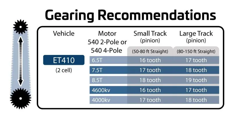

Tekno ET410 Gearing Recommendations:

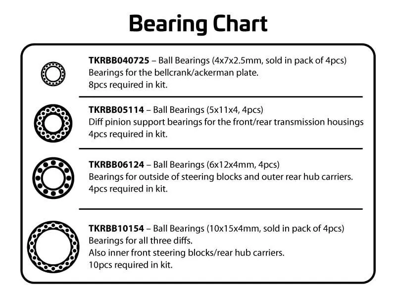

Tekno RC ET410 Bearing Chart
