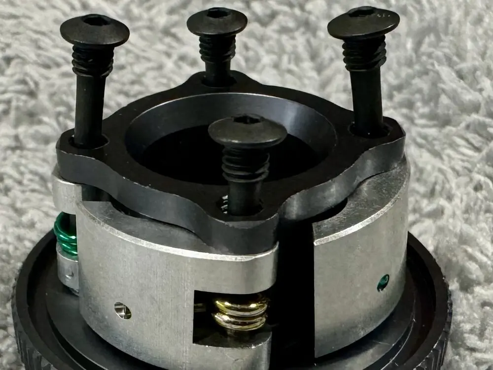

HELP PLS: Stuck on this step as I cannot line up the screw that installs the clutch and spring together....
I've been working on this for 3 hours.. Not sure if the factory springs are too stiff, or there are missing holes on the flywheel for springs to seat.. Please help.
Ensure the wings are orientated correctly, with color pairs opposite each other. Insert one pin at a time. It is fidgety as I had to fight a little to get them in, but they do eventually go. Just make sure they are lined up correctly.....

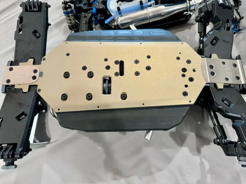

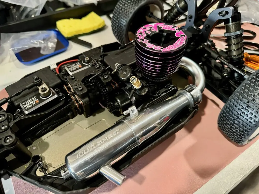

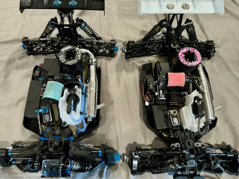

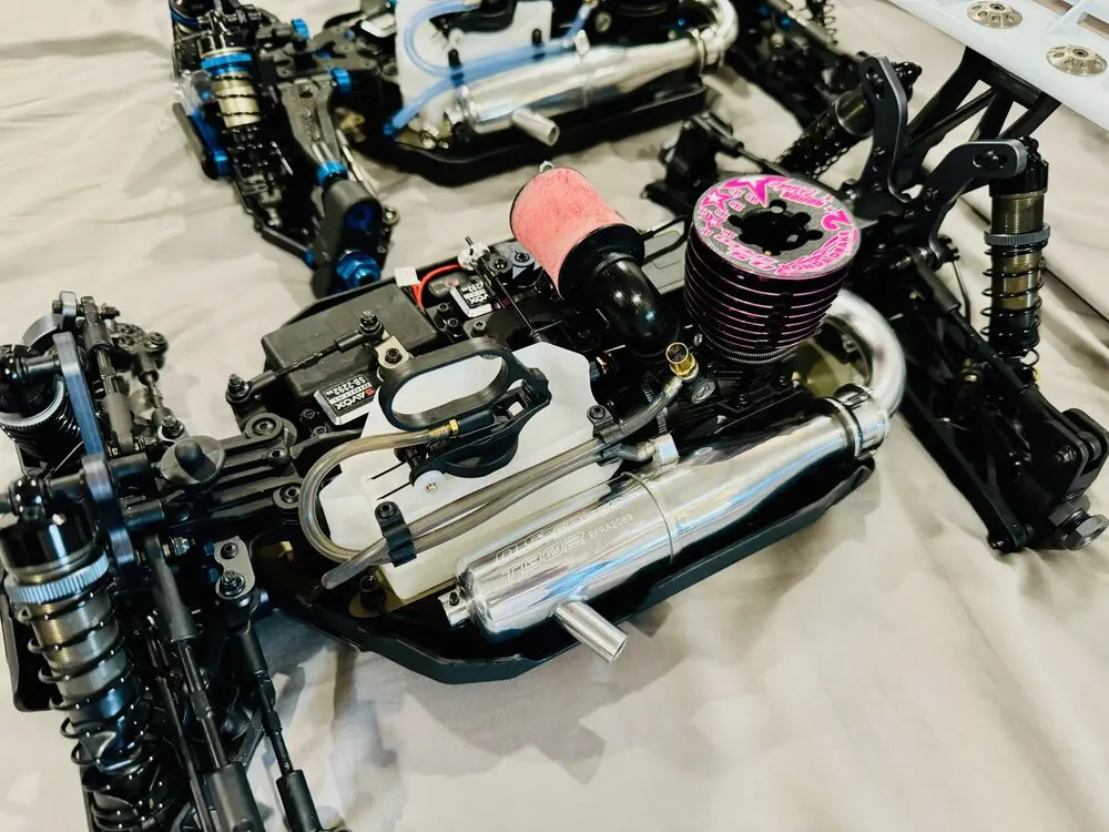

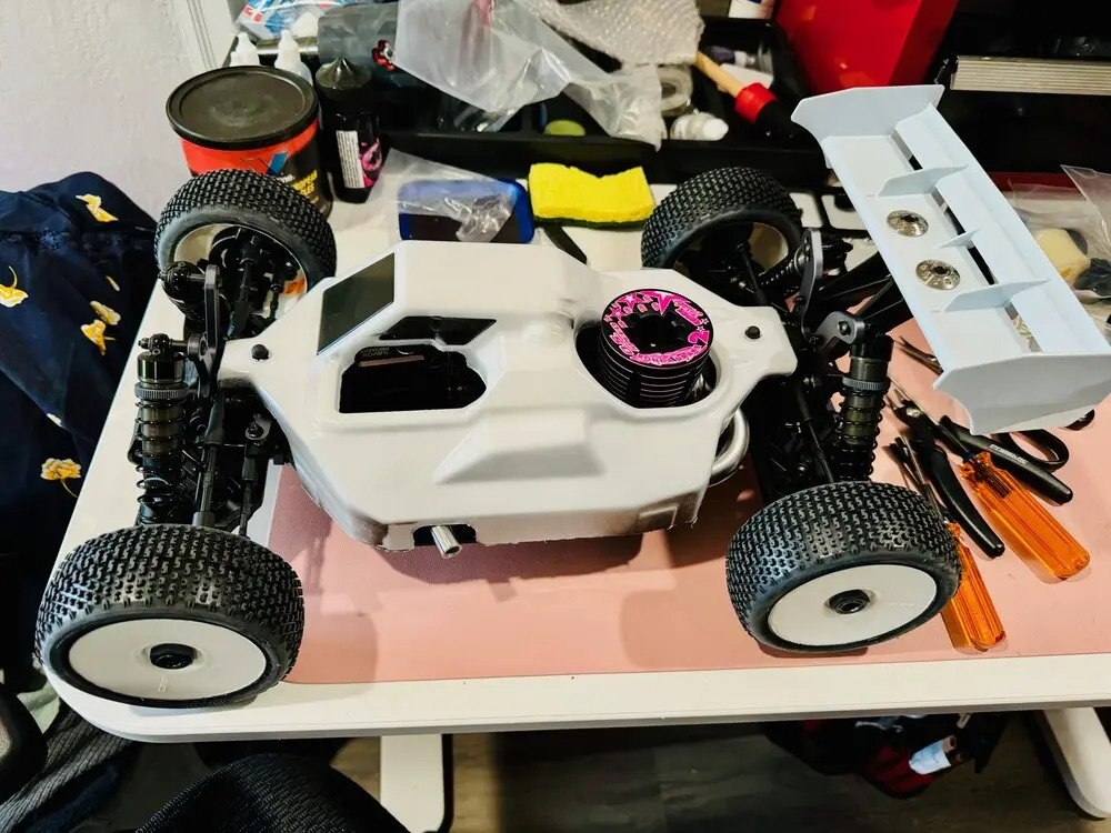

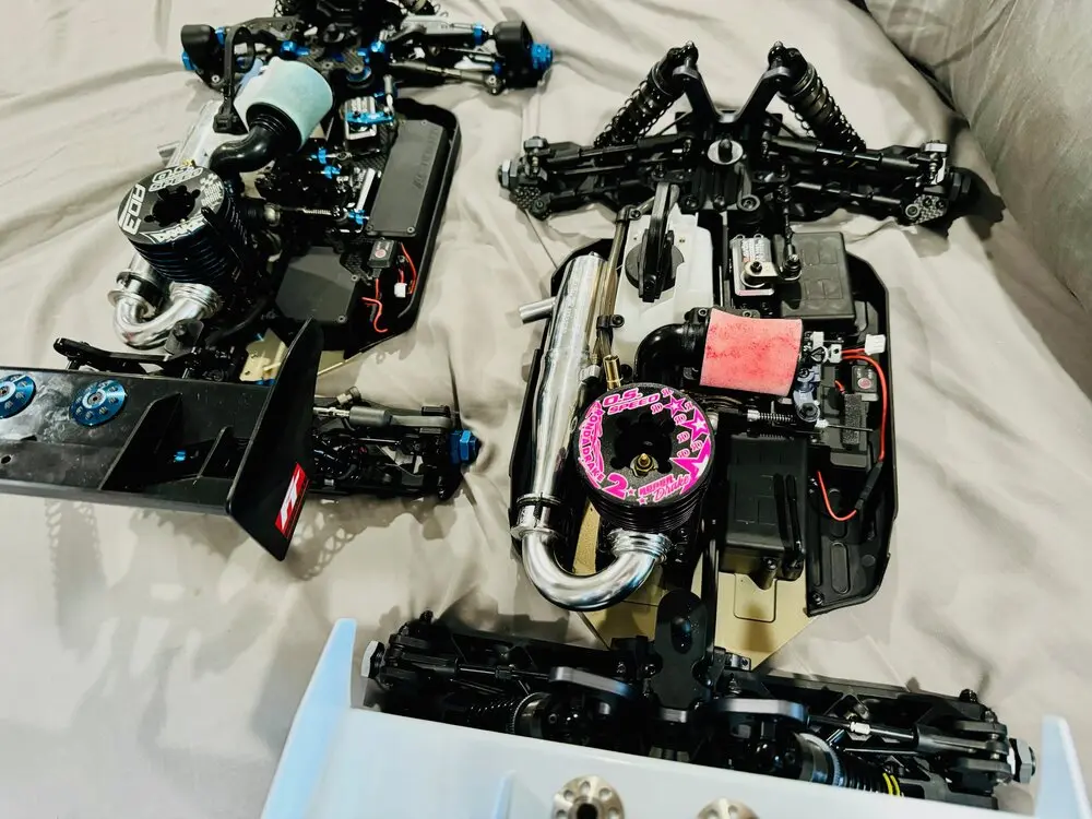

Thanks Ifti's as always. Took my time on this build for the first time. I've always rushed like I was racing with time when building previous kits...
I went with all stock configuration other that the throttle linkage installed on the underside of the servo arm, manual says to install on the top but throttle linkage bar was not level...
Also installed some skid plates..
More pics :)

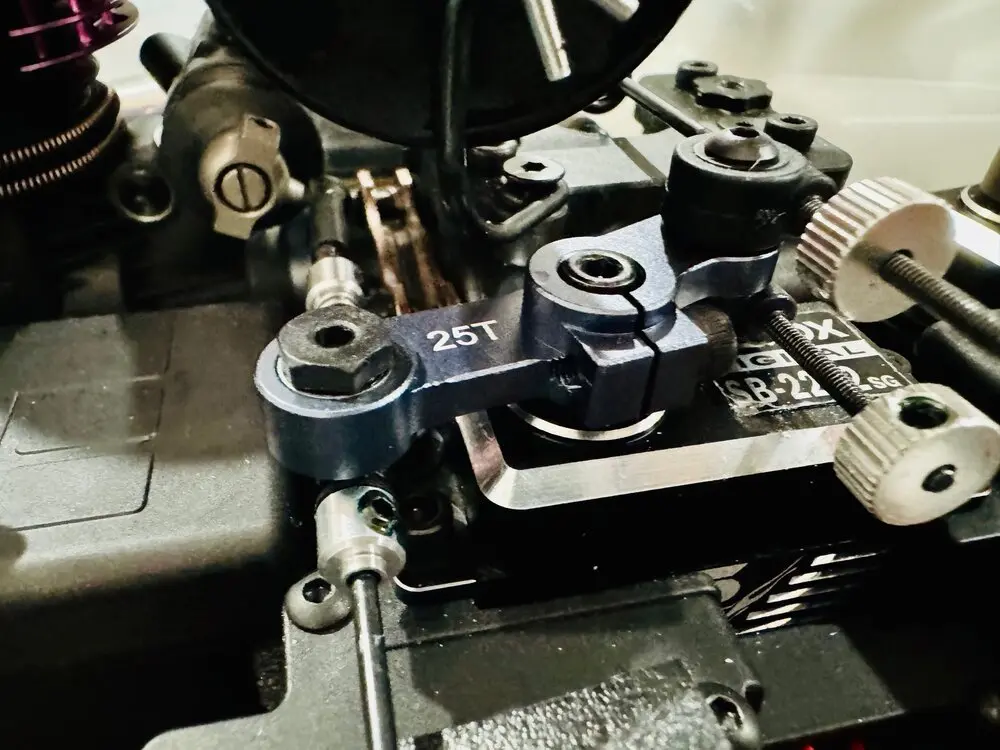

More pics :)
View attachment 10494View attachment 10495View attachment 10496View attachment 10497
Good job - looks awesome!
So I think how you have it should be fine, just know that you can also loosen the setscrew(s) on the carb and rotate it to whatever angle you prefer.
