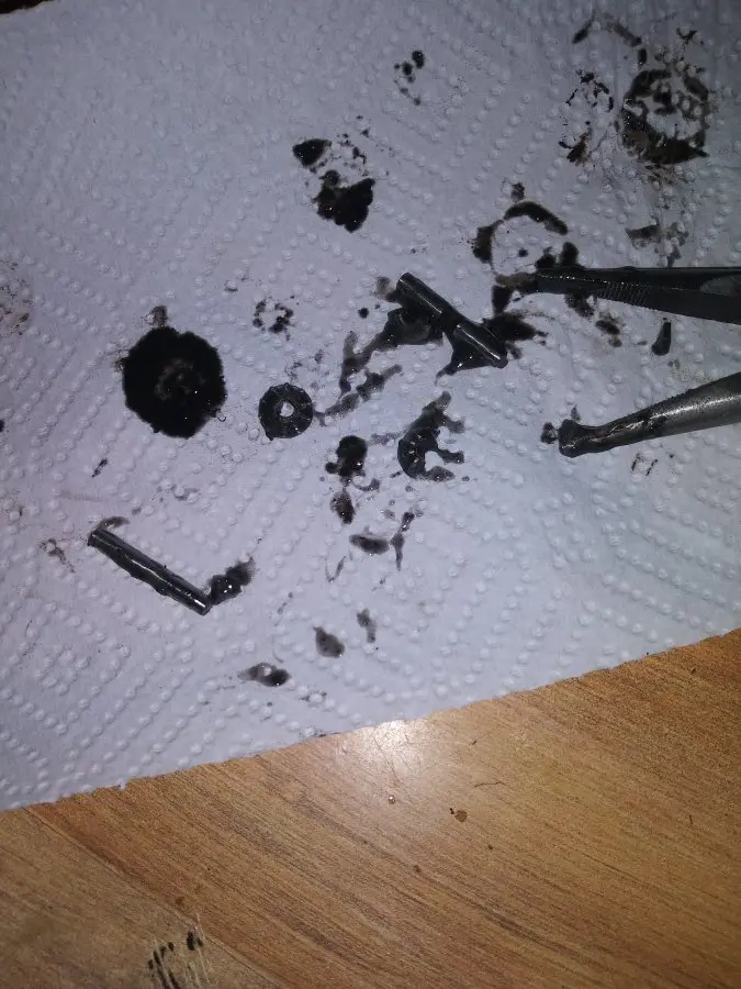

Hello fellow tekno enthusiasts im having a issue with my tekno mt 410 im hoping someone can help out with so i bought brand new mt 410 kit put it together exactly as manuel says so i go out run 1 time and my rear diff gives out take it apart and the spider gears are shattered so i rebuild them with new gears and a new cup go out run again 1 time same issue idk whats going on im not running it hard im only using 4s and a 2200kv motor and ibe built several difs in my rc lifetime so i know im doing it rite.. Ive ordered sttel diff cupps for the truck hope this helps resolve my issue but if anyone else has any ideas please lmk. Thanks

I had the same issue and changed about 10 spider gears in front and rear diffs.
The steel cups did not help.
The solution for me was:
1.Turn the diff screws firmly, i also used treadlock.
2. I put away one of two shims inside the diff. It helped the diff to rotate more freely.
And last. After spiders broke you need to ispect the holes in the diff outdrives and clean it from the parts of the broken spider gears before you assembly the diff.

A also think that it is a quality problems. Before changes i wrote earlier spider gears broke after 1-4 packs. After mods. approx. 50 packs ok and no wear. I use backflips 6s for bashing and aka gridiron for track on mt410. Spiders broke on both, no difference.
