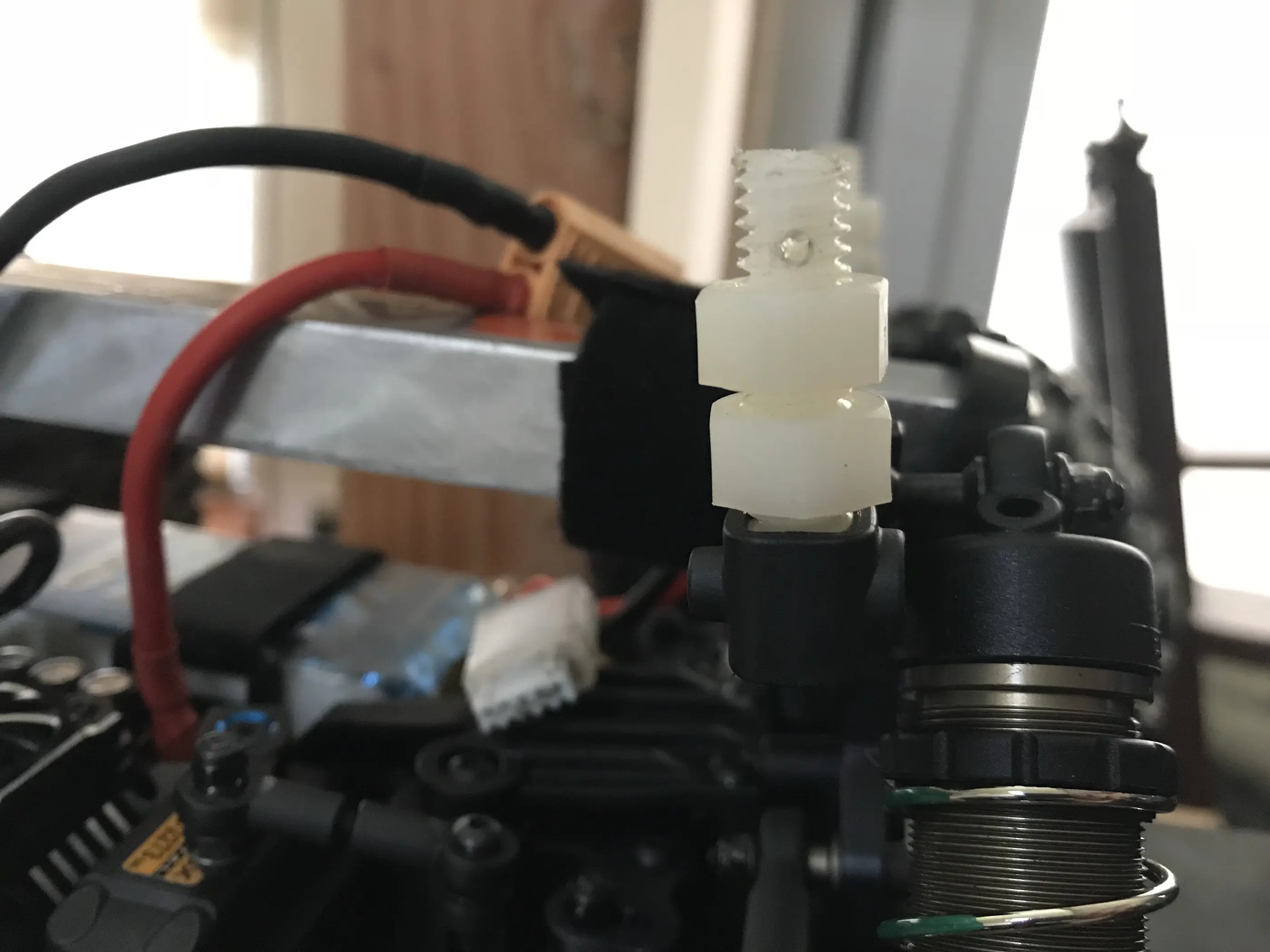

I removed the stock posts and threaded in a 5/16 nylon post cut to length to fit my truck body. They thread in snugly without need for a jam nut.
Nylon nuts can adjust height. Drilled out to accept body clips. The nylon is flexible and inexpensive.
Very nice!! Where didn you get the nylon from? Did you use a normal tap and die to get the threads or does it come threaded?
Also, did you have to make the body holes bigger?

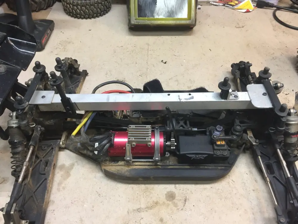

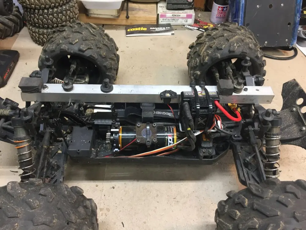

Get an extra post or two on a center brace. This will completely stop any body post issues! And bodies will last much much longer. I’m definitely not saying to go as overkill as I did , but somehow incorporate at least a 4th and 5th post more central on the truck. There’s a 100 ways it can be done and it’ll save you body and post money in the long run.
Nice! Aside from the extra post, I may just grab some aluminum stick and bend it a bit to the contour of the body. That's one thing I love about my Kraton - the center support tower.

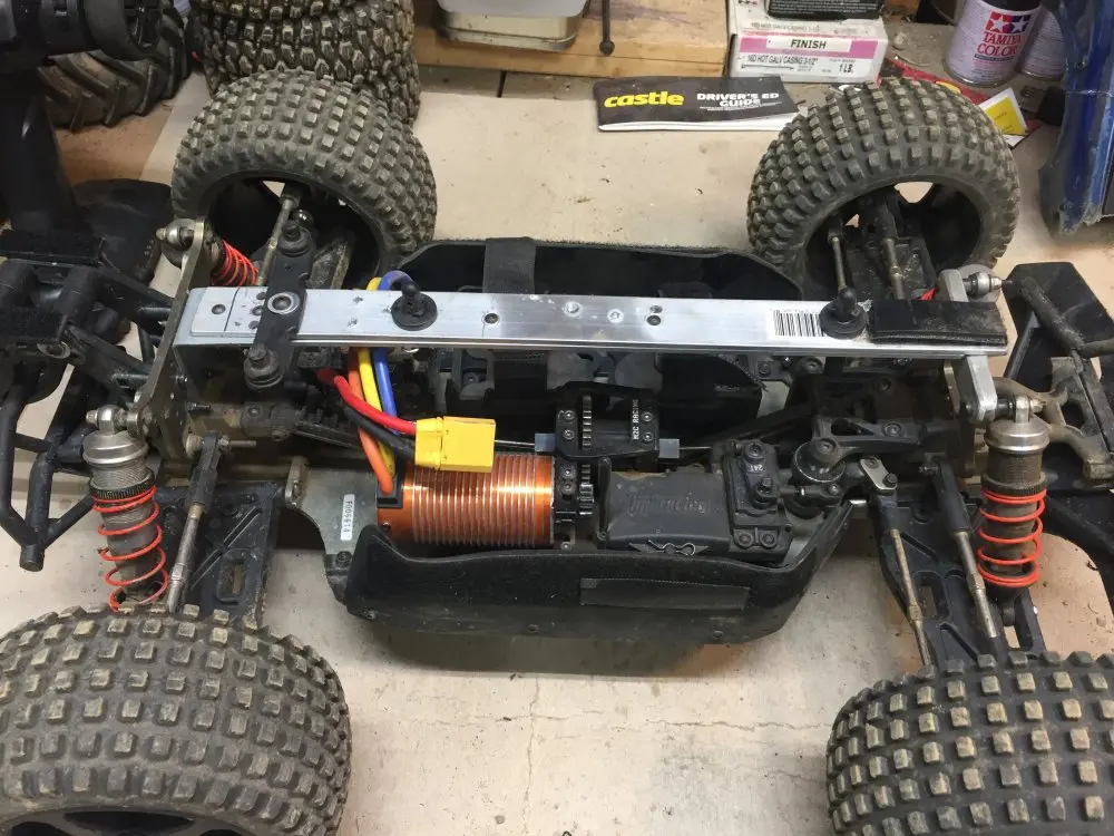

Here’s one more example on another one of my D8t monsters. These posts support a VW Bug body.
I think it’s pretty obvious that this is overkill...and not a necessity. But I have never broken a single body post and my bodies take ten times the abuse when supported this way. This is also a chassis brace, and a place to mount an esc when using oversized motors.

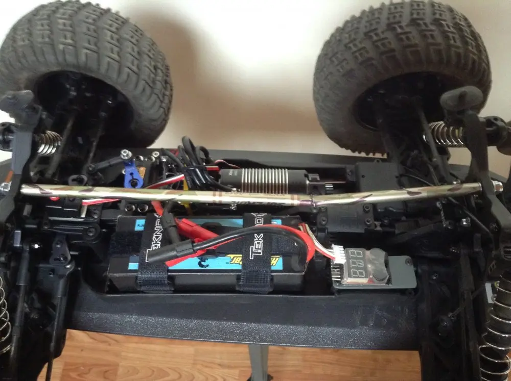

I followed the experts as I had no experience with Tekno when I built my MT410. I was told it was not needed but good insurance if things got a little crazy. To be different but still keep the concept, I used and old Aluminum Arrow shaft. It lasted 1/2 a run, bent and split right at the diff area. So, the chassis does flex as it was designed to and in turn if you don't have a brace the body posts try to push the body F/R depending on which way you land. Truggy bodies have a enlongated body hole for some flex so you don't rip the body to shreds.
Now, I am basically a noob who can do a backflip if I am lucky. I am usually not lucky so I land on its ass a lot and that's where I have ruined a body in one short season.
Tekno is like all other RC's in the body post area from what I can see. The bigger your jump and the less control you have wont matter if it says Tekno, Losi, Arrma, Traxxas etc.
