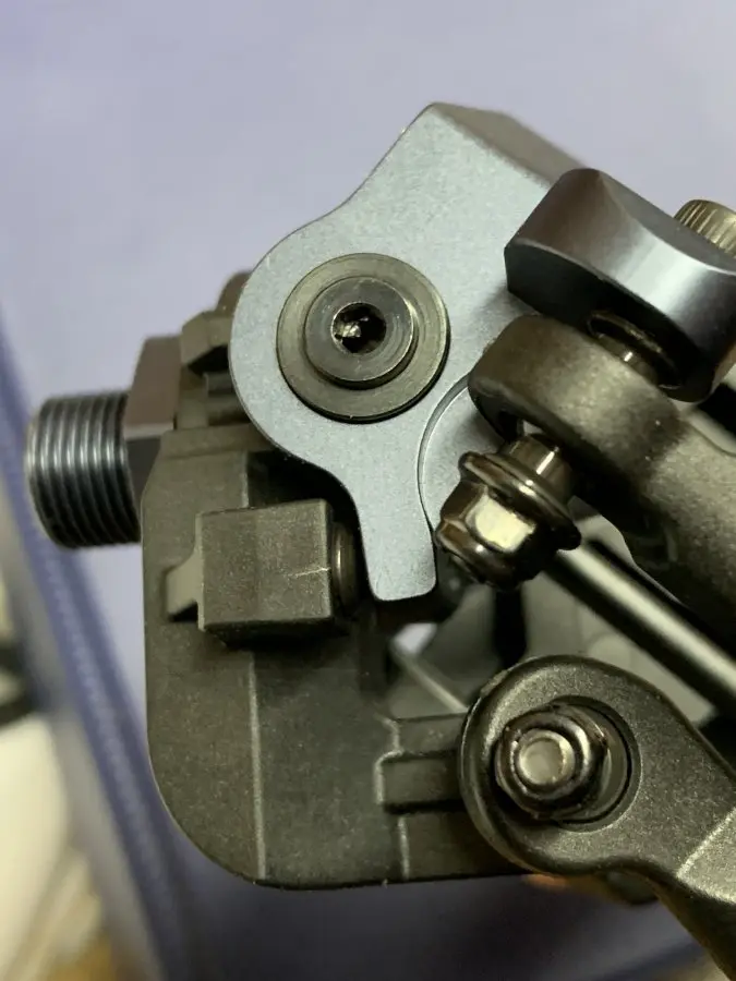

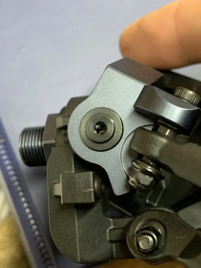

I just finished building the buggy, installed the electronics in it and started setting up EPA when came across an interesting issue. The end-point varies very significantly based on the position of the arm. I was planning on running the screw as recommended in the instructions but with no washer to maximize turning capabilities.
How did you guys set the EPA?
Here are two pics, Servo / servo horn are in the same position. First pic, arm is hanging down to maximum droop. Stop screw is far from the stop. Second pic, arm is pushed up and shock compressed. The stop screw almost touches the stop surface. Do you use this worst case position for your end point adjustment?

When setting the EPA, I find it best to do with the wheels installed and the car sitting flat on the ground/table. I make sure to go full lock all the way to each steering stop so I get max possible steering in both directions without any binding on the servo. Some folks will go 1-2 points on the radio just past where the servo starts to bind just to make sure they get the absolute max possible steering, but this can risk prematurely damaging your servo if you decide to go to that extreme.
I've also seen some folks remove the front shocks so the chassis has bottomed out, then set the EPA which will ensure that the servo can't go past the stops when landing on a jump and full lock steering.

Thanks Bill! That last part is very useful.
