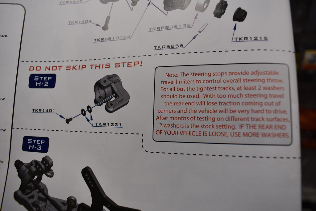

Do you have the steering stops installed?
Hi mate.
Definitely. I was pretty keen on checking those steps that suggested catastrophic failure before I plugged a battery in :)
I've put new wheels on and it doesn't do it now, along with shaving a fraction of a mm off the bell crank, which by design appears to have a cut out for the outdrive when in full lock. I actually think it was mostly the wheel out of serious balance, it's had some laps and crashes :)
It looks like the shape of the bell crank by default is enough to clear the outdrive, but as the dog bone pin is slightly extended from outdrive, it can clearly rub. Also I have experienced that dog bone come loose too (other thread), so I wonder if whilst I've always had the steering stops in place, maybe my EPA hasnt been reduced enough at some point. I run at 90% to avoid hearing the servo strain. Maybe related. Pin pushed out by rubbing on the outdrive.
