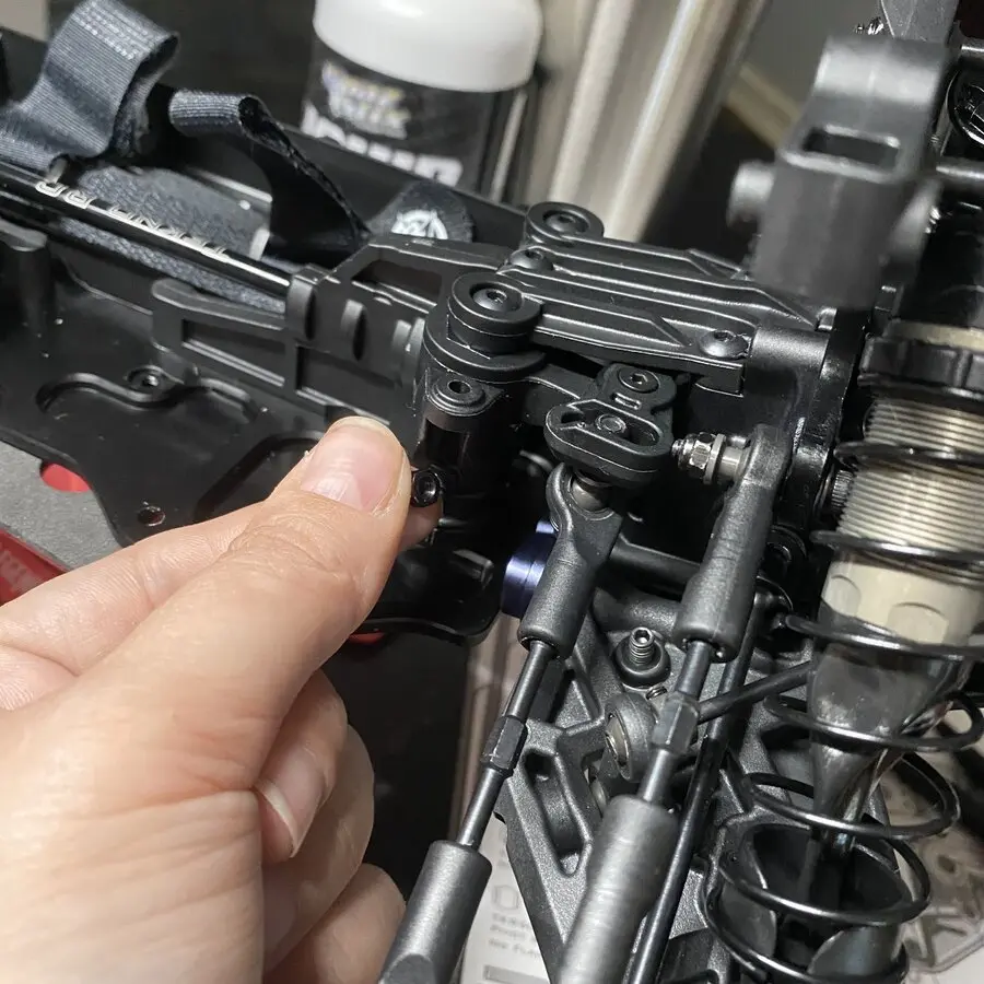

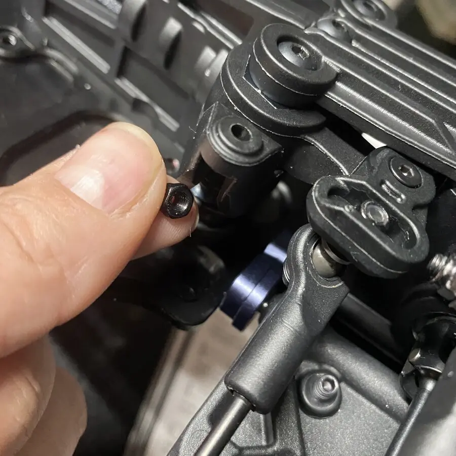

Installing the steering linkage - everything went swimmingly until it was time to attach it to the servo saver / front end assembly. The tiny little nut ... I can't get the nut driver in underneath that tiny little space. Any tips?
Here's pics of what I mean. Figured that would help. :)
I used some needle nose pliers to hold the nut from the very tip of the pliers - so that you are only just gripping it.
This gives enough space to line up the nut properly and insert a little, and once its in a little amount you can release the pliers and push in the rest of the way.
The hardest part is just getting it lined up in the gap properly - its a tight fit!
Note two flat sides of the nut line up with the sides of the plastic mount - it needs to go in perfectly aligned with the sides.
Use the screw to pull the nut up into the saver. Once the nut is in it doesn't really fall out.
