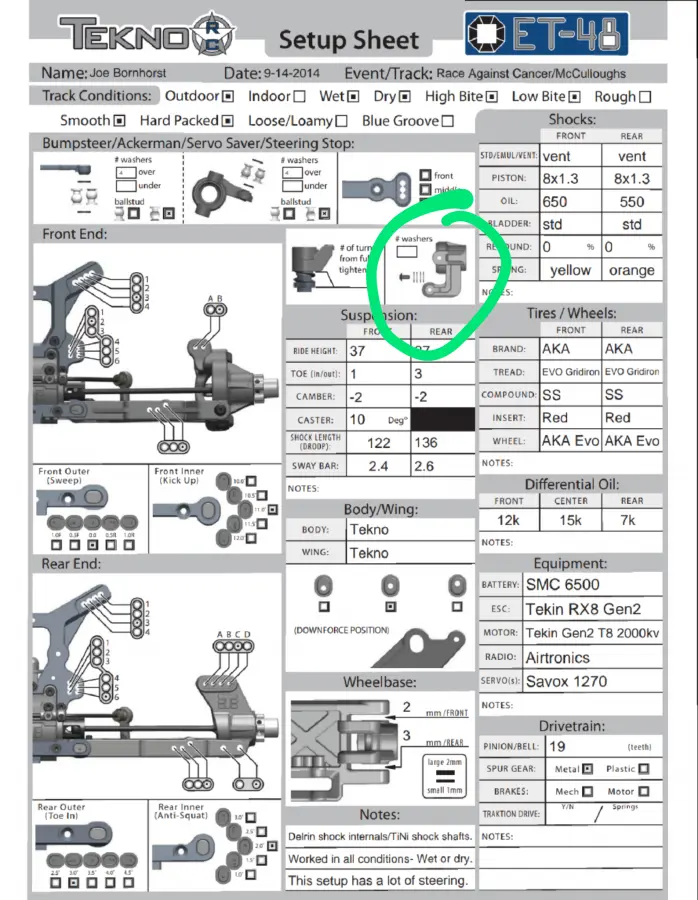

This is very hard to type-explain so I made a Video.
The turnbuckle end is contacting one of the steering parts which results in my truck not turning as sharp as it could in one direction. What's the ideal fix for this? As seen in the video, I pointed out a couple of possible solutions. I'm wondering what I should do here. What's the consequence of me adjusting that screw position I pointed out towards the end of the video?
The truck turns fine in general, but I noticed this problem because at my local track there's one very sharp right turn that I'm awkwardly taking a little wider than the other Truggies.
Edit: Looks like that screw hole is the Ackermann adjustment. Has anyone else seen these two parts rubbing together when on the rearmost screw hole?
