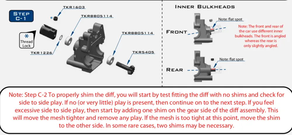

Something tells me that the previous suggestions of the couple being loose is probably the issue. When you snugged up the grub screw on the coupler did you make sure that you had it positioned to line up with the flat spot on the diff pinion?
Yes it turned out to be simple, just the coupler somehow came off the indrive on the front diff. There's a spot of blue on the indrive where the screw touched but somehow I must have messed it up. Fortunately no damage, I'll be back up in no time. Thanks everyone for weighing in!
