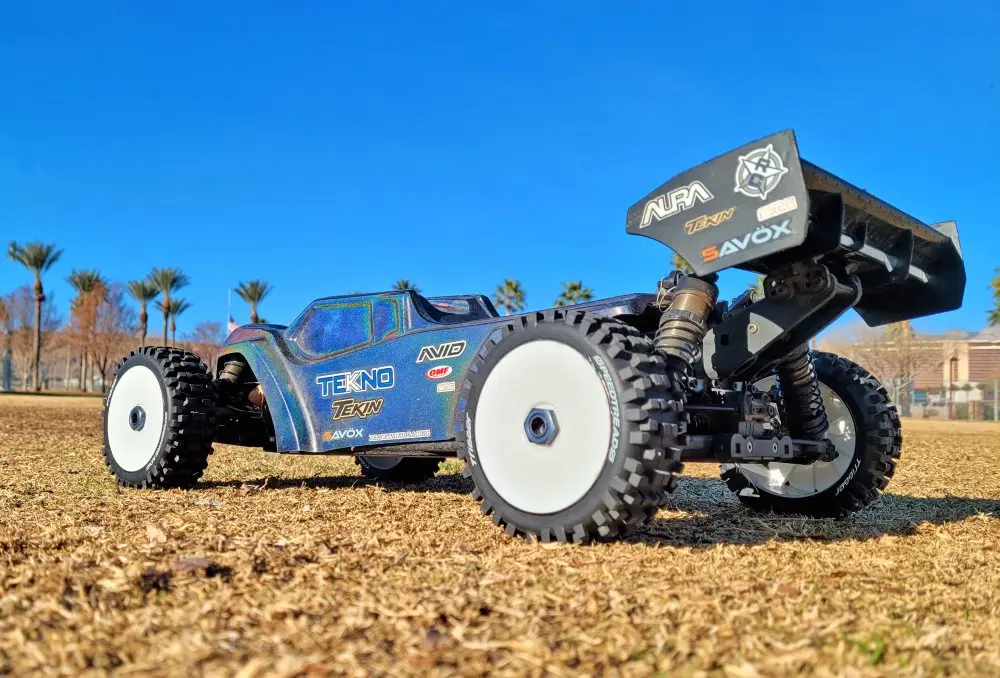

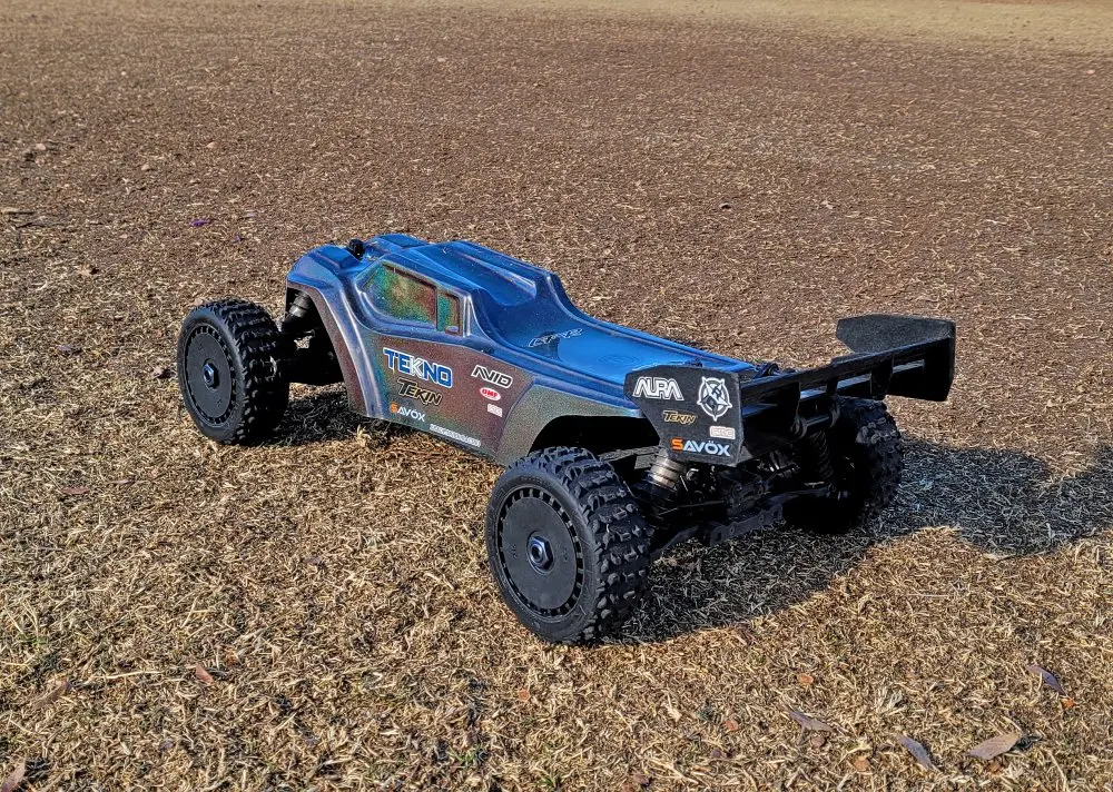

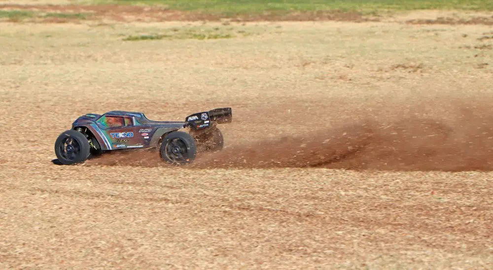

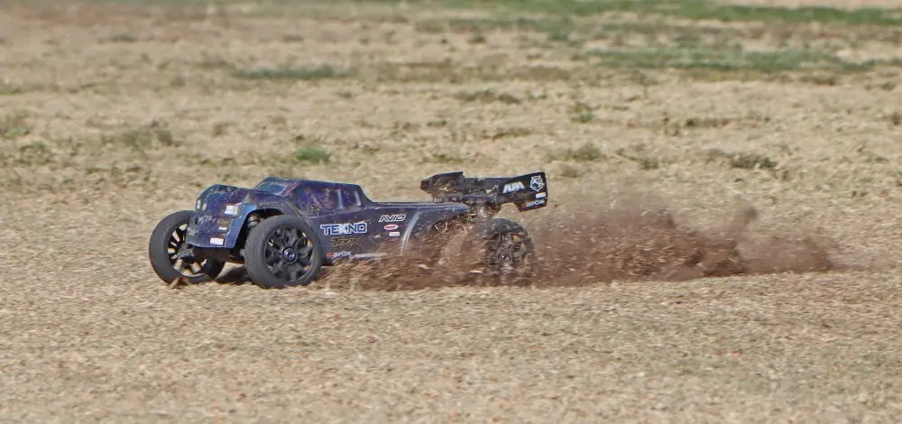

Found the sweet spot for this build finally; grass racer. An absolute pleasure to dive on this surface. Nimble, precise, and surprisingly fast.
I'm so tempted to try a 4s battery in this setup ( Tekin 3500 Kv Pro 4 HD / RX-8 ), but I'm almost certain I will ruin the electronics. So 3s it is

dident know there was any grass out there in the desert.
glad to see you got her dialed in
Please tell me that’s a tamiya ps53 paint job. It looks great
Grass is a luxury in this area, and when the watering schedule changes for the fields, most of them die off into this excellent loose surface. The landscaping crew at this soccer park are fascinated by the RC cars, and they mow this one field super short for us.
The pain is Spaz Stix # 05809 with a Spaz Stix 15709 behind it. I'm no painter, so rattle cans it is for me. I don't have the patience for the painting detail work.
Super pleased with this machine. Thanks!

Thanks for the good words. As far as the power, I felt it was surprisingly good on our track. I ran with a 14 tooth and 15 tooth pinion gear, and it did great. I wanted to stay with a 3s system for weight, and that motor provided plenty of speed and power.
I had toyed with the idea of a 4s system, but for my needs it just wasn't warranted. Interestingly that I had a love / hate relationship with the Tekno as a rock racer. I never found a body mounting setup I liked, and I was frustrated with how much the small rocks and pebbled caused havoc inside the chassis.
I switched to the Leadfinger body and then made some rock guards to protect the front left and right corners of the chassis, blocking all the debris kicked up from the front tires, and this did help, but about every track day I ruined a spur gear from rocks.
Later on we switched tracks to our new desert track, and for some reason this problem mostly went away. Maybe fewer loose pebbles or something; I'm not sure. It's a brutal track:
http://www.mojavevalleyrcadventures.com/desert-racetrack.html
I never had any traction roll issues with the weight of the Nomad body, but I really like the feel with the Leadfinger body.
As for the layout, the Tekno feels superb as I have it. Crazy nimble and precise; it's so easy to drive and weirdly finds it's own line. Of course I can flip it over if I snap corners too tight in grass, but that's just poor driving skills there on my part.
Right now I'm running a 17 tooth pinion, and I will try 18 through 22 tooth at the field later this week. I have plenty of bottom-end power on this surface, so I want to see how it feels at greater speed. Chances are I will still end up running 17 to 18 tooth as my final choice. Its the only vehicle in the fleet that I just run for pleasure and not looking to further upgrade.

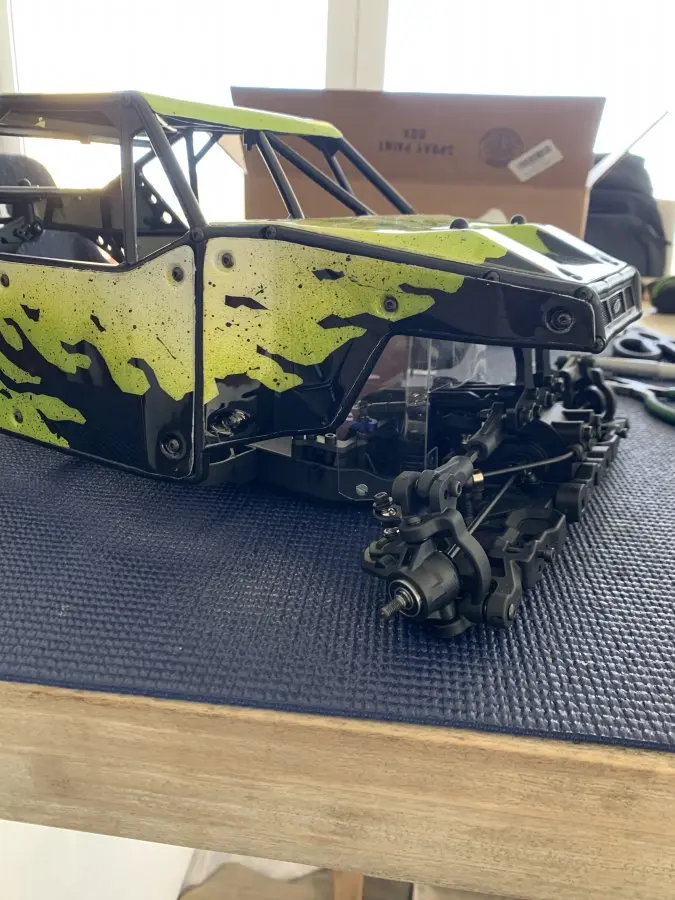

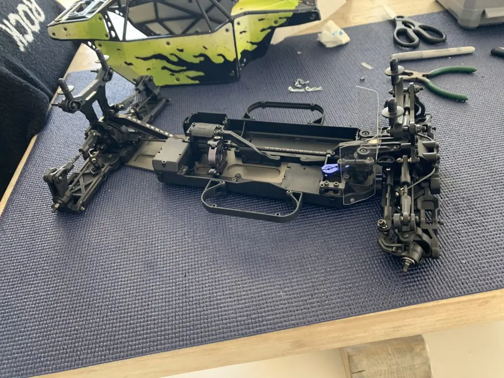

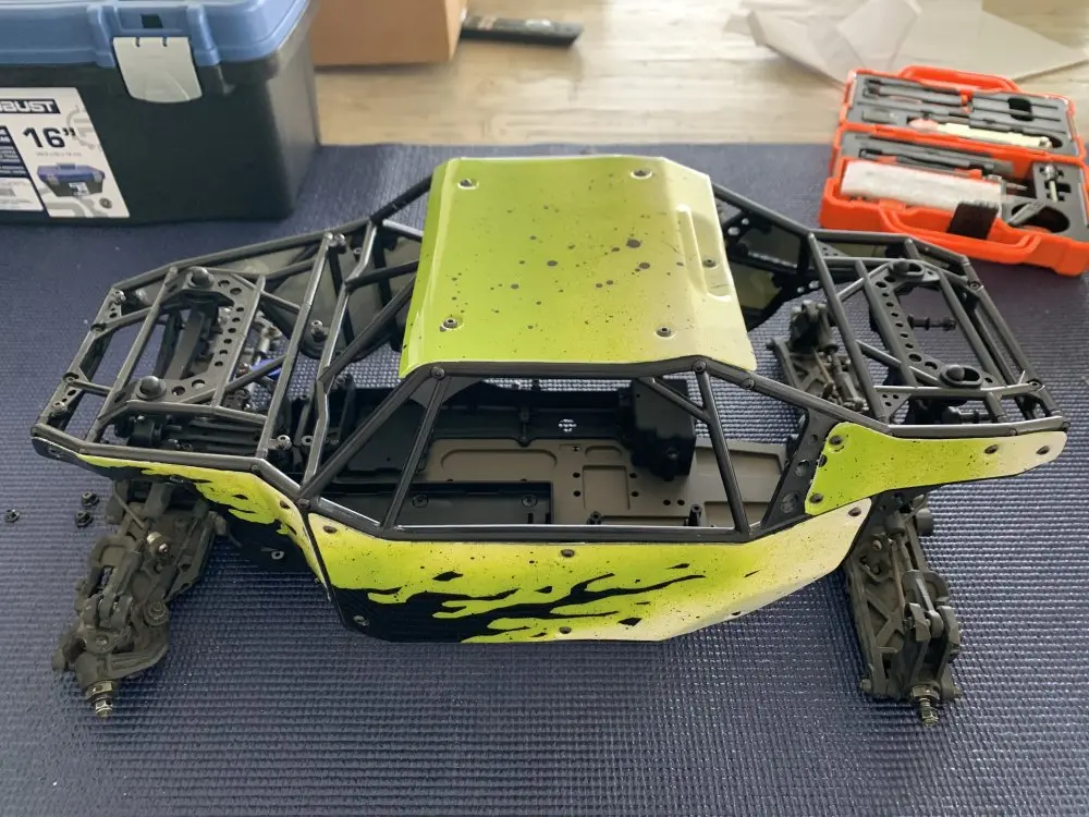

I can see now that I’ve been able to mock up the body mount there’s a lot of open space for rocks and debris to get in easily, interested to know how you solved your front mudguards, I have already cut and bent a piece of 1/32 lexan for that purpose, it fits well but still need to figure out mounting and opening for the servo arm.
With regards to mounting the nomad cage, I believe I came up with a quite satisfying solution; I inverted a pair of shock standoffs to hold the nomad body mount on the front shock tower and they are spaced just right. On the back shock tower you fix the mount and shock stand offs as you normally would. You end up having 4 shock standoffs in the front shock tower. The two facing front for the shocks, and two facing back for the body mount. Maybe you tried it but didn’t work out for you. I think it is an aceptable solution and you can invert the setup if you want the cage moved forward. Attaching a pic when I mocked up the cage mounting, first thing I did before starting the rebuild.

That looks really good. You came up with a better method than I was using. I'm torn in that I think a tighter fitting body is the way to go, but I love the looks of the Nomad body.

I will post up some photos later today of my guards and the cuts I made for the steering linkages. Works pretty well. I also run velcro on the sides of the body and chassis to seal off the sides.

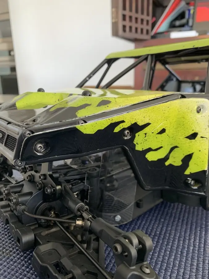

Got some time today working on the mud guard and this is how it turned out. Surprisingly it was easier to do than I expected. Been thinking of doing this piece since I started the et so maybe thats why. Did it in one try no template.
The steering linkages move totally free.
Im thinking to do the piece again though, making it run all the way back and bent again following the nerf bar till it hits the cage. Since I have already done it I might as well do it right and make sure I block all the debris the front wheels might kick up.
Curious to see how others solved the issue.

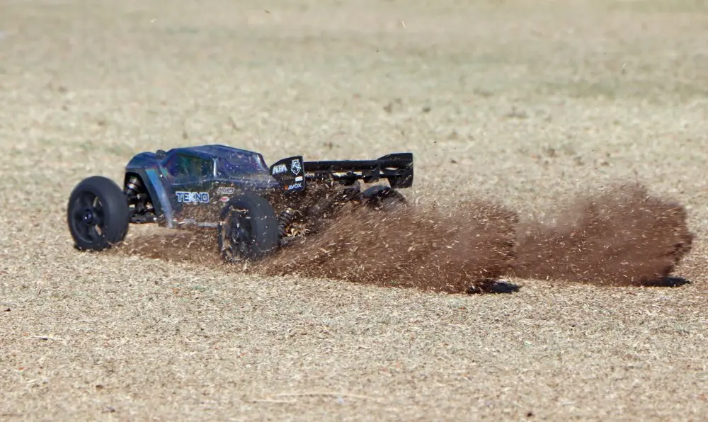

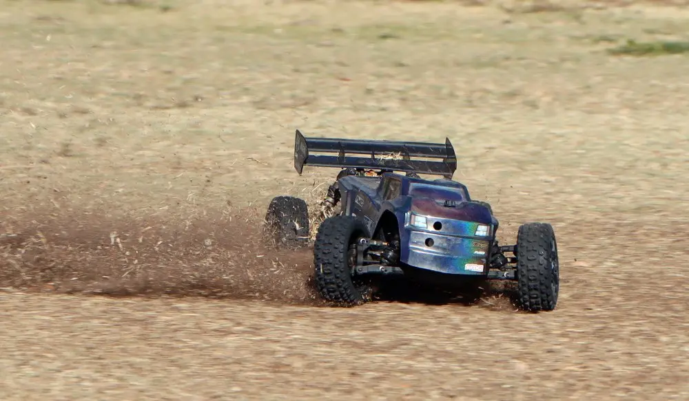

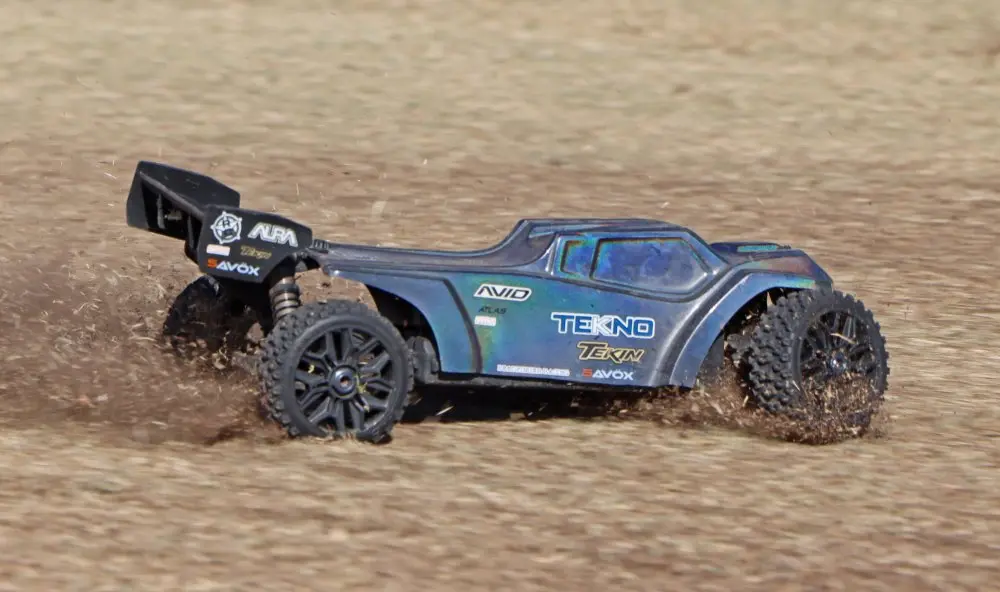

Cooler weather has arrived! Out on the fields this morning, and while a bit breezy, the temps were low 50's..! So much better than being in the low 90's in the morning some months back. We also got our first measurable rain in 240 days! Just a sprinkle, but it counts.
Been working with the DT-48 on the grass, tuning and testing. Here is the setup from today:
Tekin Pro 4 HD 3500 KV
20 tooth pinion
RX-8 ESC
SMC 3s V2 graphine battery.
Holy cow it flies..! Took the GoPro for some video, but I forgot to charge it, so just a still photo from the day before testing the 18 tooth pinion.
Motor temps hit 160 with the 20 tooth, running full-speed passes diagonal on the soccer field. It's amazing how fast it covers the distance. I'm gonna need to get a speed tracker to see what it's running.
It handles superbly, and I'm glad I finally found it's place in the bunch.
