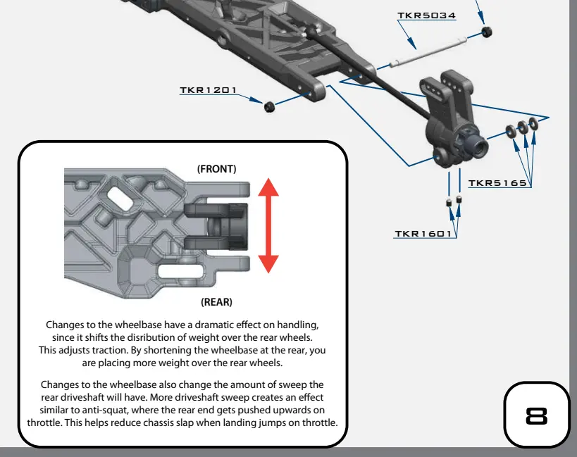

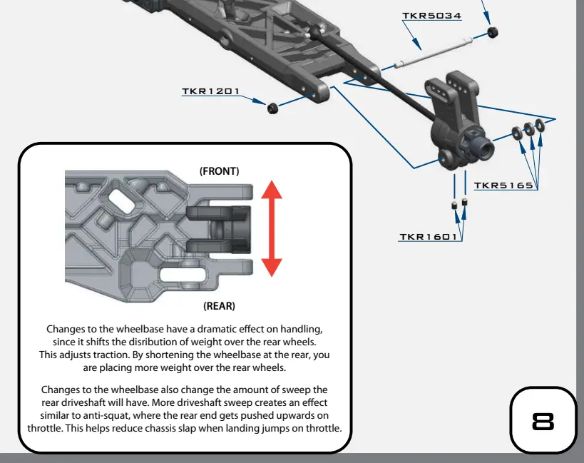

You could move TKR5165 to the opposite direction to make it a bit less wild but obviously it won't be the same as changing to a longer chassis.

View attachment 8397You could move TKR5165 to the opposite direction to make it a bit less wild but obviously it won't be the same as changing to a longer chassis.

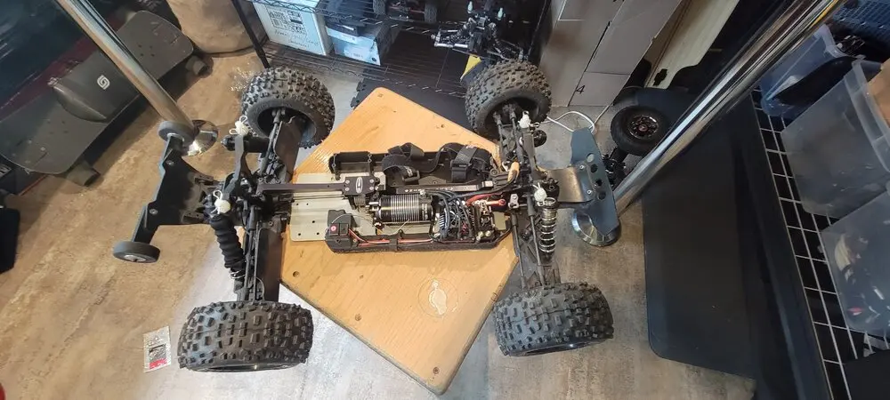

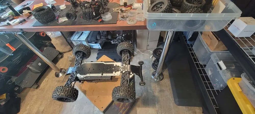

I'm a fan of the m2c game changer. you can still flip but you better set up appropriate hang time to make the revolutions.
