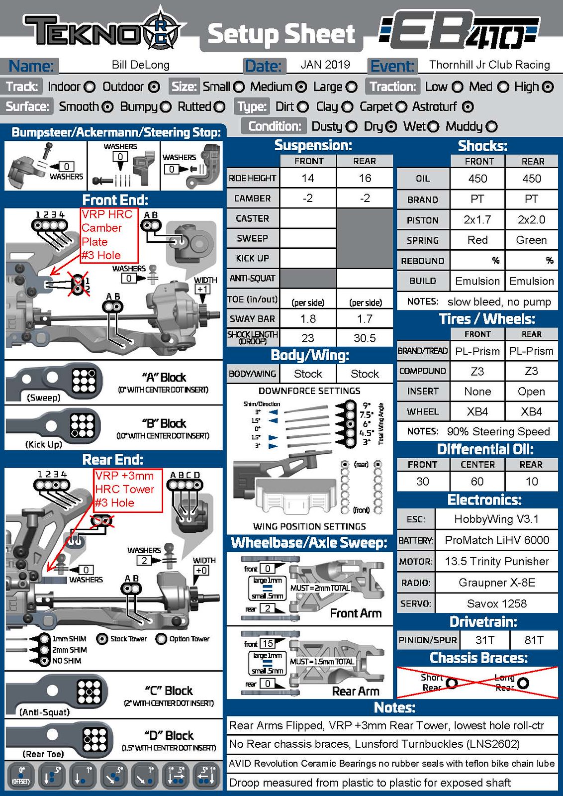

You say you don't have extra oils, so I assume you built it with the stock setup? Was there anything wrong with the way it handled, before you noticed all of your shock oil gone? If not then stick with the box setup up and just get more of the oils you started with. If I didn't want to have a bunch of different oils to test and try then that's is what I would do.
It's generally a good habit to rebuild your car after every 20-25 battery pack cycles. A typical rebuild session should take about an hour or two, and you want to remove every bearing, clean or replace any crunchy ones. Then empty your diffs/shocks and apply fresh grease on all the rubber seals, replace any torn/cracked seals to prevent leaks. Be sure to use a waterproof grease to prevent leaks on the seals, I use Green Grease brand myself packed into a 10cc syringe.
If you want to use the same shock fluid for both the front/rear, then I would recommend boring out the pistons on the rear to 2.0mm holes.
Thanks Bill, I'll get some 450 oil and see how the pistons are setup. I figure almost any oil will be better than the ~1/2 full to empty that I had and the now way-too-stiff that I currently have.
