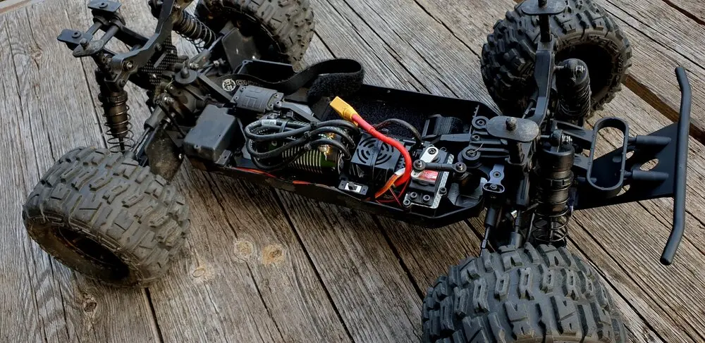

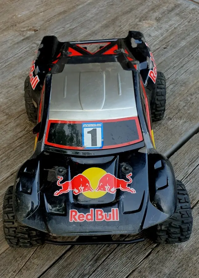

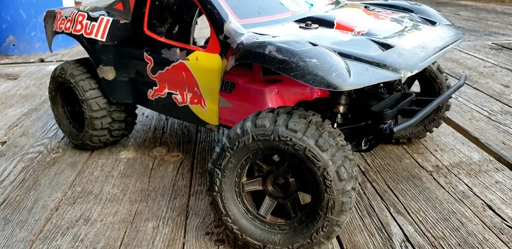

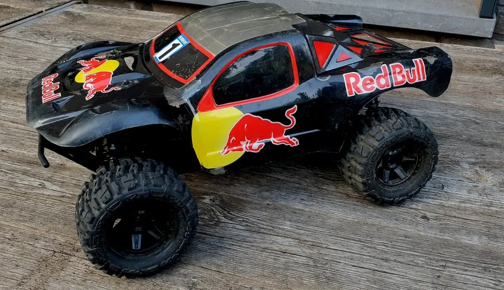

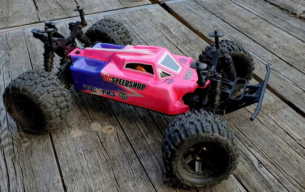

So, here is what I've done
So far this truck is a beast, lot of "cushion" when jumping, fun to drive, slides well et I personally likes the "unique" look
I can keep the buggy body under the SCT body when it's muddy.(y)(y)
The SCT body, cut like that, has no parachute effect, on the race track, with buggy tyres, it's very efficient (against other SCT's)
The MM2 is still a beast and I can wheelie when already at medium speed... :love:

I like the buggy body hiding inside - that will help keep things clean!
Sorry for the late reply, but if you converted your .1 to this MT, you may want to buy a set of .3 axles, hexes, and wheel nuts. The .1 has smaller wheel axles, and I broke one right away when I MT'ed my SCT310. I replaced them with the larger .3 axles, and have had no more issues. Fun Truck!
