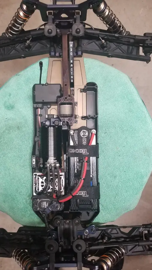

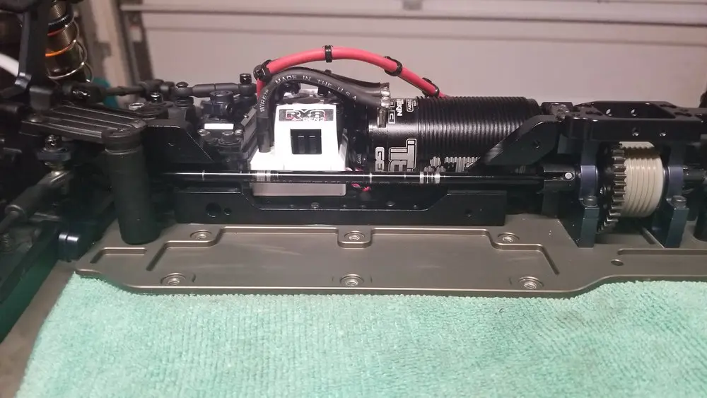

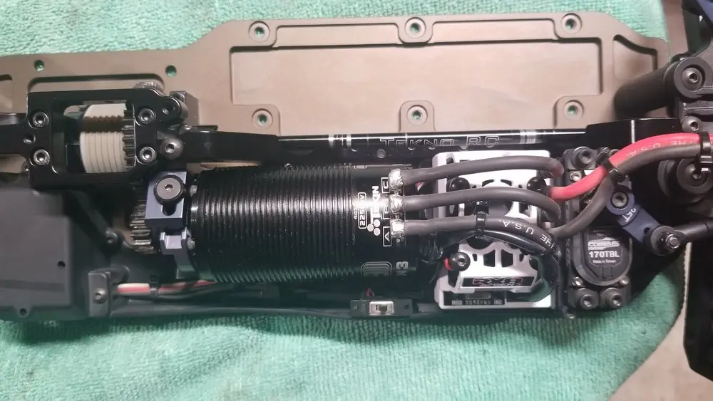

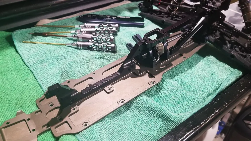

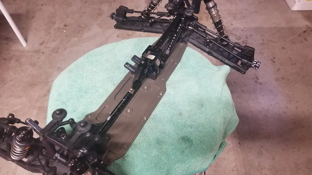

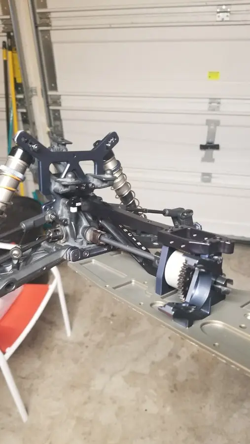

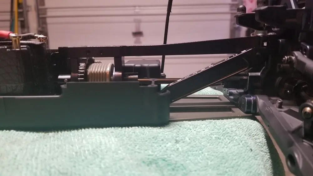

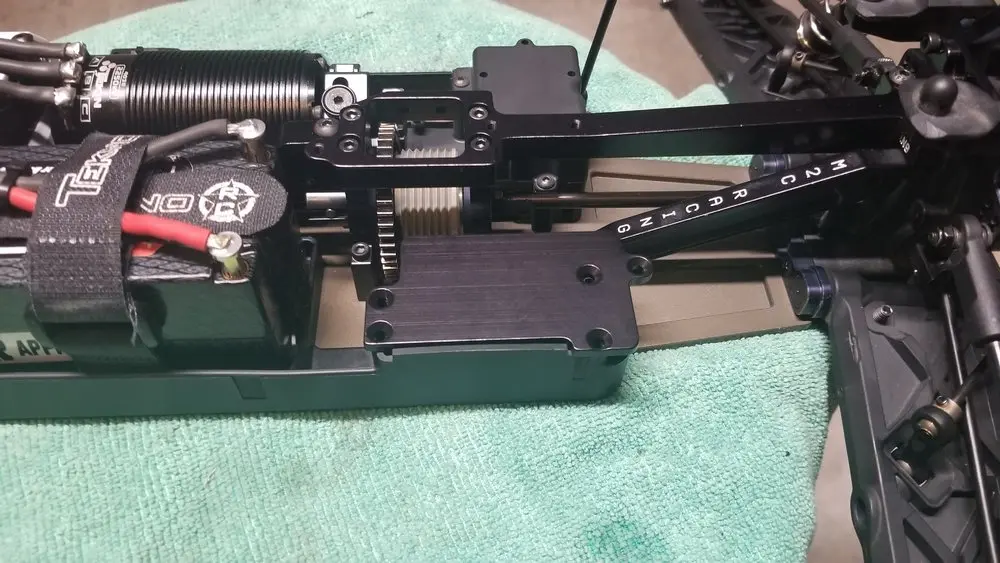

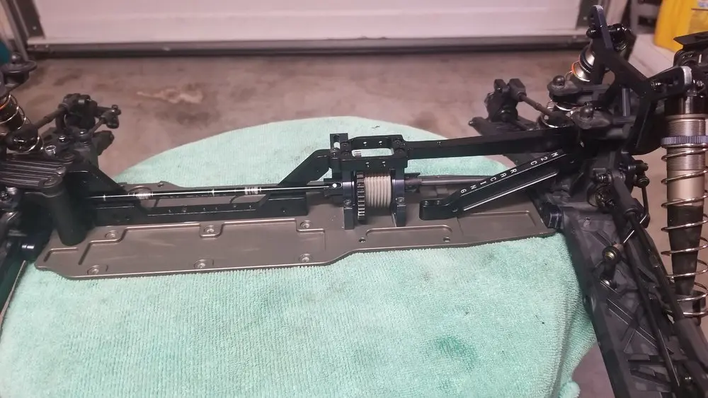

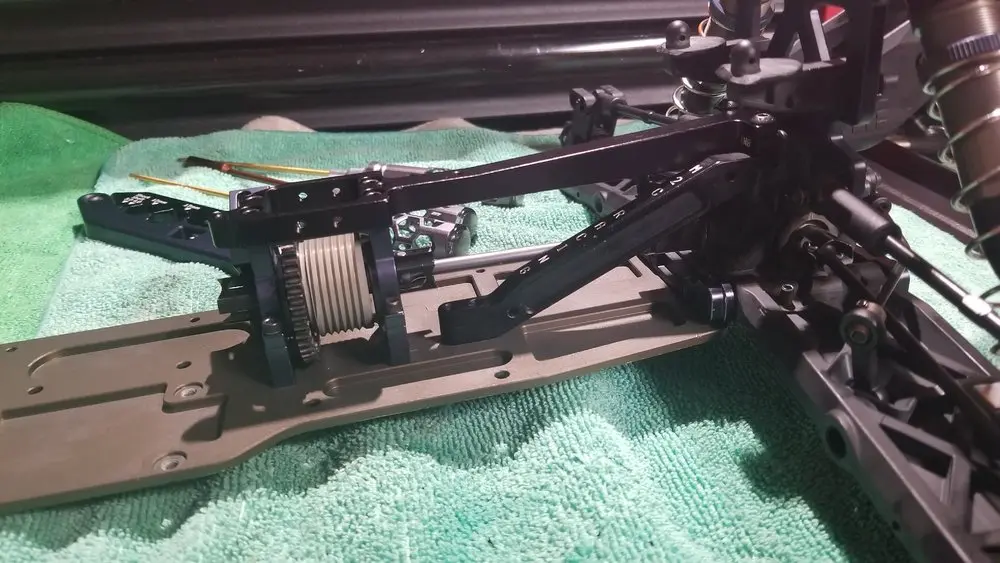

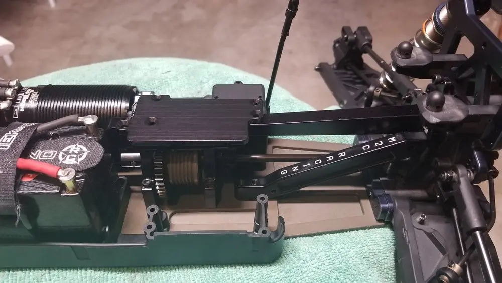

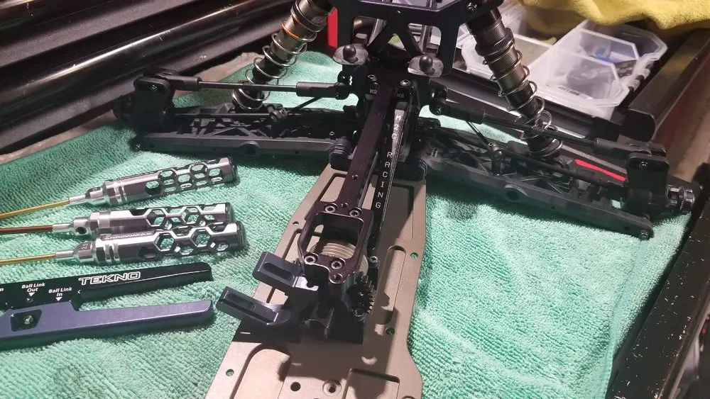

Got around to installing the new braces today as I did a tear down to clean and replace some bearings as it's been on the track for several hours since I last did it. Everything they sent me fit perfect. They did have stickers on everything saying to not tighten any screws until all the of them were started, but I could have easily with mine... Im I got a good amount of time in at the track today and I'll go again tomorrow because I'm curious how noticeable the effect on the handling will be. I still can flex the chassis between the front bulkhead and the center diff, but the back is pretty rock solid. Anyway, on to the pics...

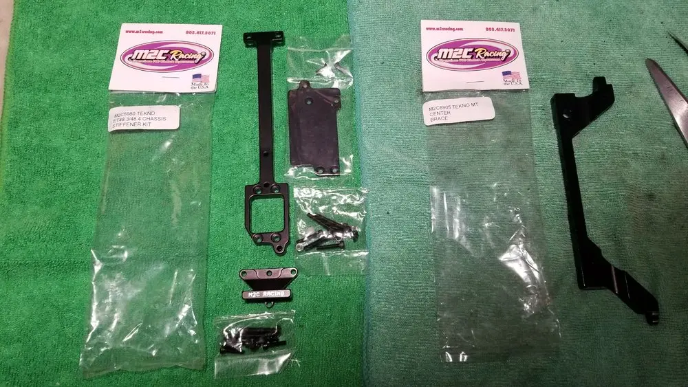

It also came with this plate that I guess allows you to mount your speed control either onto of the rear brace or on top of the stock brake servo mounts...
No instructions came with anything either...
Dang that is one incredibly clean build @Supradude26!
Thanks! Just got done doing a good cleaning, plus it's only a few weeks old... That and almost 30 years worth of building kits means I like to keep them simple and nice.
View attachment 1532View attachment 1533View attachment 1534View attachment 1535View attachment 1536View attachment 1537View attachment 1539View attachment 1540View attachment 1541View attachment 1542

Got the alloy front center plate? That might reduce flex in the front a bit...
Also wish tekno had alloy bellcranks like the competition but If there is really a benefit I'm not sure, as long as the steering posts are aluminum, which they are...
