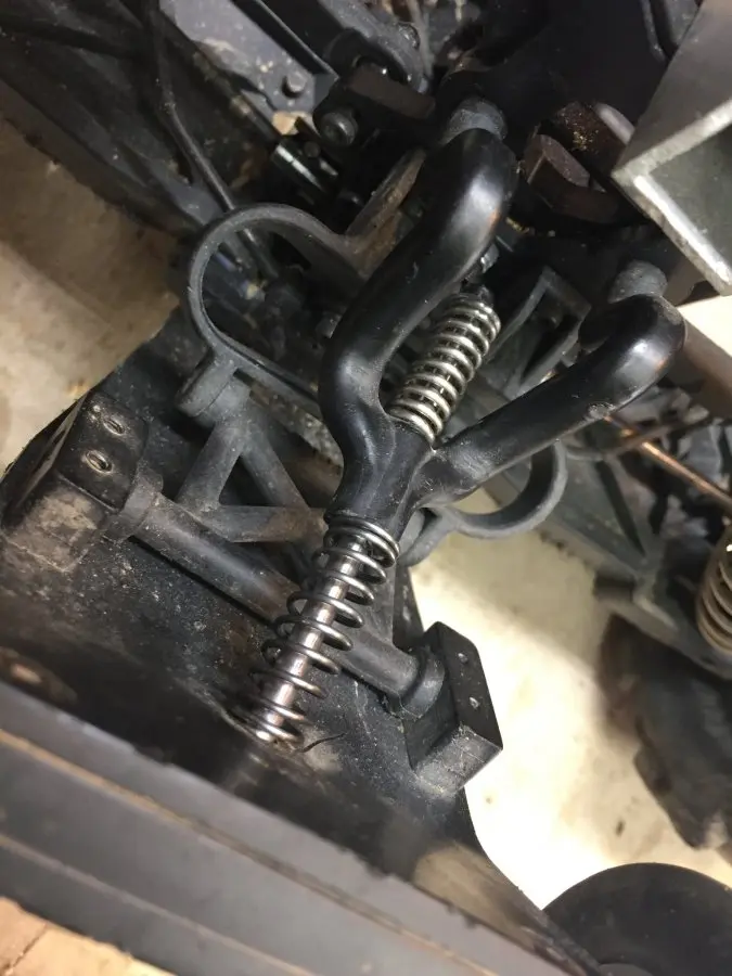

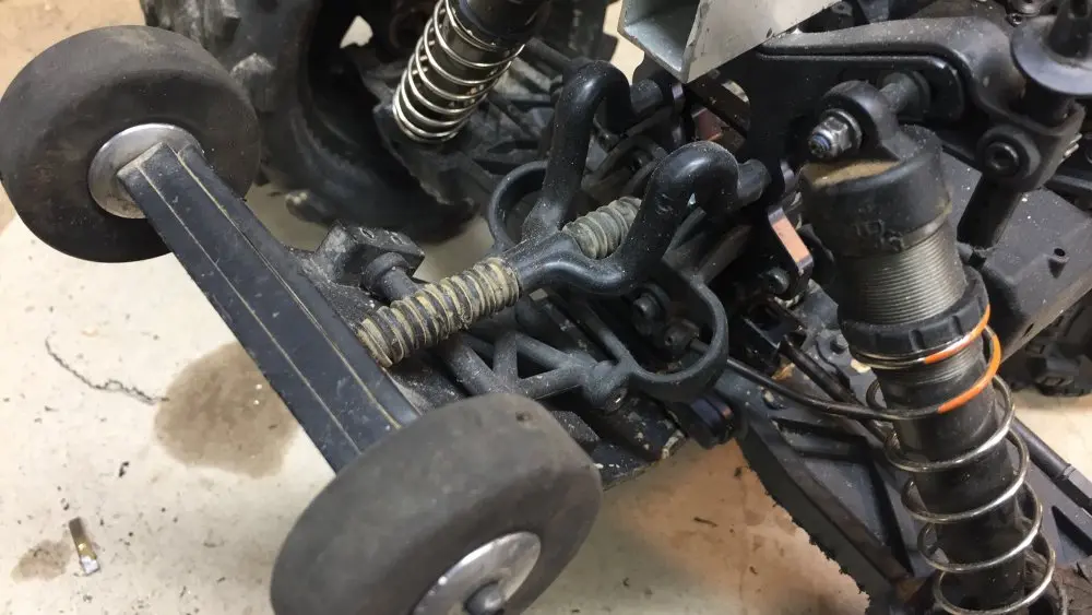

Anyone have the x brace pop down constantly. Here is our first attempt at a solution.
Wow that is much more complex than foam. How’s it holding up.
That foam should work fine. I tend to overdo things sometimes:). But it’s held up great ...it’s been on my truck for about a year. I did originally have stacked rubber grommets instead of springs...springs are a new addition.

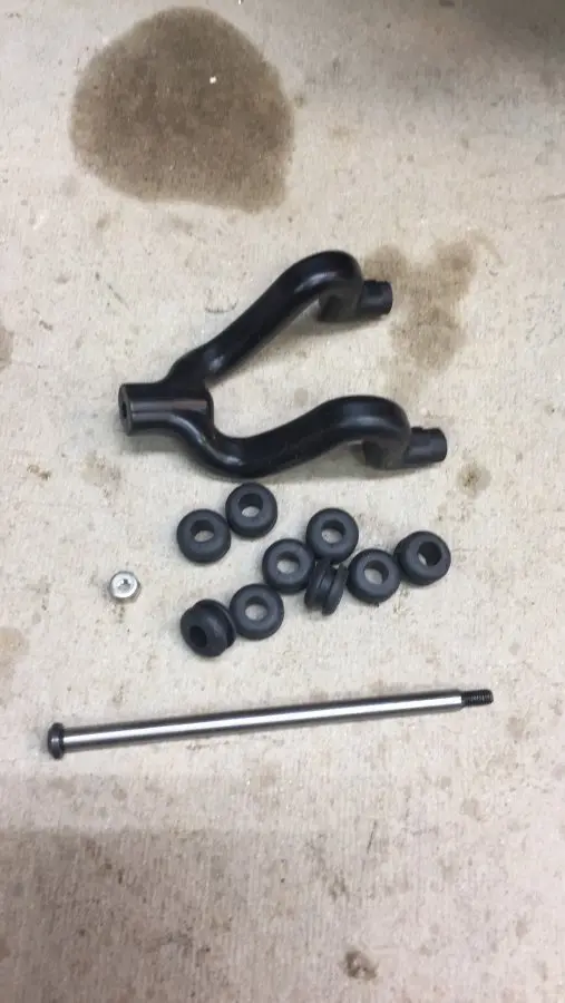

Here’s the parts I used. And what it looked like wth rubber grommets vs springs. I may go back to the grommets.
That is pretty cool chainsaw... is that a captured suspension pin from an rc?
Yup it’s a D8t hinge pin. I bet you have one on hand somewhere:)
