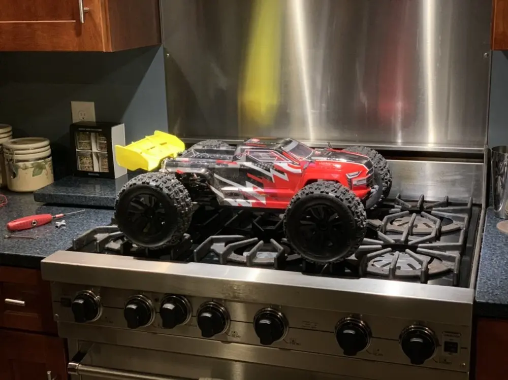

Cut an adapter plate out of 1/8th Kydex to mount to the ET48.3. Suspension tower and allow the use of Arrma rear body mounts. My old setup wasn’t going to work as the ET chassis is so much longer. This new set up definitely lowered the body. I have longer posts and may raise it a hair. Couple small tweaks are going to be made but this one will do for now...
