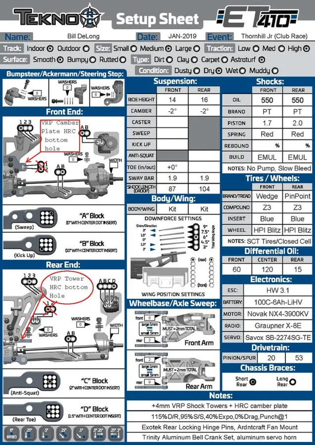

I found your carpet setup. Thanks.

Now I need to experiment with sway bars... I've read a number of setup sheets for carpet and seems like most folks are running stiff sway bars, harder springs, and thicker oil.
Matt Armeni's setup sheet is a little different. He has thinner oil, no rear swaybar, etc. So it will be very interesting to experiment with different people's setup sheets to see what works on my track.
My setup is very old and was done for turf, I no longer own the chassis anymore so can't really comment on current trends, etc just wanted to give you a ballpark starting point... if you start to traction roll or lose steering, then maybe consider putting the rear sway bat back on or go with a thinner rear sway bar. Note that I ran VRP rear tower which drastically change the roll center geometry so the rear sway bar was perfect for me.
