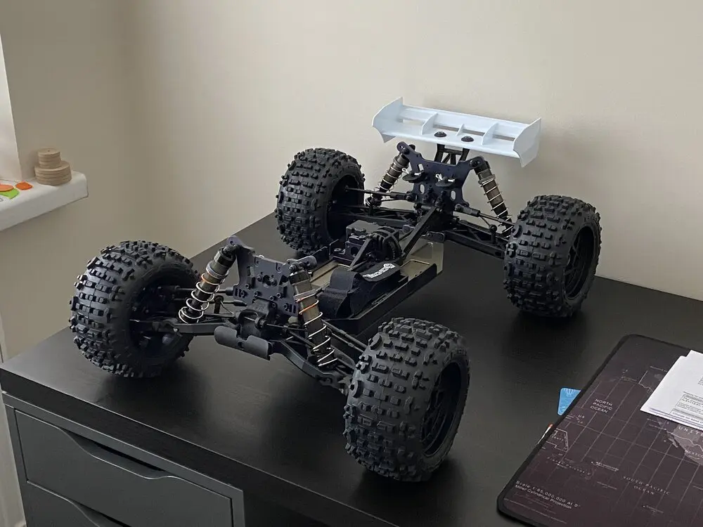

If you're after some good bashing tyres the dBoots Backflip LPs are great. Make sure you get a regulation size battery pack if you're ordering new batteries, the battery tray is limited in length.
Ifti
407
271
UK
Image with Backflip LP 4s.......
Really nice fit IMO.......
Thanks for the replies. Will exchange the current combo for 4274 and Xr8 Plus. Will also try the Backflips in addition to the Buckshots. Thanks for the pic.
