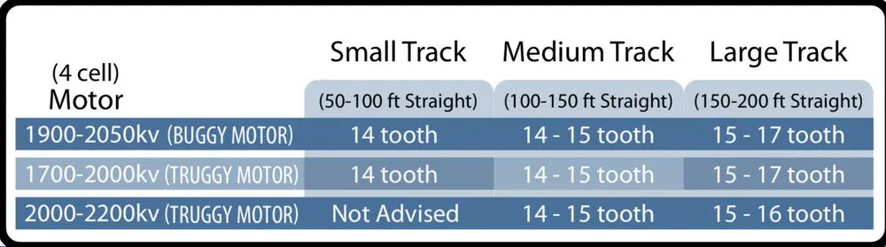

The manual for the ET48 has this handy table for pinion sizes to go with different motor Kv ratings. I am using a 2200Kv Castle motor and I am trying to decide on the pinion size.
The table says that a combination of 2200Kv motor and small track is “not advised”. Why is that?
I’m a noob who just want to do some bashing. I‘m assuming either a 14t or 15t pinion would be a good starting point?

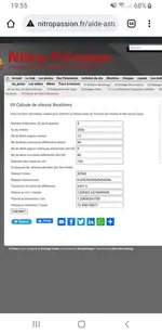

Those recommandations are for racing where you set your gearing for about 65 km/h on the track(maybe sometimes less in the US where the tracks have more jumps et more tight turns). You can gear for more speed on bash but you have to be cautious with heat(bigger tyres means higher speeds and weight, so more heat in the end). On 1/8 scale, with buggies/truggies, you can almost approximate +/-100kv=+/-1 theeth on the pinion=+/-4 to 5km/h. It changes a bit if you use bigger/smaller tyres. I personnaly use a speed calculator(the link i give is in French but you should find something similar in US English http://www.nitropassion.fr/aide-astuce/09-calcule-de-vitesse/).

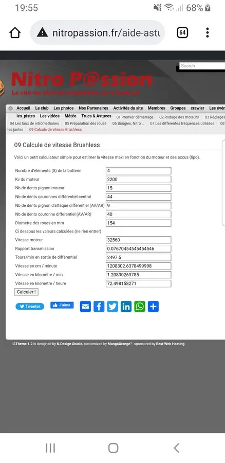

If you use Backflip 4S which are 154mm diameter you find this with a 2200kv on 4S(calculated at 3.7V(and no ballooning of the tyre so more in real) : 15t 72km/h, 16t 77km/h, 17t 82km/h.
The ET48.3 i have has the same ratio and after testings i use a 4274 2000kv with 17t(Backflip 4S as well) which gives me 75km/h. It doesn't overheat with a fan, i probably could gear up 1t or 2 (for bash only where you're not just accelerate/brake) with no issue but it's good for me like that.(i will try soon 1500kv/6S 16t-17t😁)
So i suggest you start with 15t, check the temps, and if ok gear up 1t or 2t to try and check again.

I also run a Castle 2200kv in my ET and I am happy with 15t pinion for a small track
