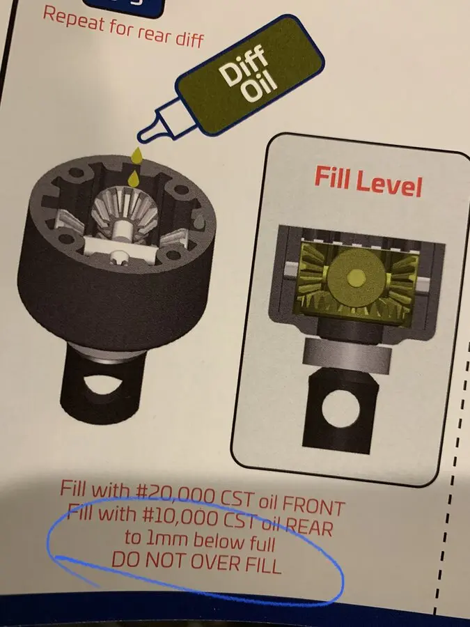

The main question is, is there supposed to be a little air left in the differential casing after assembly, or is the case supposed to be completely filled with no air left?
The manual says to fill the diffs with oil up to about 1mm from the top, but that looks to be before the top sun gear is in place, so when the top gear is in place the oil is pretty much at the very top of the case. The manual is also clear about not overfilling, which would only be possible if a little air is supposed to be left in the case. I have seen on some threads that people run their thumbs over the top gear at the end to ensure the diff isn’t overfilled, but it’s hard to see from the pictures whether at that point there is a little air gap left at the top or if the diff is filled all the way and flush to the top with the second sun gear in place. I’d appreciate it if someone could clarify this for me.

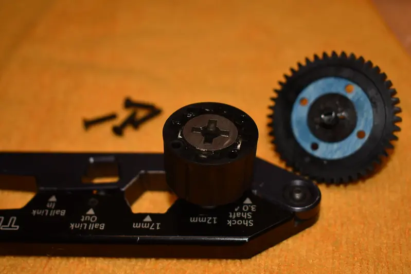

The problem with the illustration in the manual is that it doesn't show the top gear installed like this
you don't need to recess 1mm with the top gear in place, makes it so much easier and foolproof this way to get consistent rebuilds every time ;)

Definitely agree about the manual, would have made it so much clearer this way.
