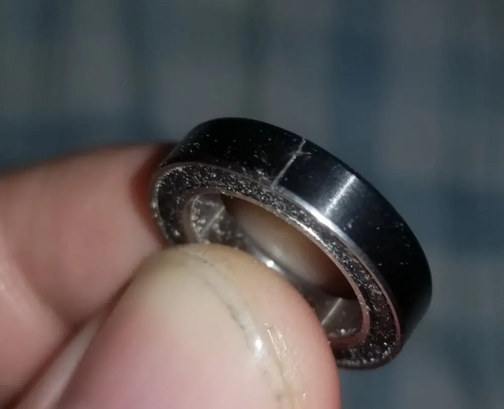

So there I am, putting my new mt410 kit together. I install the bearings in the hubs, insert the drive cups, give it a quick spin, and hear "click click click".
Huh?
Took the bearings out and saw that the outer race was broken! Brand new out of the box. So here I sit, waiting for new bearings to be shipped in because none of my lhs had this size in stock.

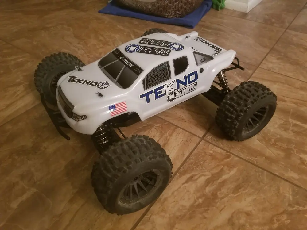

Well I think my barely used but still old hobbywing xerun esc and/or motor might have some issues. Seems that I'm only getting maybe half power. It doesn't have the same impressive performance it once had when it was in my REVO.
If I turn the expo setting to 100% and turn the punch up to 30+ I can get some decent (not the standing double back flips I used to get) off the line power, but once it starts gaining rpm the power output is very lackluster. Trying to do backflips during a jump is proving impossible. The car rotates too slowly. Doesn't seem to have the top end speed it once had either.
Can't even balloon my old tires.
My whole purpose in buying the mt410 kit was to salvage this motor and esc and now it's looking like I might have to buy a new combo anyway..
Sure looks nice though.
Is that a outcast/noto brute body? Looks good on there! That sucks about your motor combo.. have you checked all the solder joints to maybe see if there is a bad one? Just a thought ??‍♂️
It is a brute body, didn't really pay attention for what kit though. It was literally the only thing that would fit in the hobby shop. My plan to use my old Revo body didn't pan out as the rear body mount posts didn't like up with any flat part of the body.
Huh?
Took the bearings out and saw that the outer race was broken! Brand new out of the box. So here I sit, waiting for new bearings to be shipped in because none of my lhs had this size in stock. View attachment 6023
I know exactly what happened here because I did the same thing on one of my hubs when i built my MT410 last week. You used the wrong screw lol
If I remember correctly, that bag has two screw lengths that are 2mm different than each other. Let’s say that spot calls for a 3x10mm, you installed the 3x12mm and cracked the outter bearing race...Atleast that’s what happened to me
Also, what is the bearing # so I can order more?
Or better yet, send me one for telling you not to make the same mistake on the replacement bearing lol
I can't say that I didn't do that, but at the same time I don't think I installed any screws in the carrier after I put the bearing in. I am pretty sure I put the bearings in after everything was already together. The broken bearing came right out and the new one went in easy.

Well, I am about 90% confident my ESC has somehow gone bad while not being used for the last 4-5 years.
I got a new radio system and while setting up my travels and trims, I noticed my steering servo was not adjusting passed 100% like it did with my old radio. This lead me on a diagnostic roller coaster which took me from suspecting the receiver, to the transmitter, to the servo, and finally to the ESC.
I think the BEC in my ESC has gone bad and not supplying consistent voltage to the receiver, causing all of my electrical issues. I'm not sure if this is also causing my lack of power, but I guess I'll find out soon enough as I have a new ESC on order.
Which really sucks since my entire goal with this kit was to re-use my motor and ESC from me Revo. I don't know why it would have gone bad. It only had 5 or so runs on it when I packed it away.
